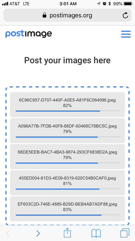

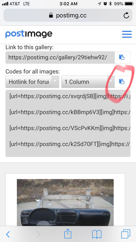

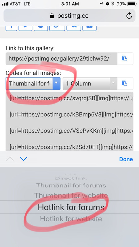

FYI, if you want to upload photos go to postimage.com and make an account. It’s free and stupid easy. You upload your photo then select how you want to copy the images to post in the forum. I think it’s Hotlink for Forum. Copy the link and paste it in your post and boom, there’s your picture(s)

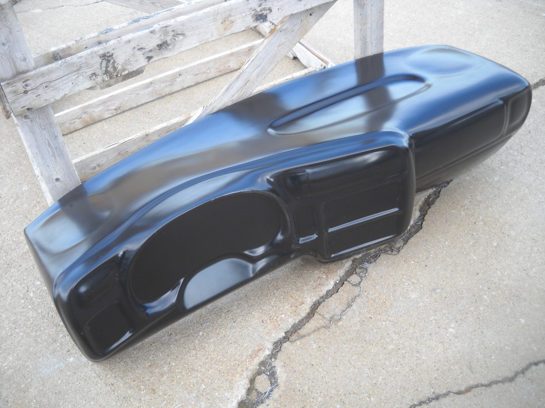

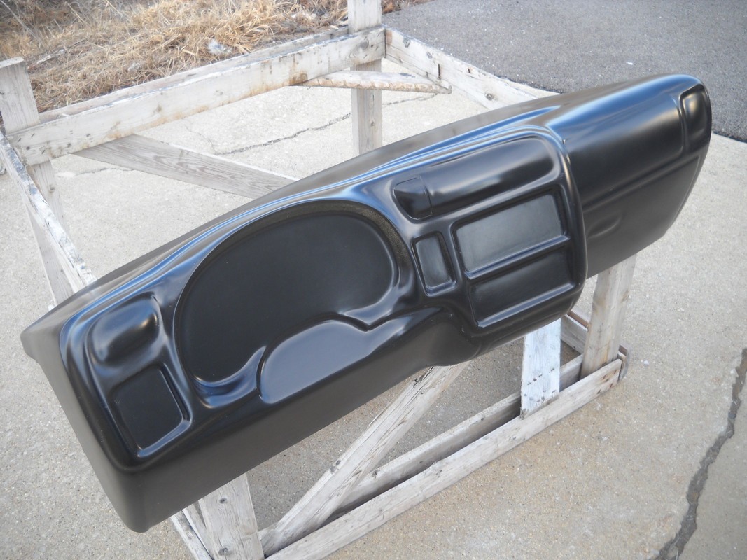

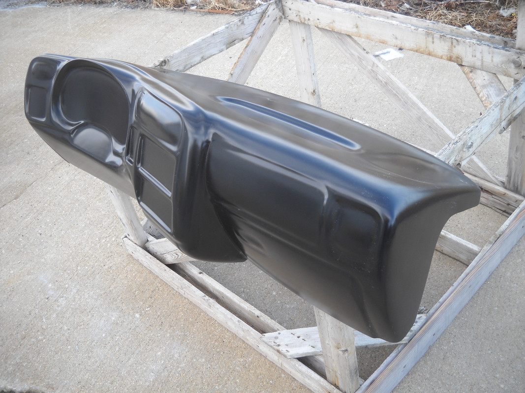

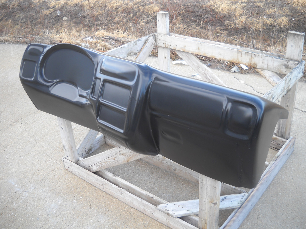

Heres the dash I ordered

Heres how to use postimage
