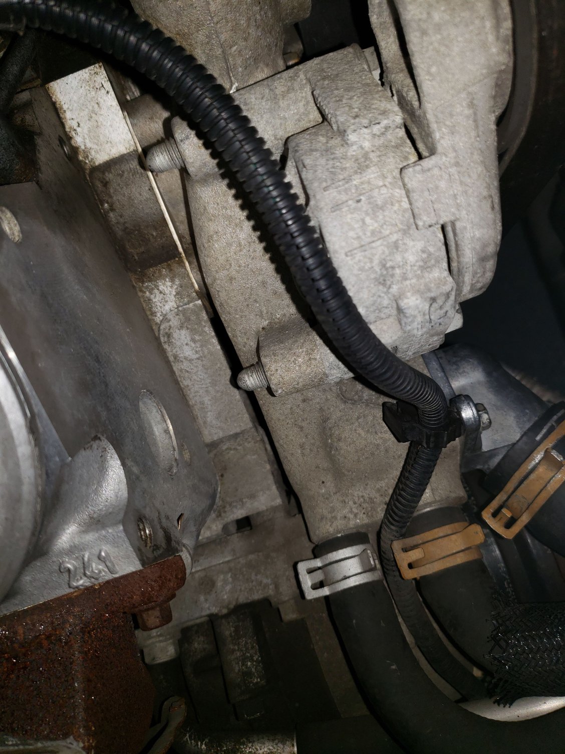

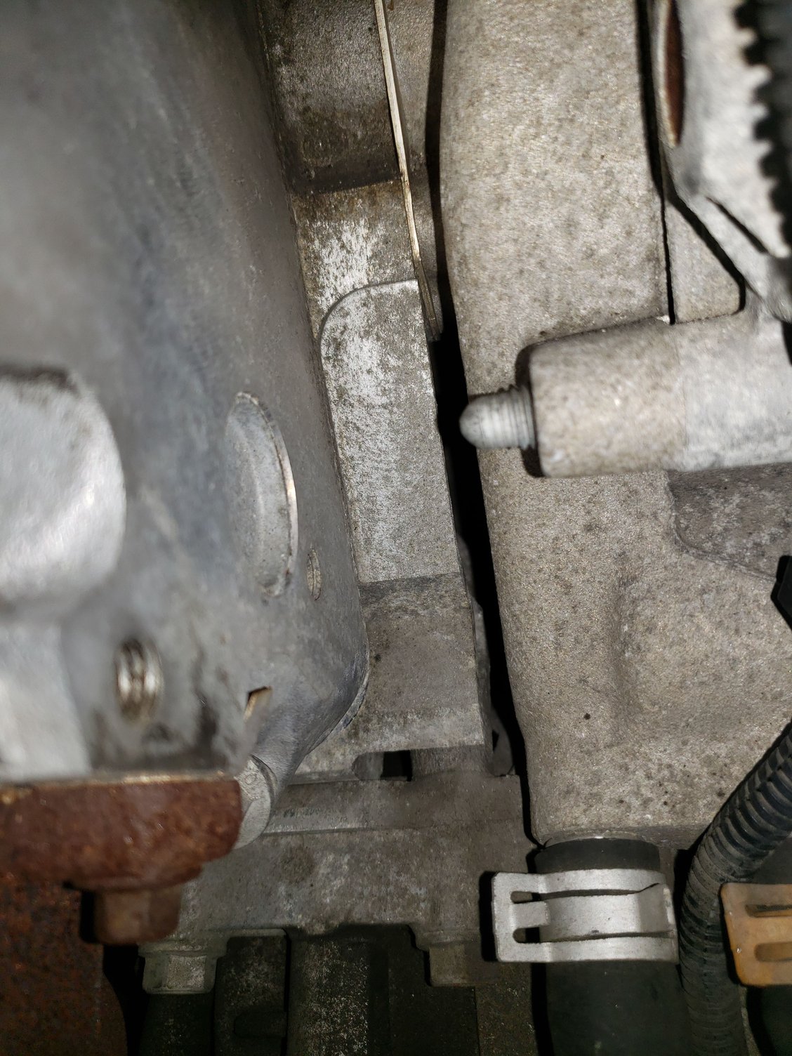

I'm going to be doing a bit of maintenance upgrades on the top side of the engine. As if I'm not spending enough time and money, I've decided to replace the valley cover to the ls6 style. Supposedly, it will consume less oil and create slightly better oil pressure. Plus clean up the engine a tiny bit of the ugly hoses. I BELIEVE my 2001 ws6 has the ls6 block. I can't see the "bulls eye" marking on my block. I do not want to bother notching my engine to make the valley cover fit. Am I correct that my block is the ls6 version?

My guess is LS6 but you'll know for sure when you remove the cover plate

The heads are showing 241 also which is typical for an ls1

Some LS1s shared/used the improved LS6 block. They were still LS1s with 241 heads but the block had some differences.
when using a LS6 valley cover on a Ls1 block you have to do some trimming to make the cover fit. On a Ls6 block, it bolts right on.
Safest way to tell is pull the cover off just to be sure. I know it sounds like a pain.

I guess I'll find out, lol. Then it'll be the point of no return and I'll probably bring out the Dremel. Ugh. Hopefully I won't have to do any other modifying. I'm still a bit confused as to what to do with the steam tubes. I've read they sometimes get in the way of the ls6 Valley cover.
I'll stay positive, I'm 90% positive my car has the ls6 block.

LS6 is different from a PCV standpoint so with that said I don't believe you have an LS6 because you don't have the LS6 valley cover with the built in PCV.
The LS6 was originally only used in the high-performance C5 Corvette Z06 model, with the Cadillac CTS V-Series getting the 400 bhp (298 kW) engine later. The V-Series used the LS6 for two years before being replaced by the LS2 in 2006. For 2006, the Z06 replaced the LS6 with the new LS7.

About 25% of the 2002 production run are rumored to be LS6 blocks. I've seen pics of some LS6 block 4th gens. The actual numbers are in dispute though.

Sorry to bring back an old, dead thread, but yes. I do have the ls6 block. Not a myth.

Here's the LS6 engine specifications and it's really only heads and camshaft that set them apart from an LS1. Well those and the block casting number and the fact that they were also drive by wire.

LS6 block was slightly different internally to allow better bay breathing. Probably not much difference in reality.
