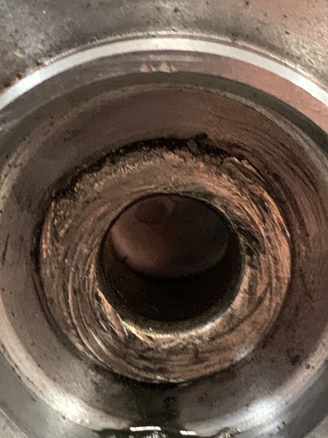

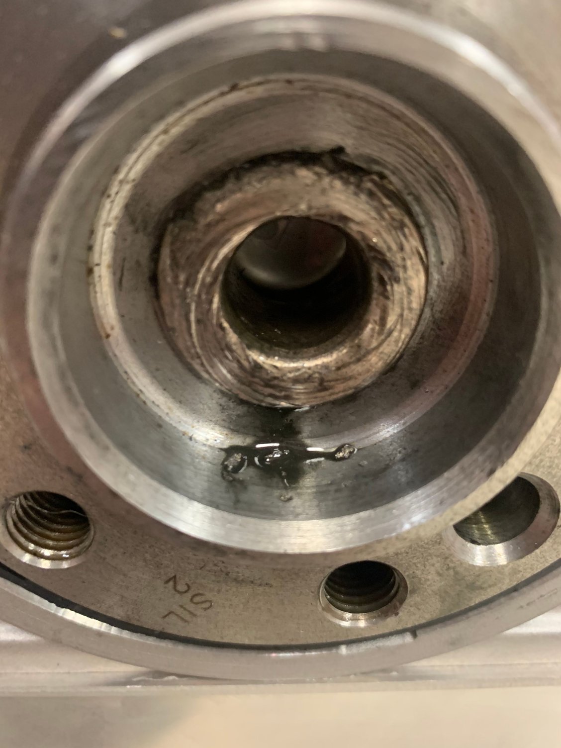

I was installing my pilot bushing today in my lq9 for my t56 magnum. I used the socket method and must of had bad aim since I chewed up the top lip of the bushings pretty good. Do you think this is still fine to use or should I get a new one. I’ll leave some pics below

It looks to me that the wear surface for the shaft "nose" looks unaffected.
The outside surface does look gnarly, but I wonder if that even affects how it will function.
I have a feeling you might be OK here.

Yeah, there really wasn't anything wrong with the old one. Would have worked just fine. That surface doesn't actually do anything.
Only way I know of to keep that from happening, is to be more careful about installing the transmission. Specifically, make sure the trans goes in straight and level, so that the clutch gear is pointed straight into the bushing. Try using longer bolts to support it at a greater distance from the BH, so you can slide it in easily by hand.
I also notice there's no grease in it. Not good. Grease it up good. Pack it, but not so much that the welch plug gets driven out when the tip of the clutch gear goes in.
