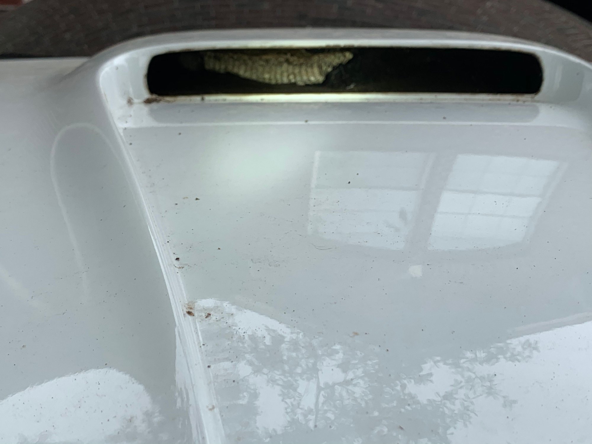

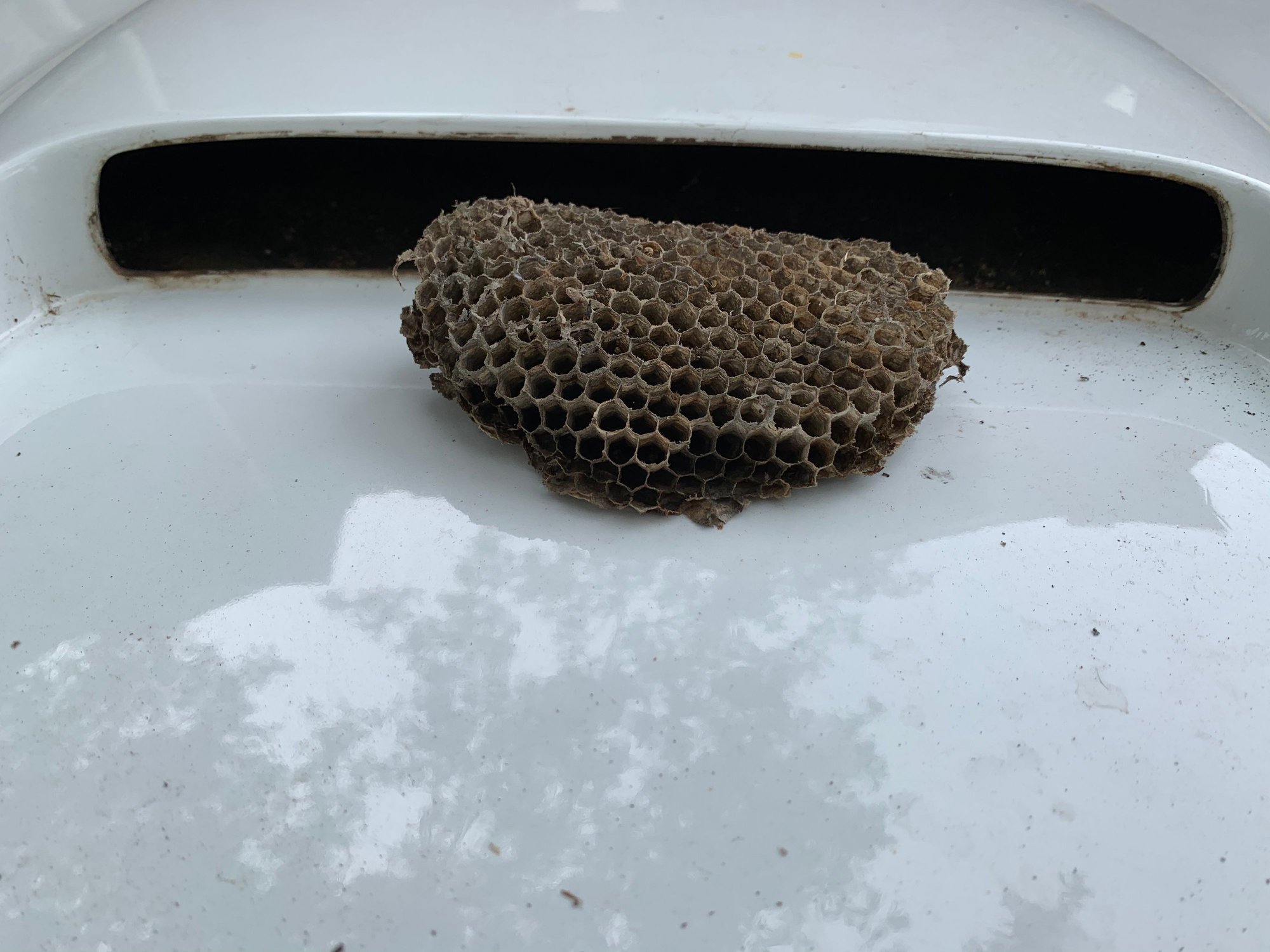

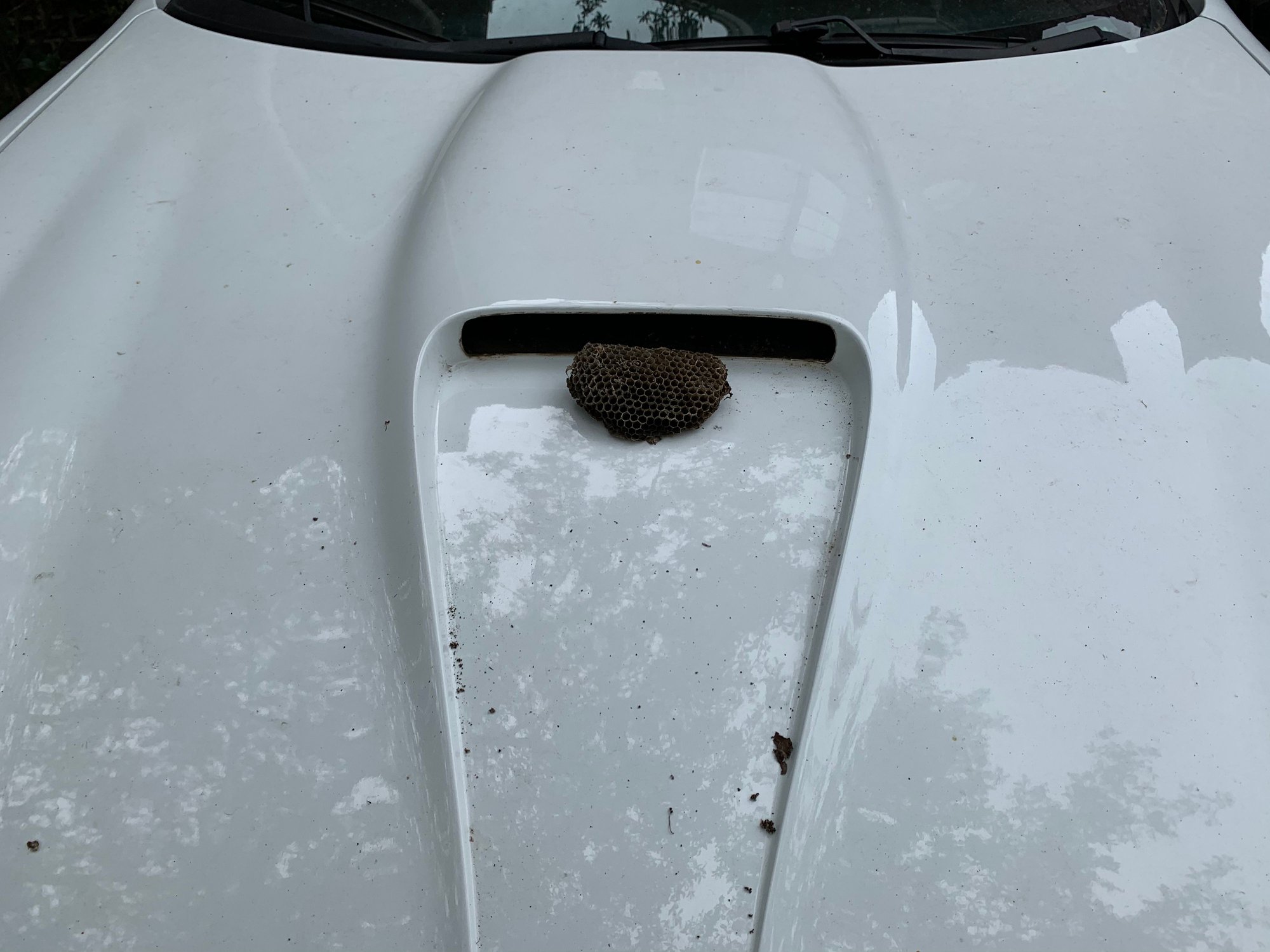

I picked up about 5 horsepower after I removed the wasp nest.

That honeycomb straightens the air flow.
Yeah, have you ever seen a MAF with the screen still on it? Literally honeycomb
is that the SLP Honeycomb nest.. i found a good design from this thread just have to fab and fit, it comes out at the scrape guard(which I hit every day) forgot to mention I have the body kit on the front (forget which one off hand) I want to say Xeon? Anyway will post pics of install in a month or so..
