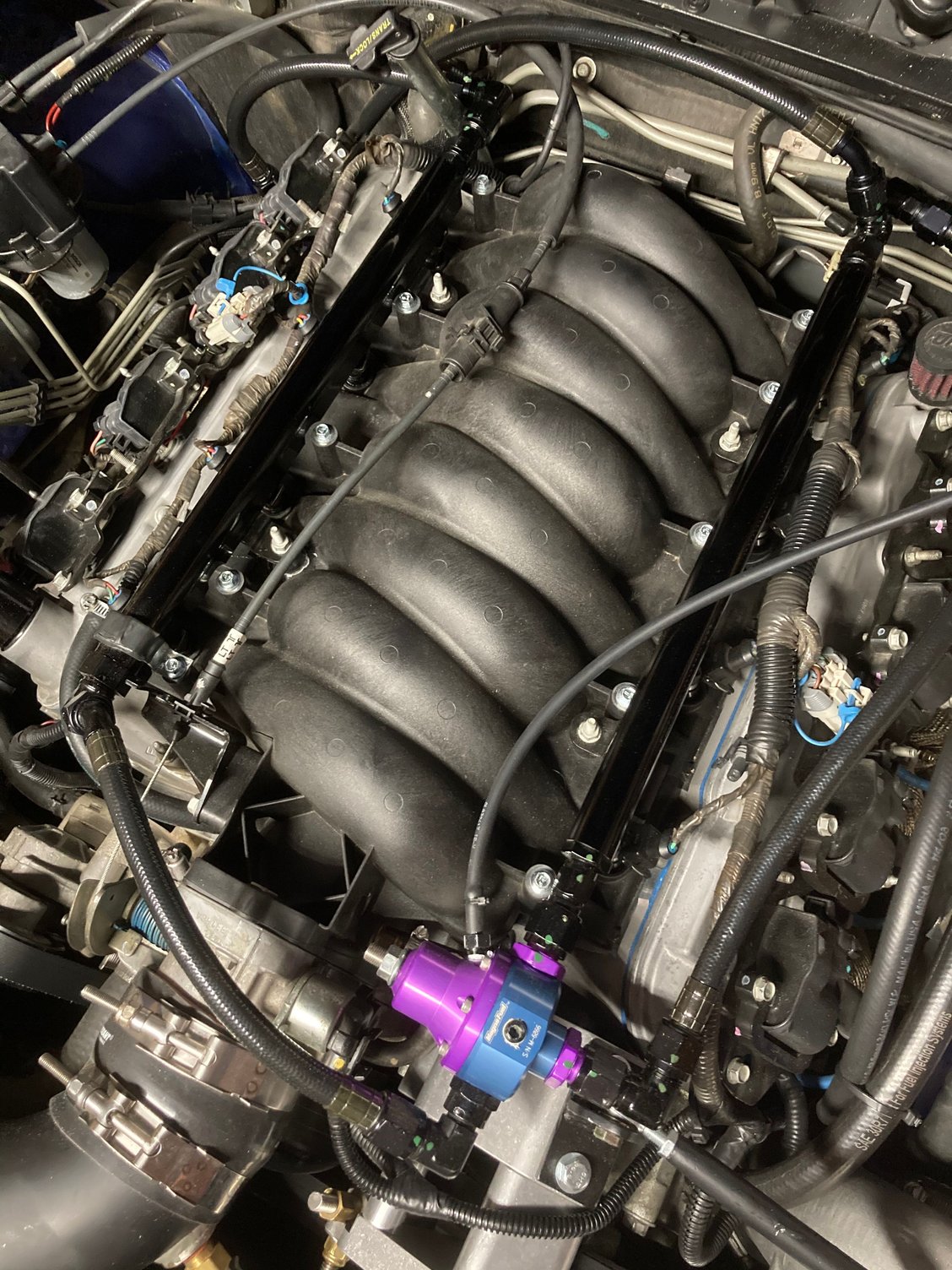

I have a forged rods/pistons ls3 block with a cathedral port top end. I’m running an ls6 intake and stock throttle body. Hitting near 20 psi with a Procharger. Recently I had the little pillar for the front fuel rail mount on the passenger side break and cause this...
Obviously with a magnafuel 4303 pump and 58 psi base pressure that sprayed a lot of fuel in a hurry. I got very lucky and didn’t have a fire.

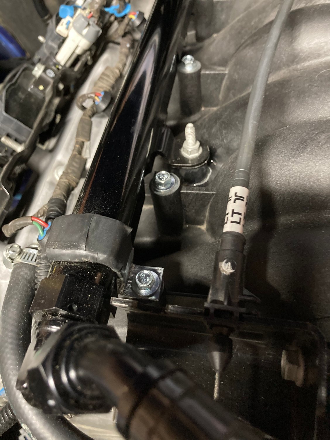

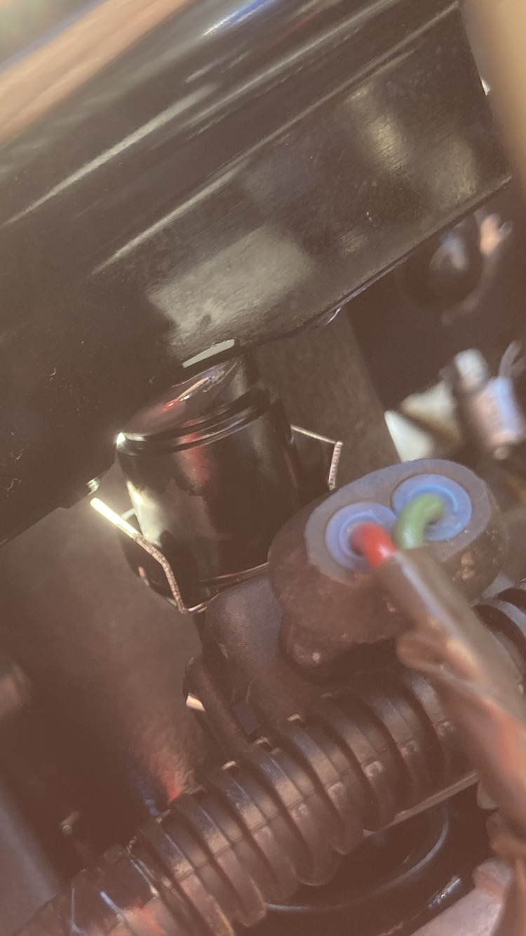

I have my rail crossover in the front and never liked the way it sat and the rail on that side seemed a little crooked with the front injector on number two hole not fully seated in the rail. It never leaked and I check it frequently. I’m thinking there was some uneven pressure on the rail that led to the mount breaking.

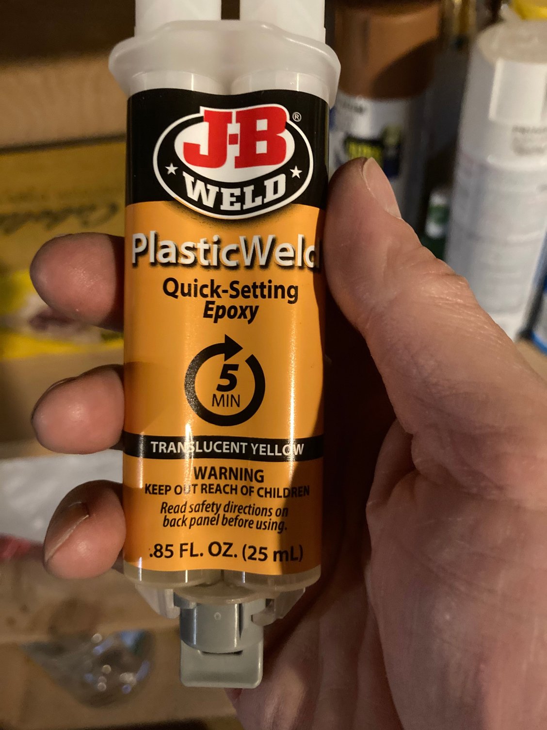

Like most things quality aluminum intakes are out of stock. So I tried this to bond the plastic pillar for the mount.
I also fabricated a brace for the rail which incorporates the manifold bolt on the front to hold down the rail.
The brace actually holds the rail solid without the rail mount bolt in place.

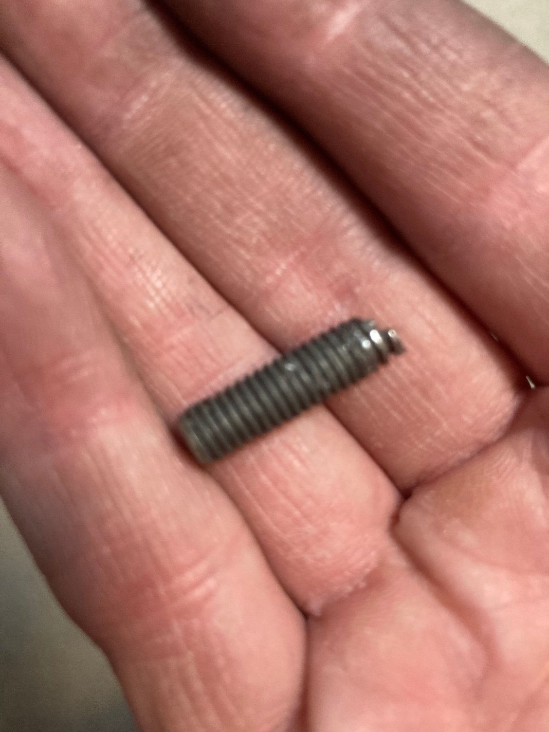

of course there was the typical set back somewhere during the process. When the 8th bolt snaps off on the second pass of torque sequence.
It is all back together now and running well.
So obviously I’m having some insecurities about driving the car like this and just wanted to get it running.
