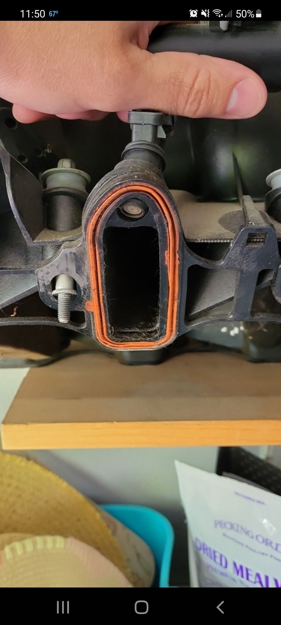

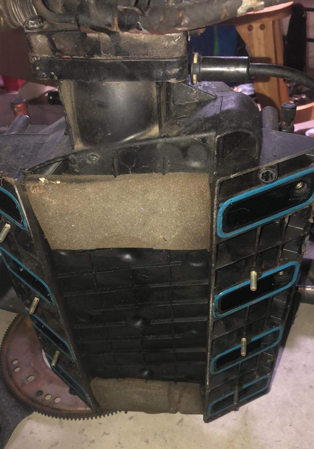

See pictures. Truck intake ports are orange and cathedral, and LS6 intake are rectangular and blue. All LS6 intakes say they are cathedral but look rectangular.
Stock truck intake
LS6 intake

That is funky but yes that is correct. Something about inside it matches up outside it looks strange I don't know

shakenfake- Truck and car manifold gasket surfaces are just made differently. They function identically.

I think what's throwing you off, is the LS6 intakes have a straight flange, which allows them to use a symmetrical rectangular gasket. The truck intake rounds the flange off around the injector port, so the gasket is uni-directional.
If you were to see them in person, you'd see the ports themselves are basically the same.
