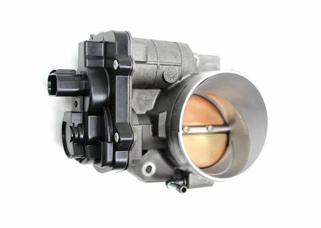

In Australia the VZ commodores with LS1s also ran a DBW throttle body ~75-78mm on the LS6 intake which looks to be different from the c5/truck ones.

I'm not real sure as c5s and chev trucks aren't really that common here. The ones Holden uses are Hitachi brand I believe and look like this.
thanks! Late reply but I’ve just ordered one 👍
