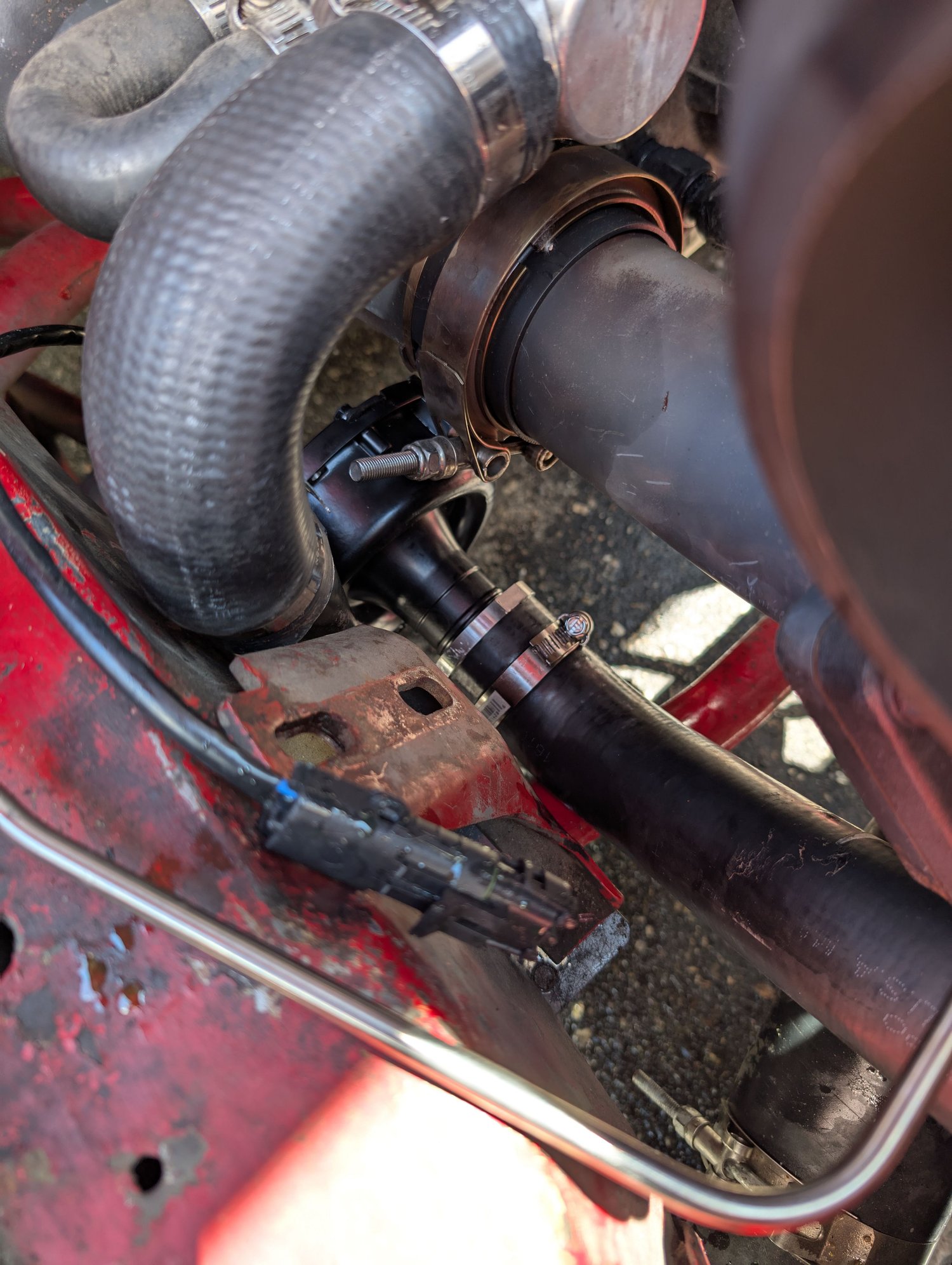

Well I got the EWP installed today the thing is super compact, lightweight and quiet. When I turned the pump on engine off I could just barely hear the thing. I think I managed to get all the air out in the first go but since it's still raining I left the cap off and let it do it thing overnight. So before this little experiment when I was at an idle what I was seeing was temps would get up to my fan turn on temp of 188*(brushless with soft start) and once the fans were at full tilt temp still climbed up to around 193-195ish and it would come back down to 185 rinse repeat. With this EWP in there I immediately noticed that my temps wouldn't go past 190 and then it was like 45 seconds to come down to my fans off temp of 185*. So far it's looking good I just wish the weather would act right so I could go for a rip without fear of dying lol.
There it is tucked down there nicely. I was able to cut my existing lower hose for the top connection then needed to raid a parts stores hose stash to get from the radiator to the pump. I needed a Z shaped hose and luckily found one I could work with
