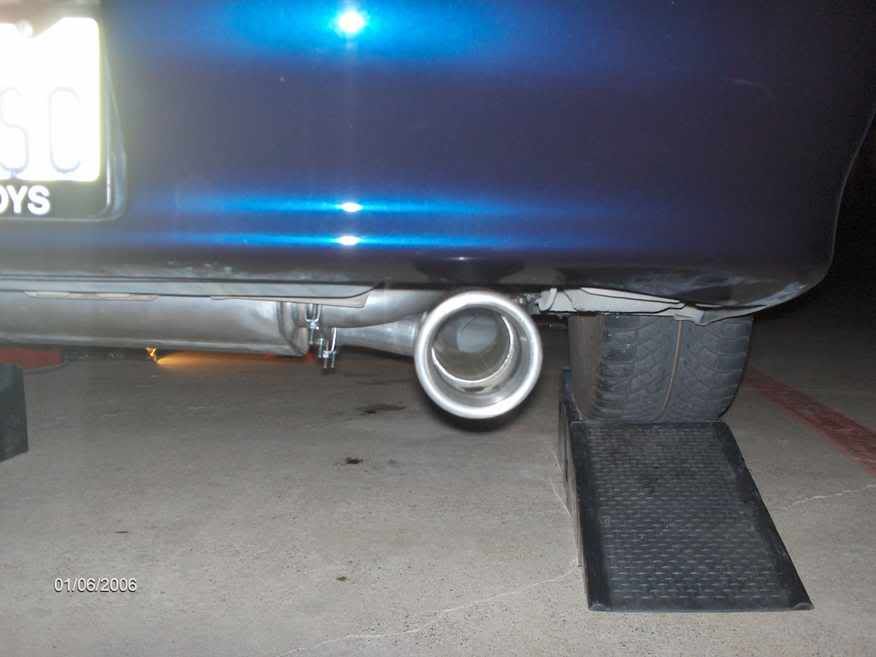

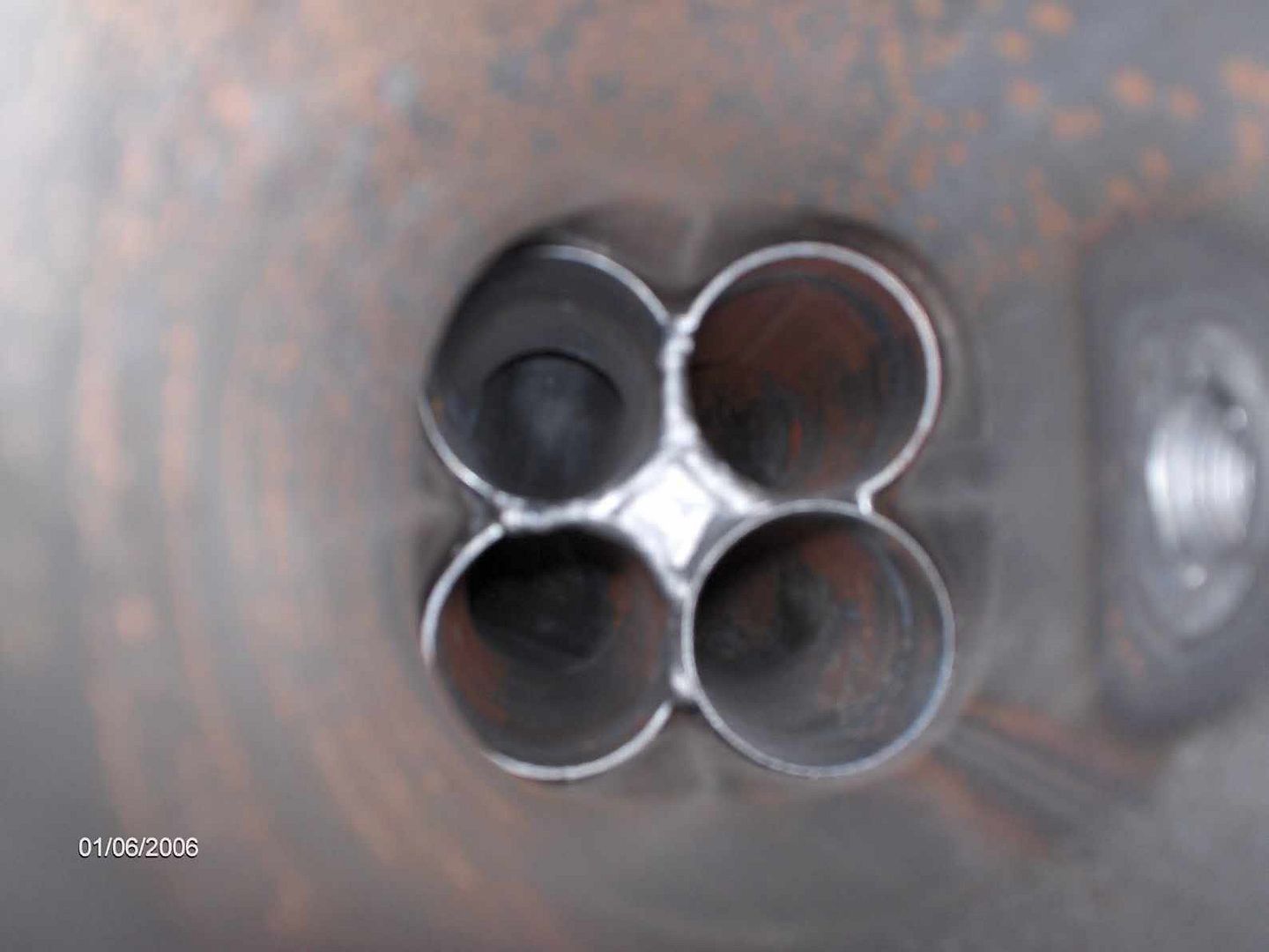

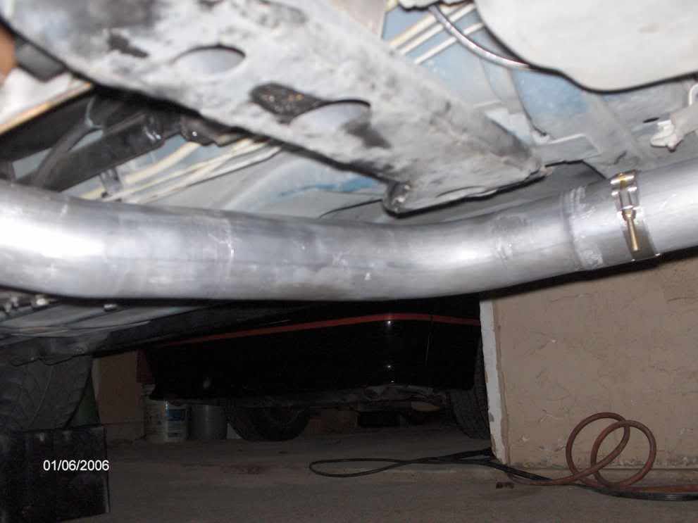

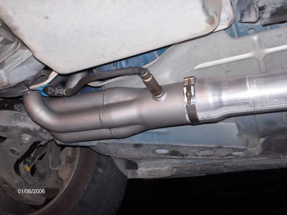

Start from the bottom and work your way up. Id do it all over again because they fit sooo well. The emission stuff is in the right locations, the collectors tuck and fit better then the Kooks or QTP's and the y-pipe is the best ive seen for the price. With no banging or clearance issues anywhere.

You'll be very happy you did Matt....You'll see a little more increase with that collector setup over the welded ones.

Absoultely perfect. Nice rumble to it when you fire it off. And its very tame when cruising.

Best tucked setup ive done in a while besides a custom setup...

Yes they come with the fittings and are even in the correct locations as well. They also include block off plates if you wish to not use them.
As far as installation went...i did it just like any other header ive done on my back. A block of wood under the k-member and 2 6-ton jack stands for safety. Took the oil diverter plate off above the filter, steering shaft and slide it in place. Pass side was a little tough but you gotta know how to manipulate them in the car. Ive never once jacked the motor up in any car to install headers. Guys, there are safer ways to do installs and easier.

To be honest I think they will get thrown on any LT header. The actual heat doesnt reach that far down the tubes like on a mid-lenght or on a stock manifold...thats why when you pull your 02's on a manifold or Mac header they are burning hotter then say a long tube. You see it with the tip of the oxygen sensor being white/gray vs sooty. Hope that makes sense.
