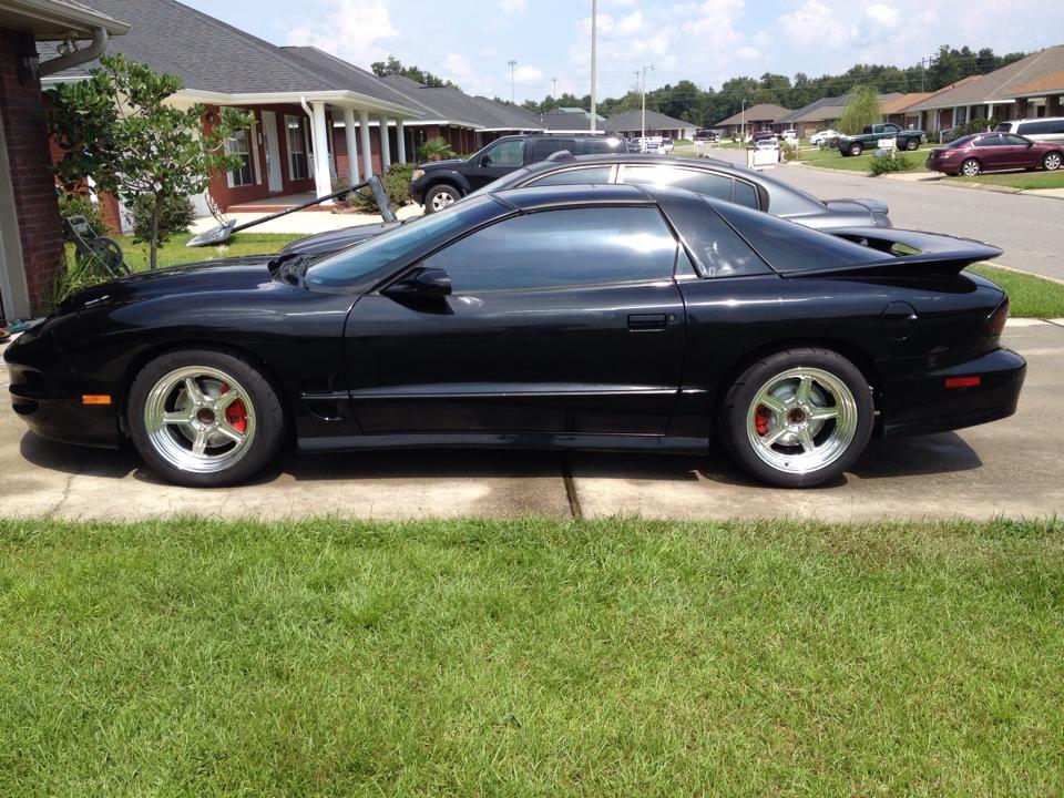

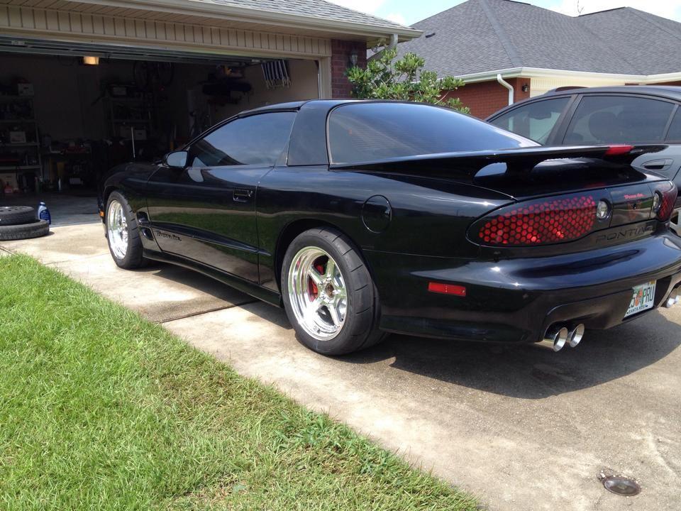

Figured I'd post some pics of the stance and wheels...

Looks great, can't wait to get street lites for mine. Those are 9.5" and 11"? Should've put the center caps on for the pictures!

Yup. 9.5 and 11. No fitment issues whatsoever. I may leave the caps off... Still debating.
