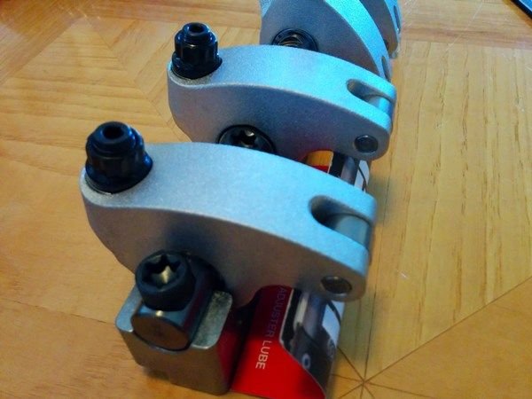

I don't think the Jesel Sportsman's are adjustable?

I actually can't tell from the picture if those are Sportsmans or Pro Series - Solid Body.
They're both adjustable...?
Funny you all should bring that up. They did not come with instructions or torque specs, so I just went to download them online. Since they were adjustable and the only instructions for adjustable are for Pro-Series, I used the Pro-Series torque specs. So I torqued the rocker shaft bolts to the pro-series specs of #37 and broke the first bolt I attempted to torque. So, I dug a little deeper. Turns out there are adjustable sportsman series (which is what I have). But, the Sportsmans use grade 8 Torx bolts while the Pros use ARP bolts. Guess what happens when you torque the grade 8 Torx to #37 instead of the #27 recommended for the grade 8 Torx.

I'll take "**** you off and a lost tool in the woods for 1200, Alex"
Nah. It just meant the momentum stopped on the project until FedEx could do their thing. Sux when you are on a roll to kill the momentum.
