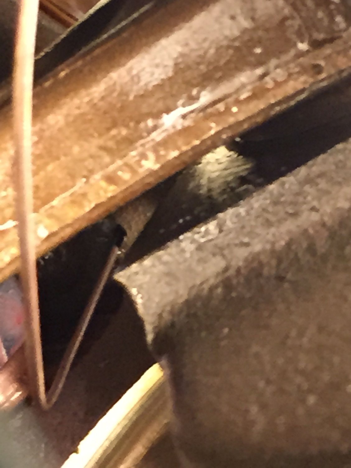

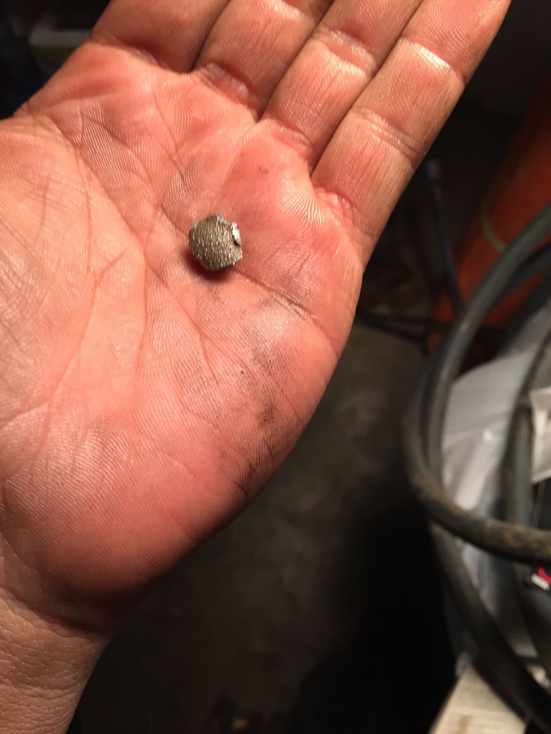

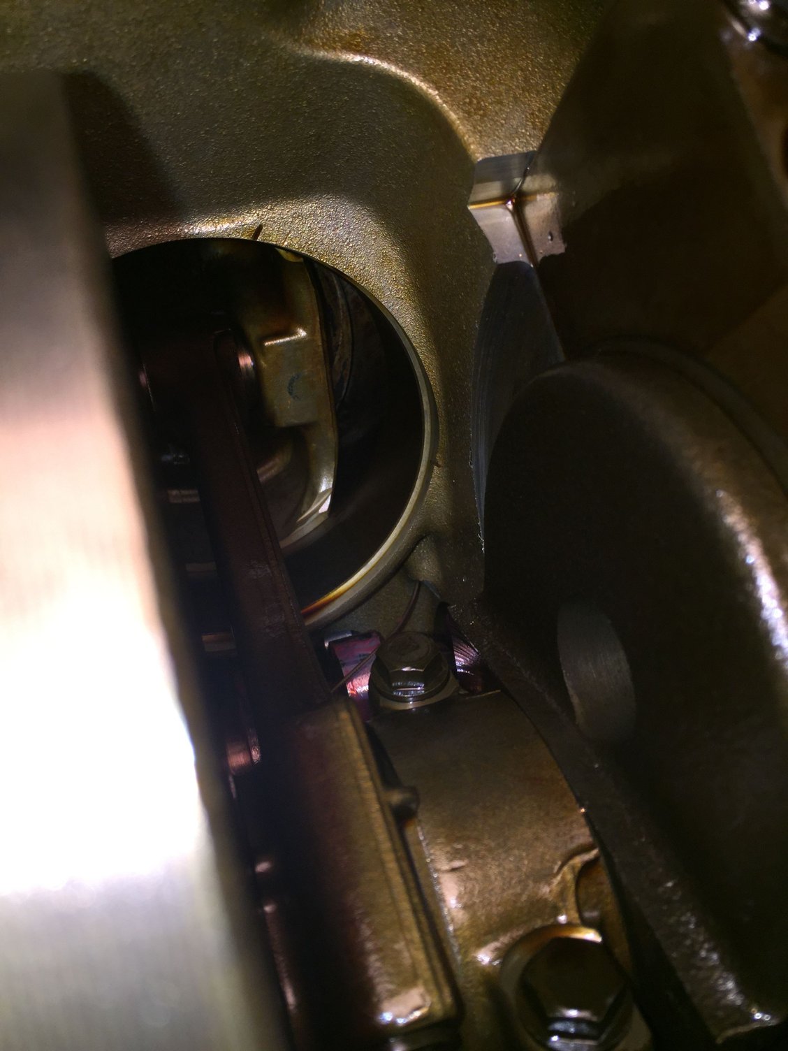

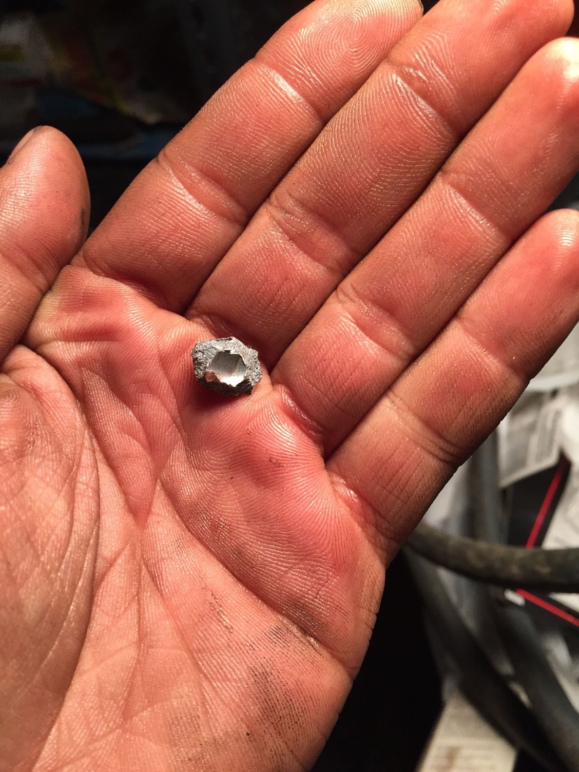

just how it says, i was putting back my heads onto my ls1 block and as i was putting the first bolt back in not even half way, suddenly a pop noise, took the bolt off, take the head off to check and i find a little chip off the block, my guess is that there was water in the cylinder bolt hole, im guessing bolt sealed up as i was torquing down the bolt created pressure and the block gave out, i will attach some pictures of what im talking about, i inserted a copper wire so you can see were the piece came out of. Now my question is has this happened to anybody else and have they been able to use the block again and did it run fine?? would be a good idea to weld that hole back up assemble everything back up??? What are your thoughts???

You really need to inspect the block good for cracks. You may have dodged a bullet but when this is done the block is typically cracked and unusable.

Quite sorry, the block is junk.There's no repairing that.
