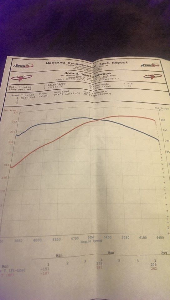

Finally getting around to posting about the torquer v4 cam that I just put in my car. Doesn't look like anyone posted anything about this cam so far since it's still new.
Spec's on the cam are 231/234 .619/.612 on a 111° LSA.
When doing research on what cam to choose I came across this in a recent thread. Seeing that this cam would be a little easier on the valve train, I figured this would be a good choice for me since my car is a street car that sees a lot of driving, but didn't want to give up power.
Originally Posted by Sales3@Texas-Speed
We actually just released our Torquer V4. It's not yet on our site but we have several in stock. It's the same duration as the V3 but with the new Texas Speed proprietary lobes from comp. The specs on that cam is 231/234 .619/.612 on a 111° LSA. Powerwise you will only see a 1 to 1.5 rwhp difference but you will have the softer lobes to make the valvetrain last longer.
Lonnie
So my car is a 98 with TSP 1 7/8 headers and ORY, ls6 intake, SLP lid, and a rumbler catback. FLT built trans with a Yank 3600 stall. While installing the cam I added a Fresh set of 243 heads with a 5 angle valve job. So pretty much just a bolt on car. STILL HAVE FACTORY 2.73 GEARS
So after getting everything done with the swap. I took my car over to Sound Performance, who squeezed me in right away to get my car all set up.
Car made 387 rwhp and 375 tq in SECOND GEAR.
The pulls had to be made in second gear because 3rd gear pulls took too long with my 2.73 gears. Over all they said if they were able to dyno it in 3rd I would see around a 10-15 hp increase. So its around 400rwhp with a cam only car. Not bad in my eyes with a car with 116k miles on it.
After driving it for a bit the car really pulls hard now. The power is usable mostly everywhere, and pulls really hard after 3200 rpm.
Timmy at Sound Performance has my car idling great. It sits at right about 1000 rpms smoothly and I never had problems with it wanting to die or anything like that.
So what do you guys think? Numbers sound about right for second gear pulls with the converter unlocked?
Will be going to the track soon but I will most likely be on street tires until I make my mind up with my new set up. Also got to start looking for a rear end.
Also, Just wanted to give a shot out to everyone at Sound Performance. They had truly the best customer service and got me in the following week to tune when they were booked solid for months!

Regardless of the dyno numbers what it traps at the track will tell the true tale of the power you're really making. Nice job

Im sure its an improvement over a v3 and that thing would pull very good in the one I rode in. Now swap your gears out and hang on for the ride!

Seems impressive to me. Those 2.73s are gonna kill you lol. I went from 2.73 to 3.73 in my A4 car and it made a world of difference

Nice numbers. In 3rd I wouldn't be surprised to see 400rwhp.
