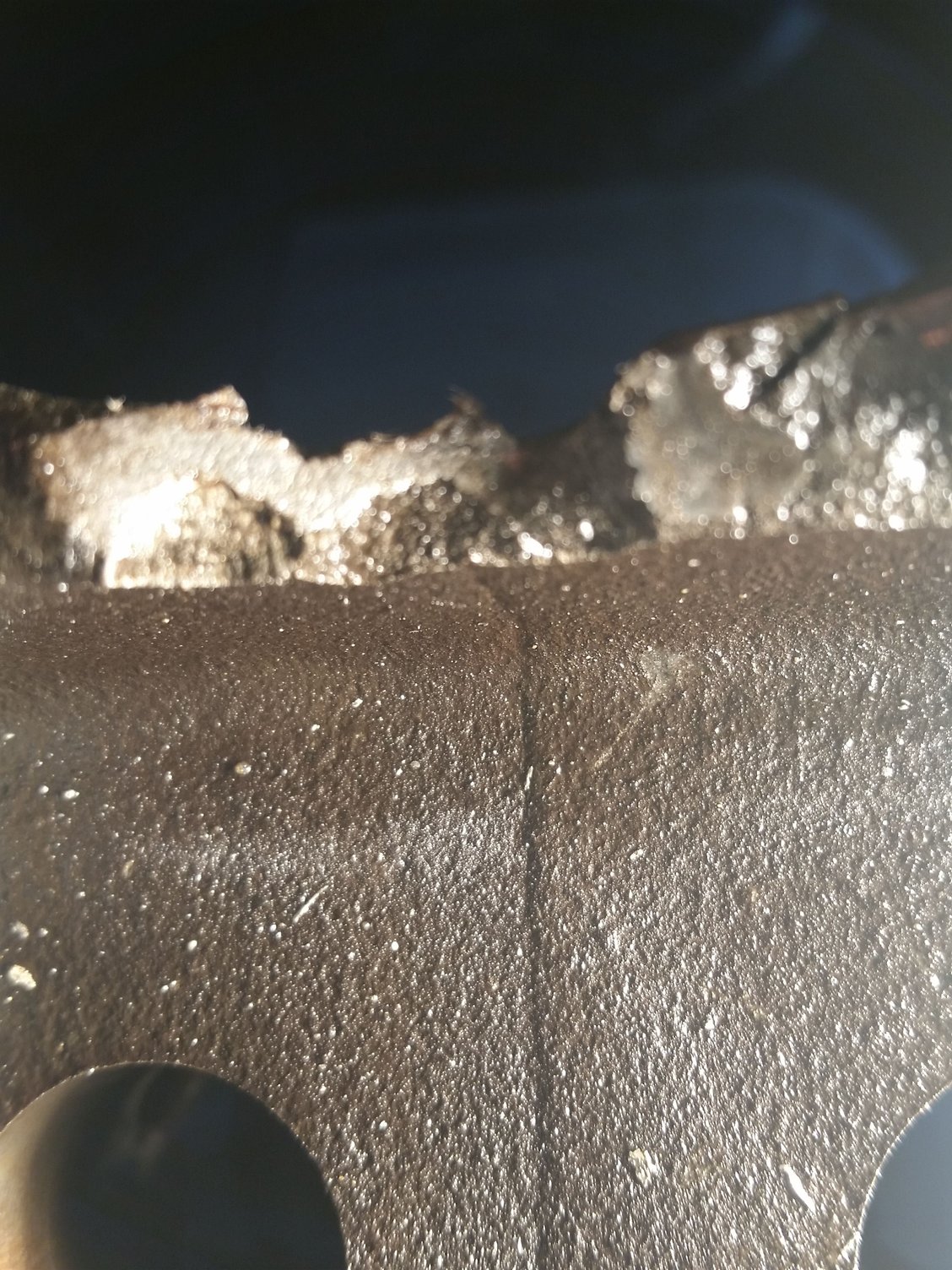

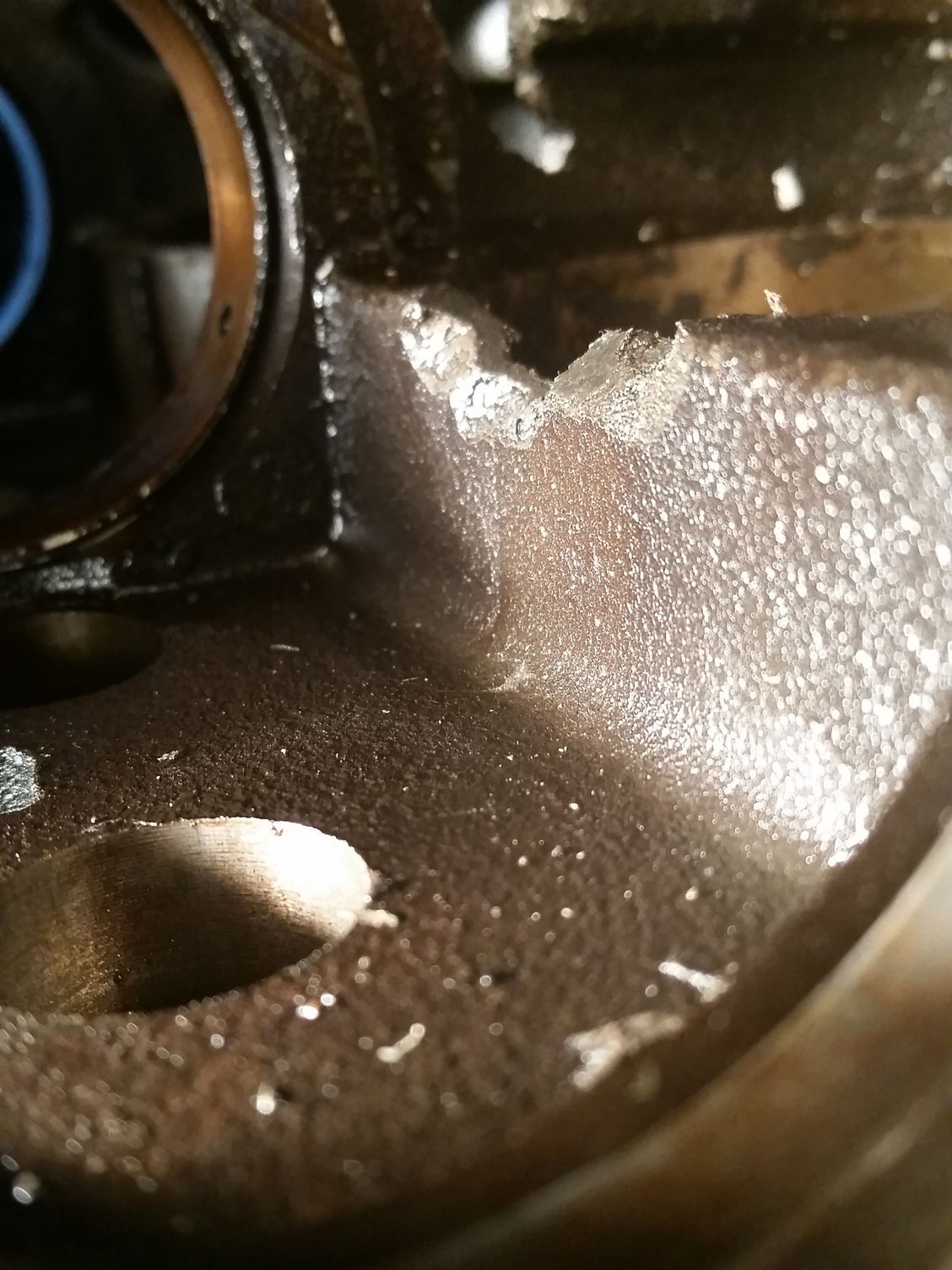

I picked up a lq4 from a 01 3/4ton. I knew there was 2 rods that broke but figured I take a chance.. I was hoping there wouldn't be any damage to the lower part of the cylinder. . I wasn't so lucky. The damage doesn't look to bad. But before I take it to the machine shop..am I wasting my time? does anyone else have experience with simular issue?

    its garbage

    Why junk? The damage is below the rings. Why can;t you grind out that damaged area and use it? Cylinders are cut like that for strokers.

    .boB has a great point..thats what i was hoping for and why i asked .

    Can you tell if it's into the water???
    I'd get the cam and the crank out before I made a final judgment...

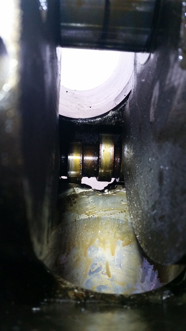

    From what i could see, the damage looked like it just in the small area.I'll finish taking it apart and look it over better. Maybe get some better pictures

    A stroker might be machined at the base of the cylinder to provide clearance but that is a different operation than debris smashing around and potentially cracking beyond the missing material, like possibly to water.
    I would want more thorough inspection, carefully grind it smooth and magnaflux, or pressure test, something............

    I agree. I think at least I'll have them megnaflux the area.. maybe in the meantime I'll come across a good deal on a bare block
