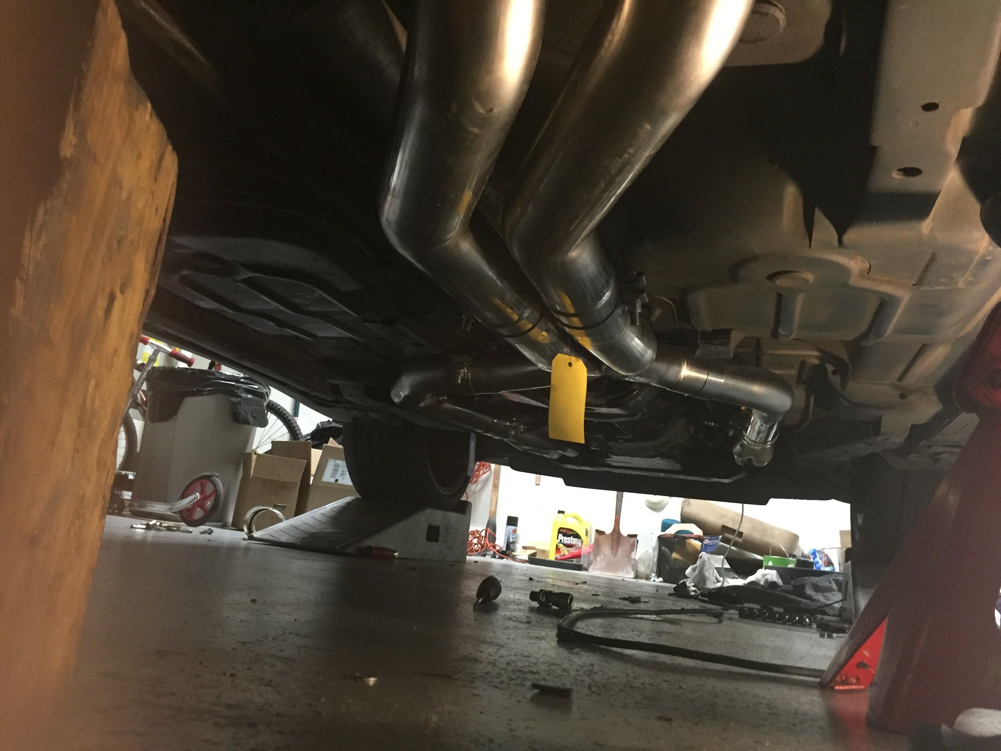

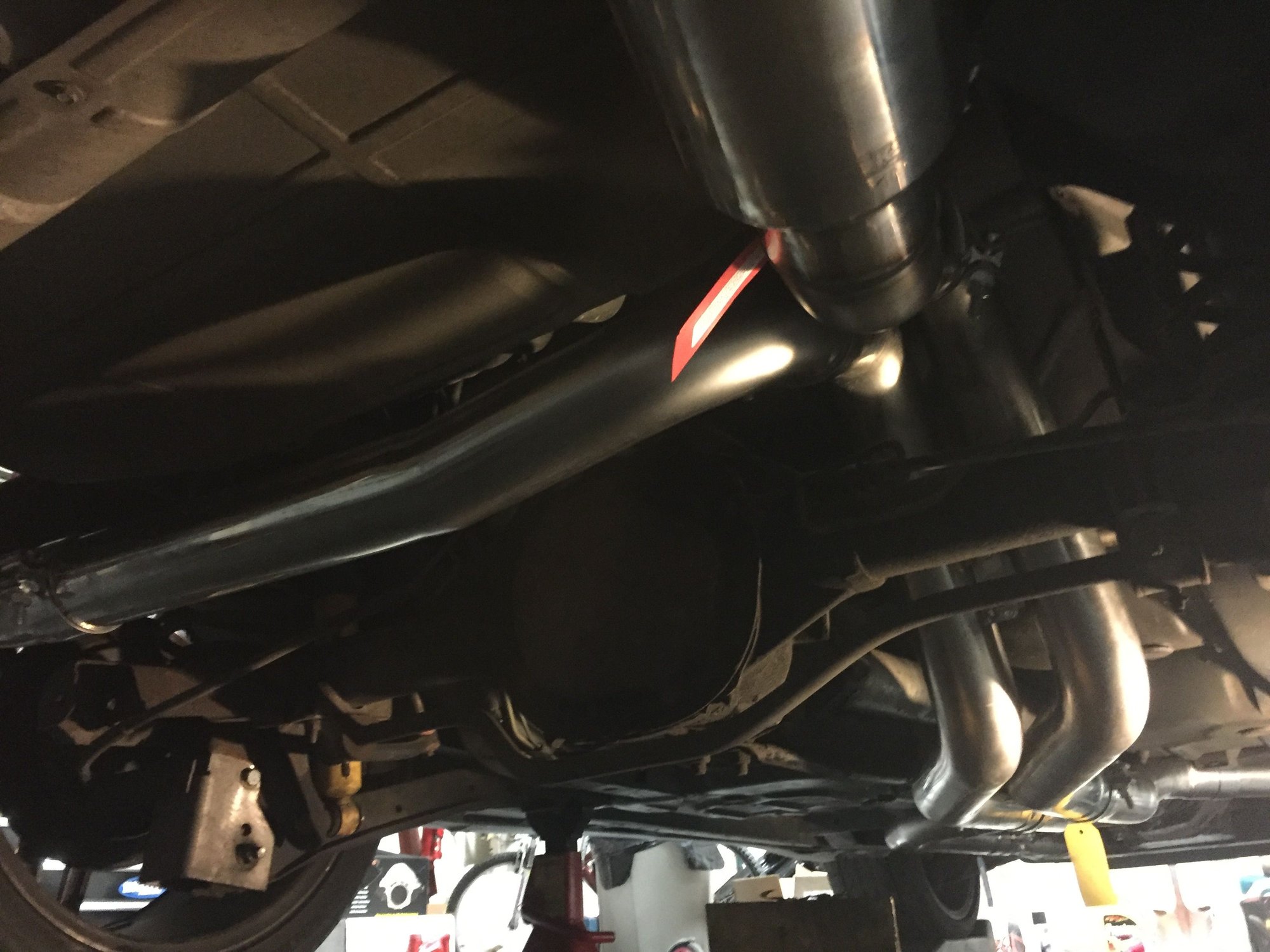

I found some E85, but it's 40 miles away. I can get 108 unleaded 3 miles from my house now. I think I'll just end up taking a 2.5-gallon can with me for every fill up. Go get the good stuff, then drive to a regular gas station for the other 10 gallons.
So, in other news, got this done over the holiday weekend...
Kooks dual exhaust from axle forward
Kooks dual exhaust again. tried to catch the mufflers in this one, but couldn't get a good camera angle.
I got in one good start with the new clutch and exhaust installed, but no chance to really test everything out. First impressions - I was able to shift gears without the shifter ****, just using the stub coming off the shifter. Pedal feels pretty good, but I want to road test it. I have only confirmed I can shift through all the gears at idle. Also, the exhaust is louder, but it sounds SICK! Deep and throaty like a pronstarlet's voice.

So, last night after work, I started it up and let it run to warm everything up. Probably an odd thing to notice, but on the old exhaust, the gases would sort of just sort of "drizzle" out of the tailpipe.
Now, it's got some velocity and force behind it. Like using the other hand to hold your hand against the tailpipe velocity. Gases just come blasting out.
So, that tells me even with the cats crowbarred out I was still dealing with a heavy back-pressure issue, which I attribute to my crappy 90-degree merged Y-pipe. Will be interesting logging over the coming weeks to see if the timing and VE's improve

After I finished my heads & cam build, I had stainless works 1 3/4" longtubes (2.5" collectors) to a catted y-pipe out the slp dual/dual. Made 419/368 on a mustang dyno. Swapped to kooks 1 7/8", to a 3" x-pipe to borla xr1s. Made 440/386 with no other changes, same dyno. I imagine you will see a huge gain. Definitely notice it once you get it retuned.

F-ckin A, that **** woke the car up!
I've got work to do on idle quality now, but all out running. I thought it was fast before.
Now, its a real handful. Sounds mean, too. I like the duals, but I must have really been fighting some back pressure. It has completely opened up.
I need to log the car for a few weeks to get the tune down again before I hit the dyno. But I'm roasting 305's in third gear. Not chirping. Roasting.

If she misses 500 it won't be by much. It's fast.
On the loud question, yes they are quite loud. I'm ok with it but it caught me off guard at first. It flares really loudly at start. I've already set off a car alarm starting the car. Seems like cold start is the loudest and it quiets as it warms up, a little.
It's actually louder in the car than it is outside the car. The worst spot is right next to the rear bumper. Once you get a few feet away, it drops off fast.
I'll try to post a video but the cell phone video sound quality doesn't really tell the story of how it sounds. You lose all the bass tones, and you can't gauge volume. I keep getting errors when I try to upload so I guess I'll have to make a YouTube account or something.
