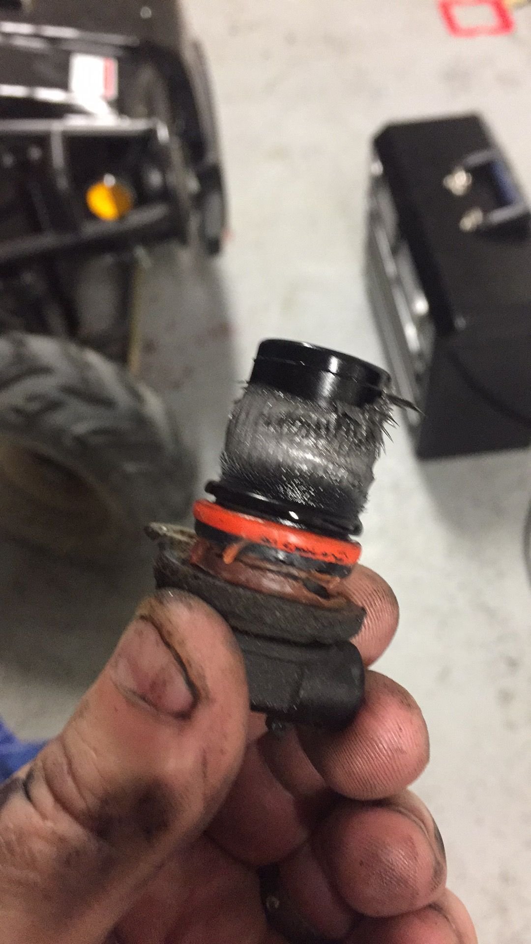

Time for an update. I had forced the driveshaft on so I could at least break in the rear. Up on stands, did five heat cycles, and then drove it some. Gave it hell a couple times just to feel it from a roll. Nasty *** vibration over 65. I mean horrendous. So, I went back through the pinion angles and got them right, and it still had that noise and vibration. It felt like a loose transmission mount, but it wasn't loose.
So, on a hunch, I went ahead and ordered a new T56 from RPM transmission. Turned out my hunch was dead on. After removing the DS, I started the motor, and you could see the shaft wobbling as it rotated for lack of a better word. Then, I started removing all the bolt-ons from the transmission to put them on the new transmission. Found this:

What's the plug with filings on it? I sure wish I could get mine on a dyno. My 220 heads and cam feel like a lot but for now it's only feelings.
I think it's the vehicle speed sensor. Hard to tell from all the shavings lol

His output shaft bushing probably died. They don't like vibration.
Yeah, it's the VSS.
So on your HUNCH(lol$$$) why not go for a T56 magnum?
I'm sure it did. It was visibly off center when I was struggling to get the driveshaft in. I considered a magnum, but I figured at ~500, I probably don't need it. It looked heavier (although a friend later showed me they are within a few pounds of each other) and a good $2000 more.

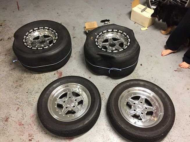

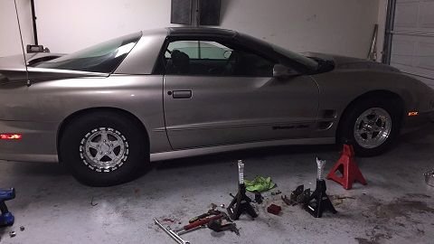

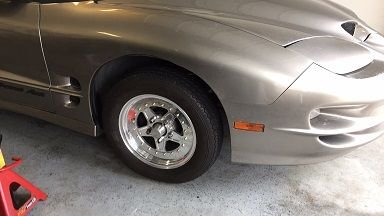

I think she's actually FINISHED!!! Here are some shots of the new wheels, mounted, not mounted, etc... Working on dyno appointment soon followed by hopefully a track run or two. The new wheels really made it fun to drive all over again. Hooks up great, and no more fear of breaking parts. If I had it to do all over again, I'd do it all over again. There isn't really much I would change from this build.

Car looks amazing Darth! Love those wheels on there. Looks like it should've came that way lol. Good luck with dyno buddy. Keep us posted

Nice wheels. Time for the track now. Got any kind of et and mph figures in mind as a rough?

Nice drag pack! I like the wheels. In 4 results.
