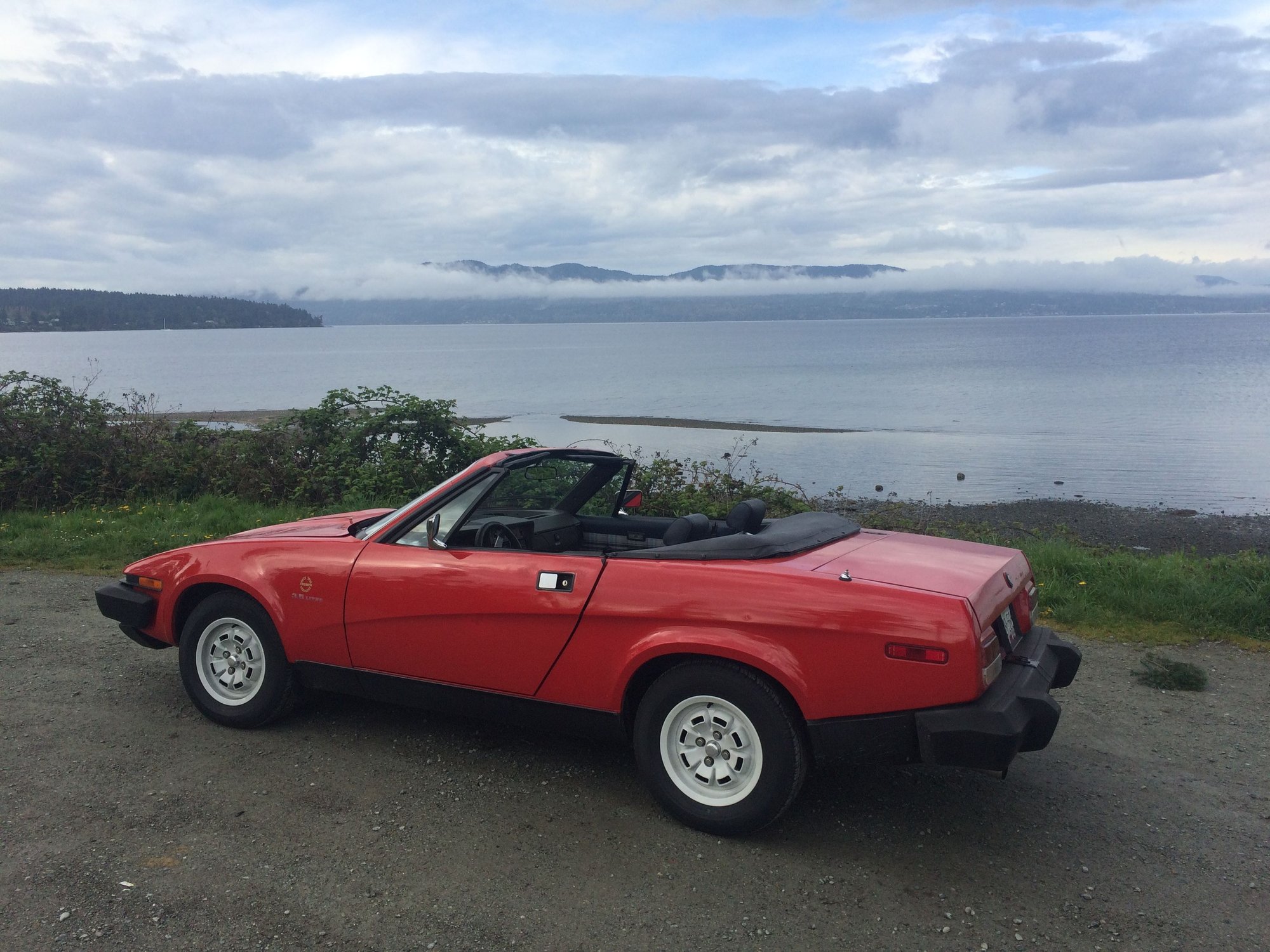

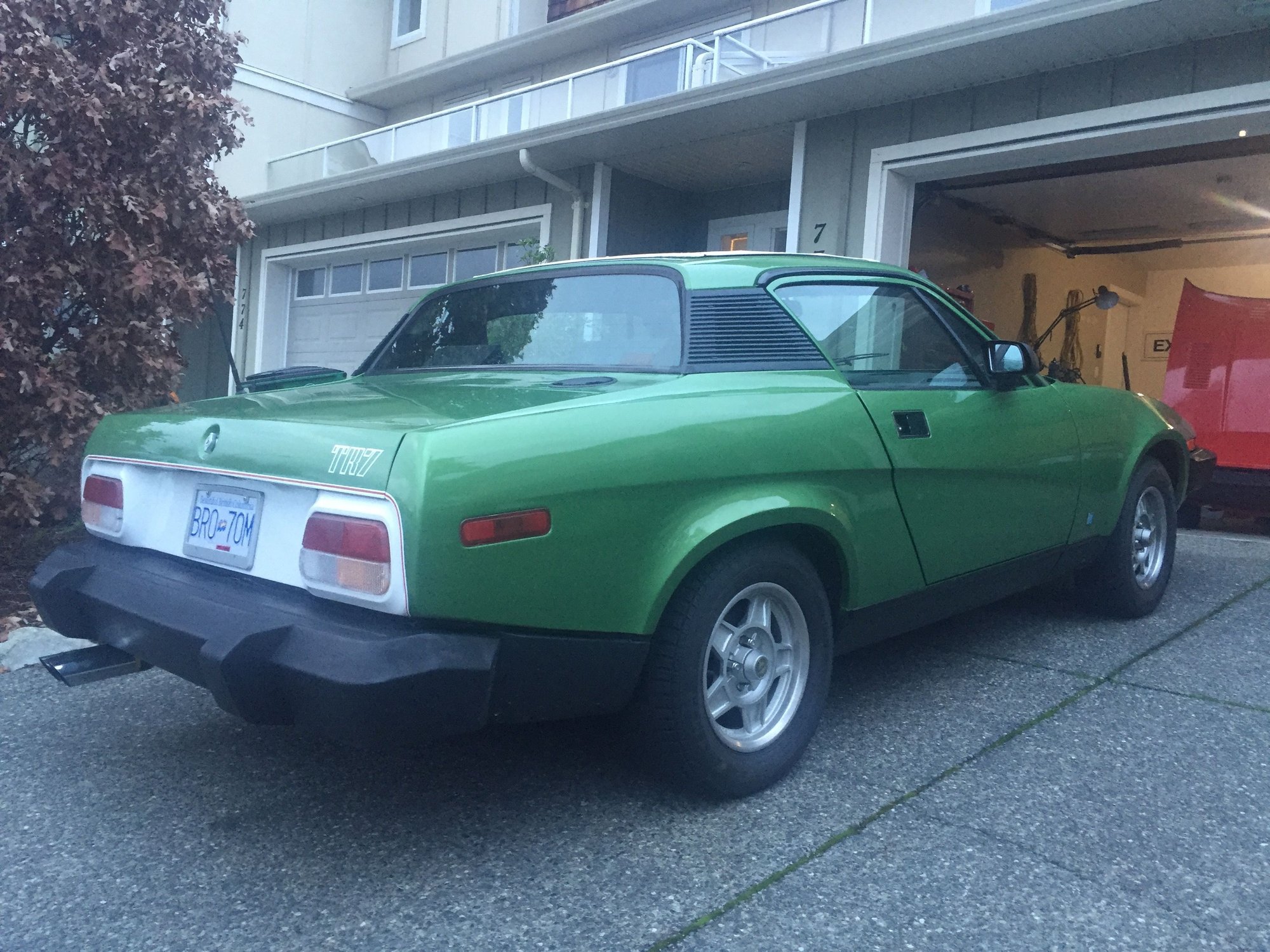

Here is the car. Wont be much of a sleeper sounding like that.

Man. I haven't seen one of those in year. That thing is clean.

Thanks. Just got that one, the one in the garage is another coupe, and sadly it must go, not enough room.
This is my TR8. Factory little 3.5L V8 with a bunch of custom stuff done to the engine.
