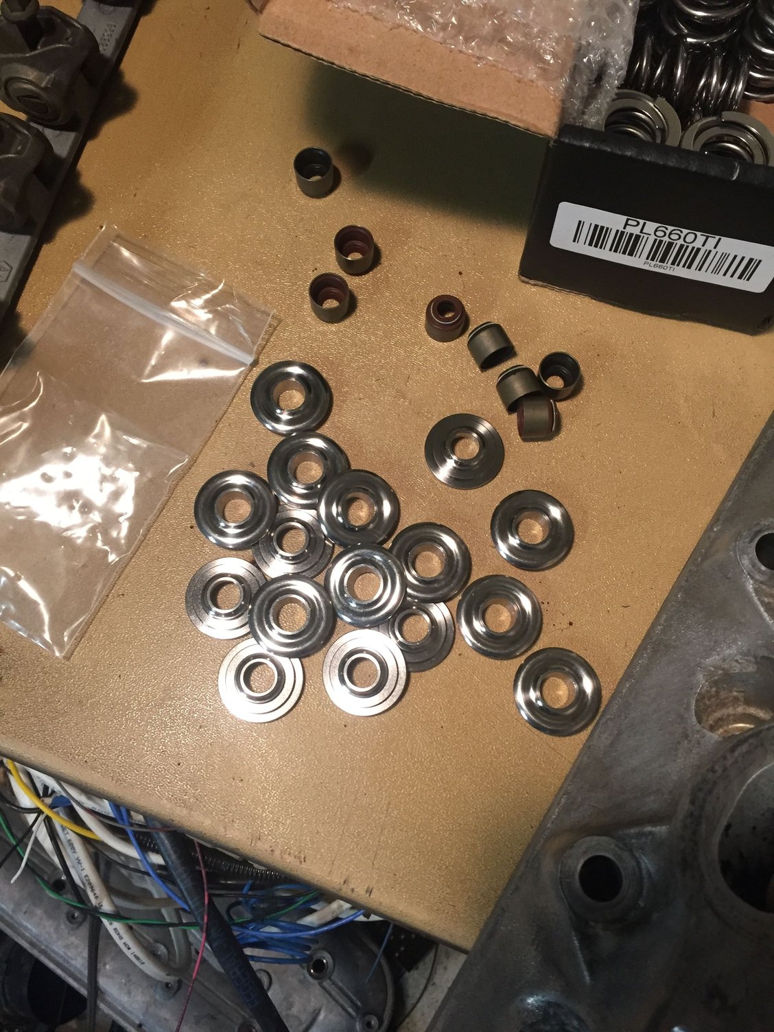

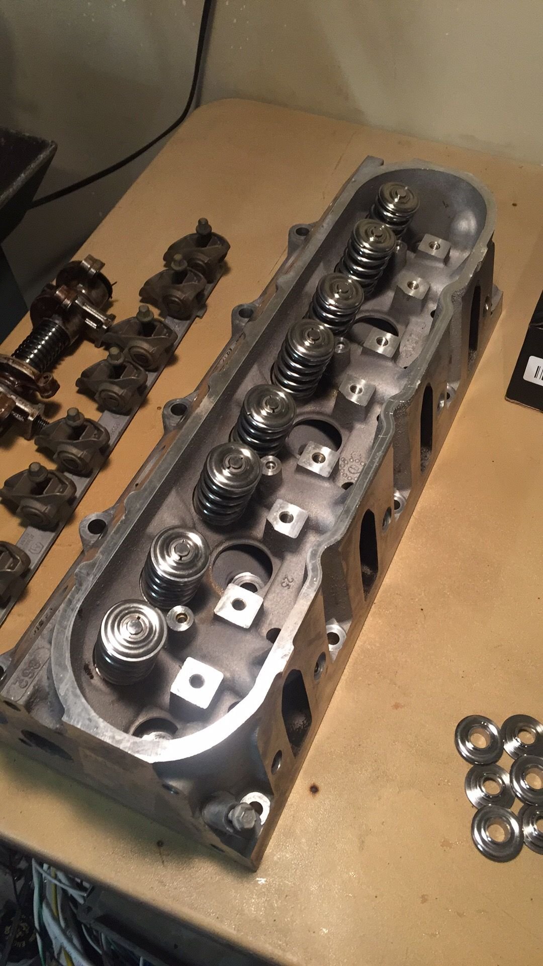

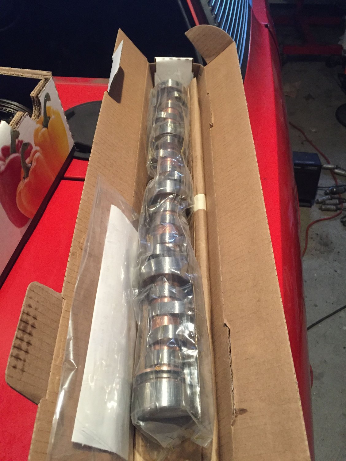

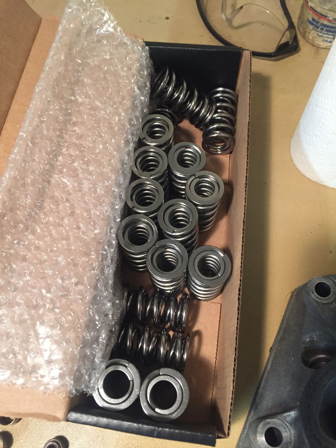

Got a whole wack of goodies. Martin Smallwood spec'd cam. Dual springs, titanium keepers. IWIS chain, chromoly pushrods, trunion upgrade, morel lifters. As well it getting new piston rings. Bearings look excellent.

Gotta love when a bunch of new parts get delivered. Whats the specs on the cam?
Old Dec 5, 2015 | 08:02 PM
  #93
parrisw's Avatar
Joined: Nov 2015
Posts: 171
Yes, big box from Summit too! More on the way! excited!
Cam specs are.
228/236 .612/.595 112+3

That looks like a well balanced, well thought out cam. I run a 227/236-112+3, and love it. Great blend of low end torque and high rpm power. It revs to 7K very easily

No not HP. said something about valve closing times to not hurt low end and whatnot.
