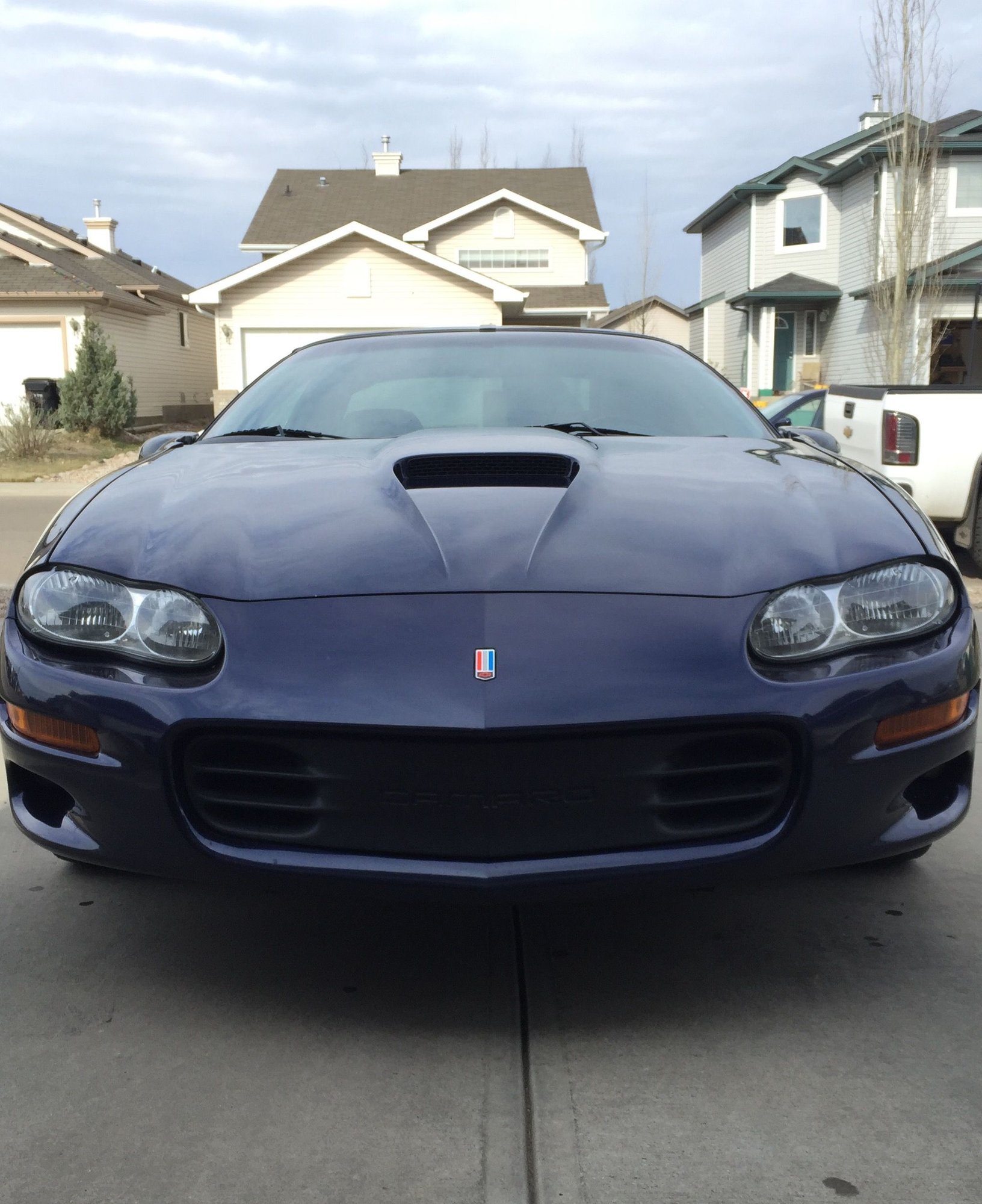

Here she is ready to go under the knife. Just gotta clean up the garage and pull her on to the ramps!!
