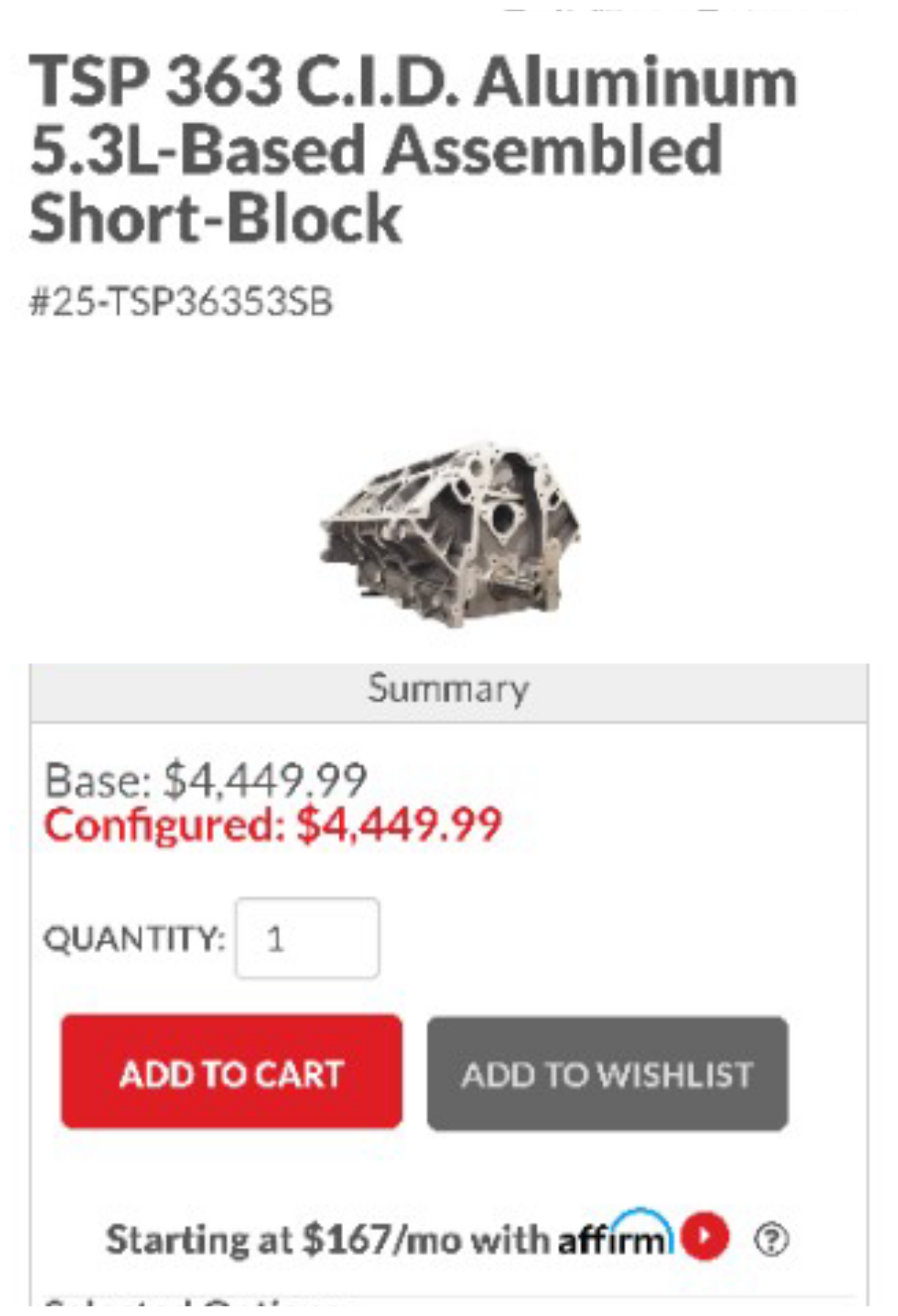

5.3L Shortblock from Texas Speed
I saw Texas Speed sales a Shortblock close to what I'm talking about building. I can build a close copy to that short block using my L33 block for about $2500 with the Eagle Stroker kit and Machine work.

And you can buy a junkyard 6.0 for a LOT less....
