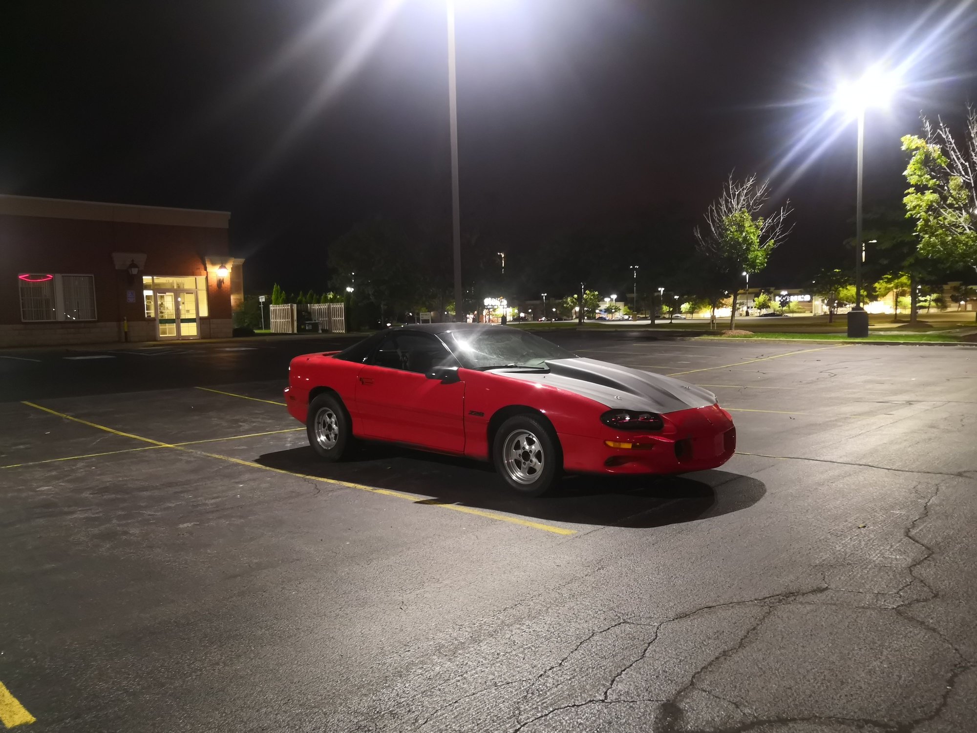

Post some pics up of your car man
Old Nov 13, 2019 | 09:29 PM
  #42
mindless's Avatar
Joined: Feb 2008
Posts: 74
Likes: 23
From: Arcade NY
I actually don't have a ton of pictures of the car but here's a few.

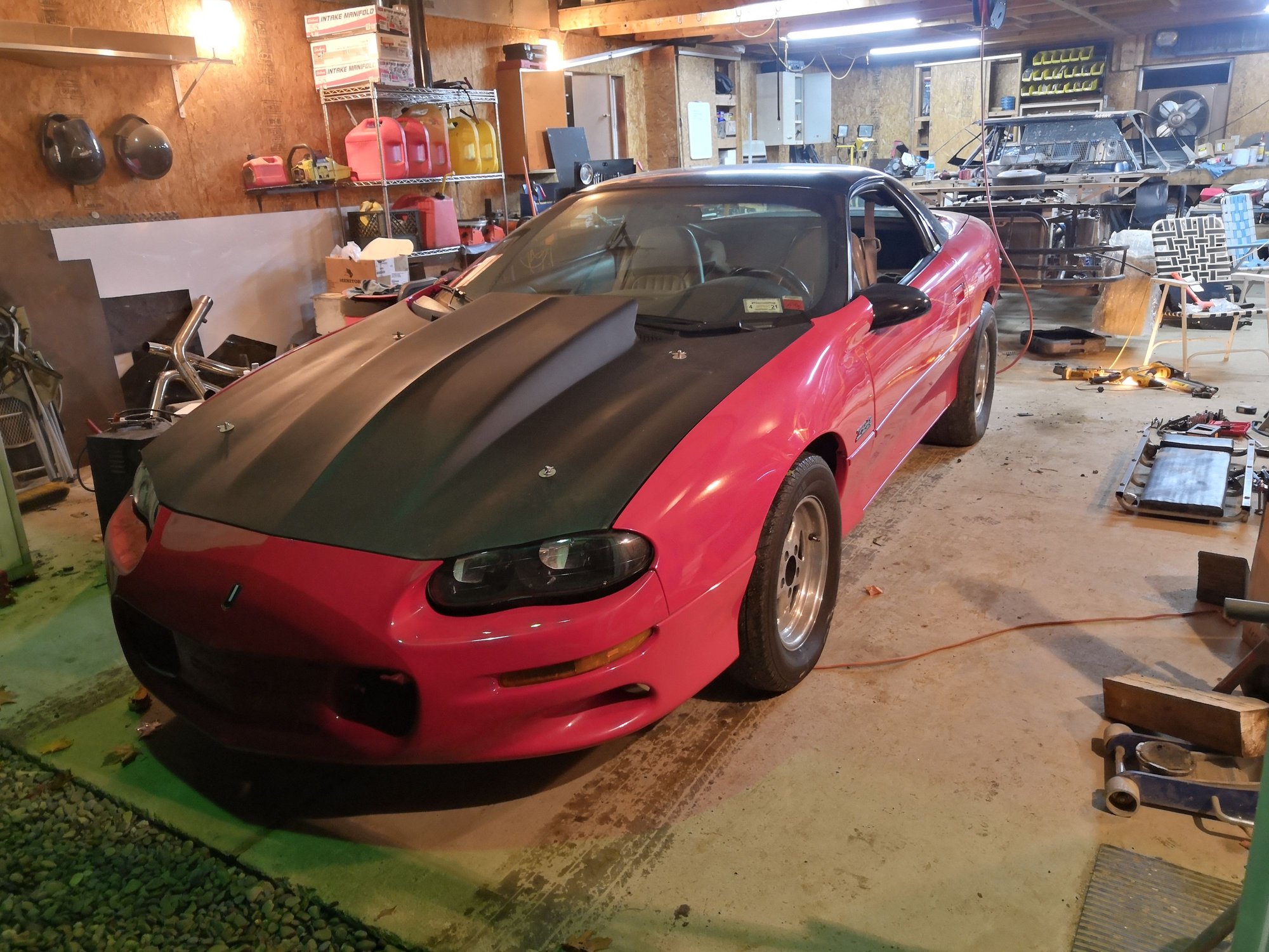

Old Mar 10, 2020 | 08:03 PM
  #59
mindless's Avatar
Joined: Feb 2008
Posts: 74
Likes: 23
From: Arcade NY
Got the car out of the shop finally and buzzed it down the street. All seems well, getting tuned on Monday. Honestly if this thing just idles when I'm done I'll be thrilled. Died 4 times trying to get back in the driveway LOL.
O and random track pic because why not!

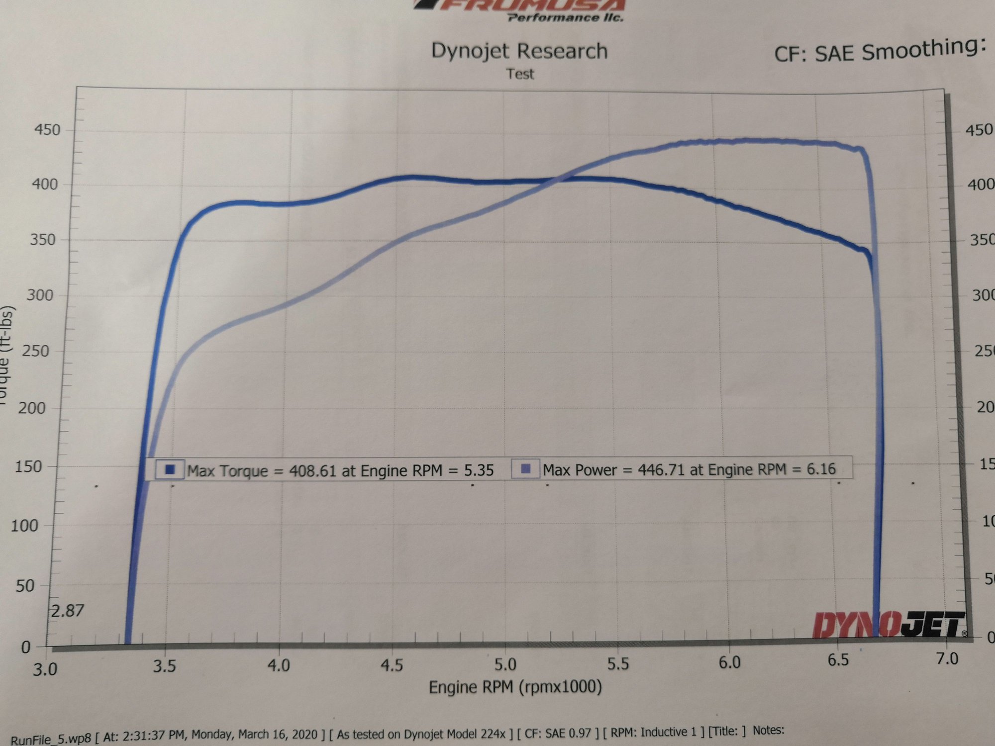

Old Mar 16, 2020 | 03:11 PM
  #60
mindless's Avatar
Joined: Feb 2008
Posts: 74
Likes: 23
From: Arcade NY
Happy to say we made some power!
