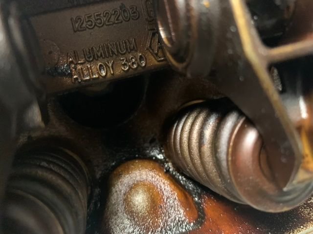

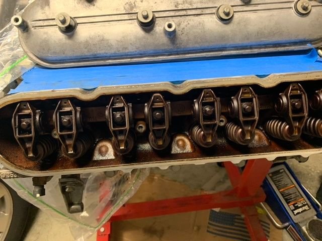

Honestly if it were me I would take that money your gonna dump on rebuilding the engine and put it towards a Holley terminator X system with transmission control.
Also from that picture it doesnt look very sludgy at all....???

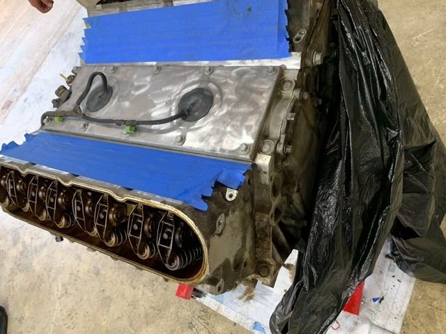

pulled the valve covers. Thoughts? That harness setup you recommended looks to be the ****. I’m calling them tomorrow to see what’s what.

That's a fairly clean engine. About what I'd expect for a 100k engine from someone who likely followed a 5000 mile OCI. If you just want a solid, reliable driver for the wife.........I don't even think I'd pop the heads off. Personally, I'd replace every seal/gasket/valve seal you can get to, maybe do an oil pump/o-ring while the pan is off, inspect timing set and all the rockers, then instal it and get it running. I'd then put a can of seafoam in it, idle it for a half hour, then let it set overnight and change the oil again the next morning and hand the keys to the boss. If you can, I'd pull all the rockers and shoot some air into each cylinder to check for seal, and leakdown. If that passes, clean it up, seal it up, and run it.
