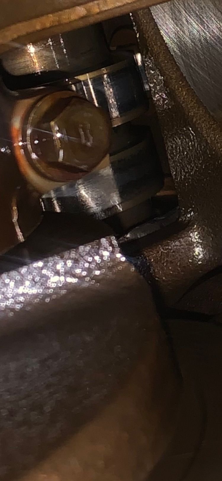

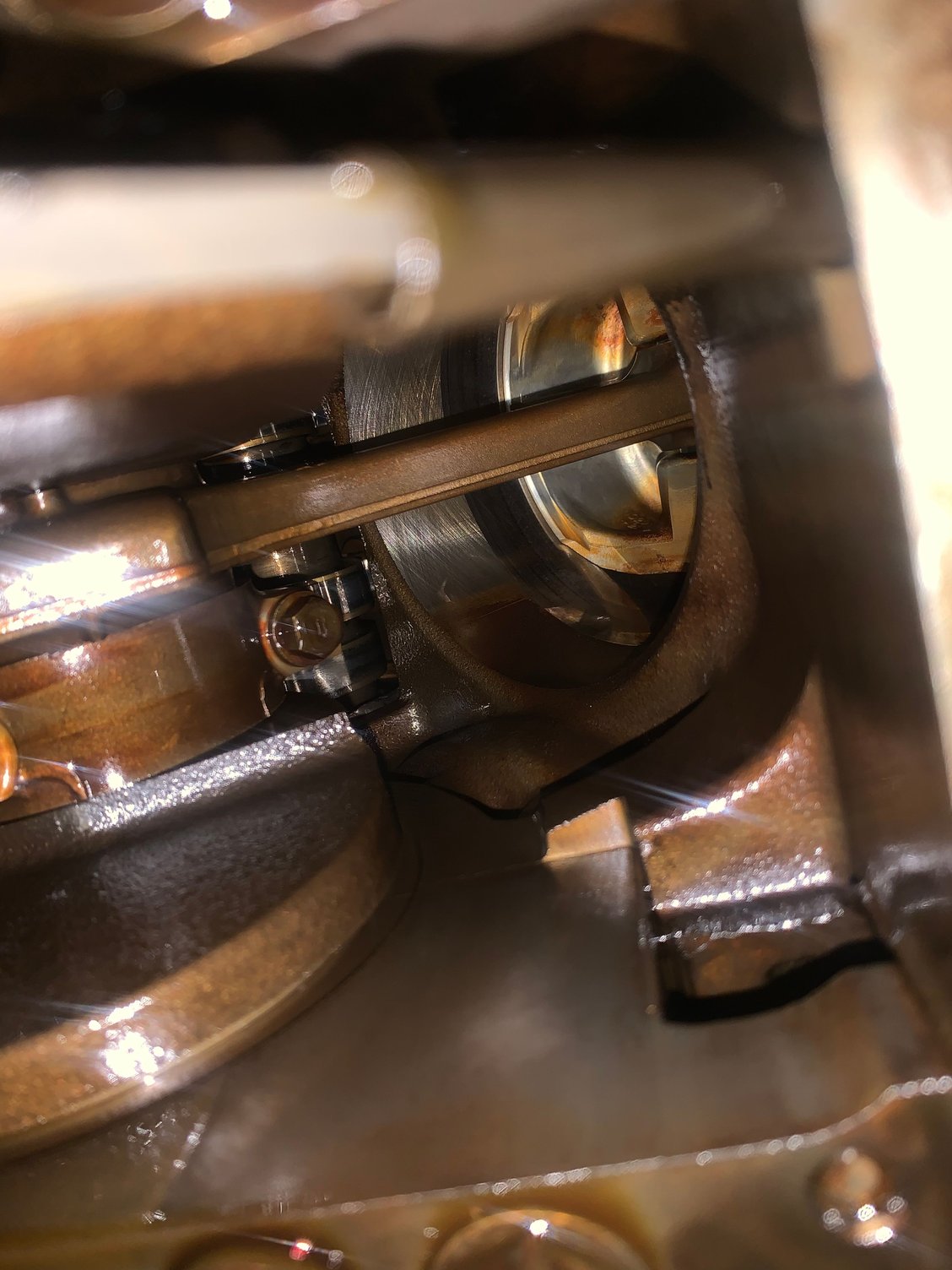

Old Jun 12, 2021 | 07:43 AM
jimmyg's Avatar
Joined: Jun 2014
Posts: 1,533
Likes: 12
Well ,put pump in . It’s basicly the same . Maybe 3-4 lbs more pressure . Looks like a cam bearing walked out . It’s still drivable . Gonna get another motor, drive it till she starts rapping.
