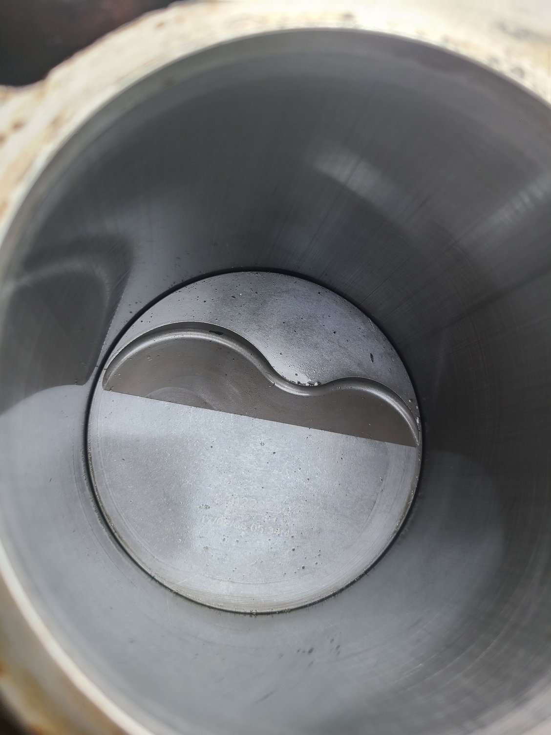

Does this cylinder look glazed?

Trying to figure out if the cylinder looks glazed this is the best pic I can get, I'll be rebuilding it with new rings but trying to figure out if this looks glazed.

If your throwing new rings at it, for sure run a dingleberry hone through it. Really doesn’t remove material and resets crosshatching for new rings to seat in with. Wouldn’t hurt to have a shop check it with a dial bore gauge…or yourself o you have one…for clearances, taper, etc.

Is it a stroker? I agree with chevelle. At least digleball hone. At least

yes it's a stroker. I think I'm just going to go a different route all together 5.3 turbo
