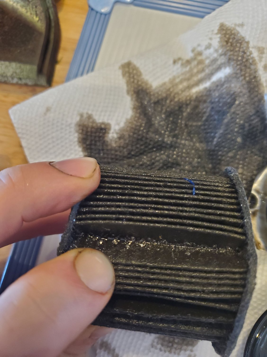

To try and make a long story short, tuner asked if the oil pump had been replaced during the H/C swamp (it had) because he noticed the oil presure gage tanked during his last WOT pull when he was finishing up the tune. Scared him a little so mentioned getting a mechanical gage to double check as soon as I could. He commented that you had to be really careful with an o-ring during the install of a new one.
Picked up the car yesterday and drove it home in a pretty solid rain (which I NEVER do) and noticed a random sqeak in the idle at the last few stops before home and then in the idle itself in the garage. Hoped it was just a result of the rain. Nothing squirly with the OP gage that I noticed. Did not drive it hard at all though.
Was finally dry this morning so was anxious to take it for a spin and noticed the minor squeak again after pulling out of the driveway but by the time i got out of my addition that had morphed into an awful "thwapping" kind of sound. Limped around the block back into my addition and popped the hood expecting to see a belt had come off and was smacking against something...not the case. Limped it back thru the addition to home with it wanting to die the whole time.
After talking to tuner, sending him a vid I took and pulling apart the oil filter and seeing shavings, he's pretty confident it spun a bearing. ☹

Originally Posted by madmike9396
man that really F!@#$%^ sucks and i hate to hear that. can you post a video here ?
Here's a pic of the filter. Unsuccessful in my first try at uploading a vid from my phone (mp4). Need to research exactly how to do that I guess.

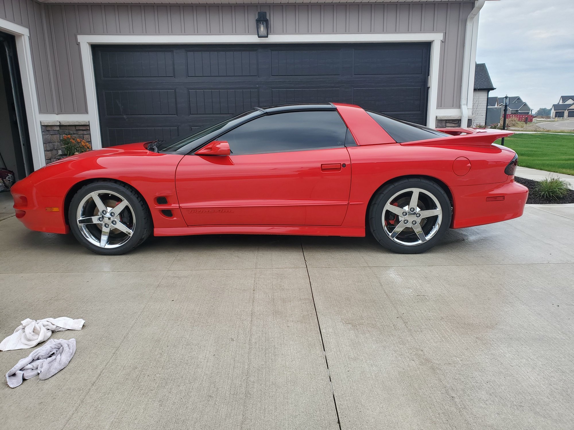

Anway, thanks to everyone for all the advice/feedback/support up to this point! Thought I should include a pic of the car just so everyone could see what I've been fighting for here. She really is a beauty @ only 29k miles. Probably should've left her alone!...

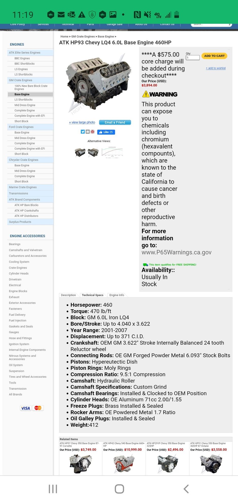

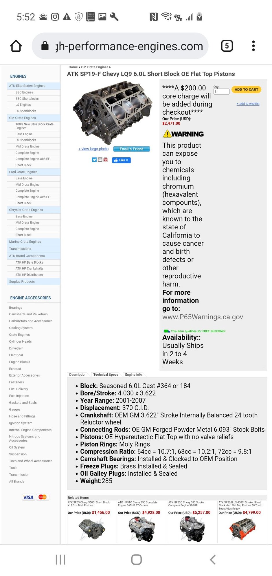

Wanted to get any intial feedback today regarding a couple potential alternatives to rebuilding the ls1. My dad has some close connections with ATK performance and looks like I could get ahold of either of the following options at a pretty substantial discount. I know at the retail prices they really don't make much sense but might be worth considering at the discounted rate. Just curious what opinions might be!

Do the short block and with money saved do some nice AFR or TF heads.
That seemed like the better option of the two. I have the basically brand new PRC stage 2.5 ls6 heads (assuming those didnt get fouled up) with the Tv2 cam from my build so initial thought was to just swap those over. Maybe??
