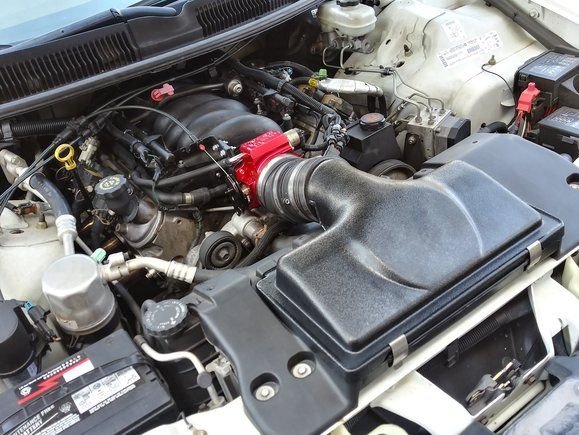

Took my trans down to RPM Trans to have them go all through it just to avoid any issues there moving foward. Fingers crossed it doesnt end up costing me the full blown level 5 rebuild cost!
That said, I THINK I'm pretty settled on sticking with the ls1 rebuild. Assuming my crank can be saved Im just debating whether or not to upgrade rods/pistons at this point. Will be replacing at least the one rod and looks like a decent new set could be had for $400-500. Pretty set on NOT going the forged route considering my existing power and any potential future power plans would likely never exceed the 550whp # that the trans will be rated for. Would it even be worth while upgrading if I don't go forged? Ws6store/RPM quoted around $400 for their HD pistons and rings and said they were more durable than stock.
Thoughts/suggestions?

FWIW - There's nothing I hate more than spending $$$ on cars and not upgrading for a little more money
If your in for a set of rods & pistons, spend the extra $700 to $800 for the 4 inch stroker crank.
While a 383 LS1 is worth ~ 5whp over a 346 LS1 with the same typical heads & cam package normally used, picking up ~40+ WTQ goes a LONG way in making a 383 LS1 far more fun to drive on the street than the hp numbers suggest. At least that's been my experience with H&C vs Stroker motors.
In anycase that stock LS6 intake isn't doing any favors. If you skip the stroker crank, at least pick up a Fast 92.
Of course you should do what works best for you. I'm just sharing my opinion based on dealing with same sort of issues previously.
Best wishes with project.

I'd re-build the LS1... no reason to spend money on new heads or a new camshaft as long as the TSP heads and cam have no damage. The CNC 2.5 243 heads have good flow numbers just a little less on the exhaust side than their popular aftermarket 225 as cast heads. I think your existing heads and cam choice is a great combo (myself) for a mild build.
With the money saved I'd go at least forged pistons and gap the rings for future ??? I read you might want to spray later on? Forged pistons will be more forgiving if the nitrous tune has a lean/rich issue that rears it's ugly head. Plus forged will allow more spray after the 100 shot thrill has worn off
I'd also think about buying HP Tuners and a wideband. This will allow you to work off your existing tune with little tweaks here and there. Your tuner can also e-mail you a new file after sending him a scanner log if needed. Buying HP Tuners was the best move I've made with my build. The learning curve is not that bad after you figure out 90% of the tables need no changing. You can tweak the transmission shift tables using the free "Bluecat" software getting the shift schedule (up down shifts lock up etc.) nailed down... the Bluecat software does 95% of the tables... copy/paste/flash... test drive!
HP Tuners also has a nifty tool called the "Gear/Tire Wizard" input the rear gear and tire size (you did mention your speedo is off)... bam speedo is dead on!

FWIW - WARR rocks IMHO
My 91 RS has a 92mm Nick Williams & 90mm TPIS snout LS6 intake manifold. My 02 Z28 has a 92mm WARR TB & 90mm TPIS snout LS6 intake manifold. My 99 T/A has the 102 NW.
Nick Williams 92mm TB some with the sensors installed for $389
The WARR 92 TB reused the sensors from the stock TB and cost ~$149.
Quality and driveability is identical from what I've experienced. Even the shop was happy with the WARR TB Quality. That's seldom true of most inexpensive TB's.

Those WARRs do look really nice and I was eyeing the red! May end up going that route if I can find a FAST. Depending on the feedback I get on my transmission, the Summit stroker kit might be an option. Performance gains for the money spent is a tough one but the added stength/longevity of the internals is the most appealing part.
