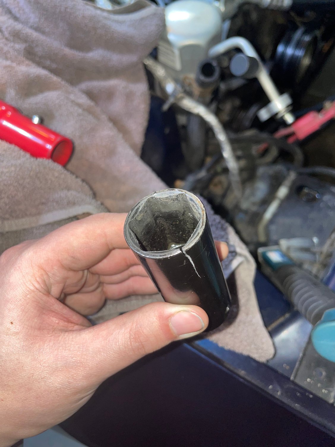

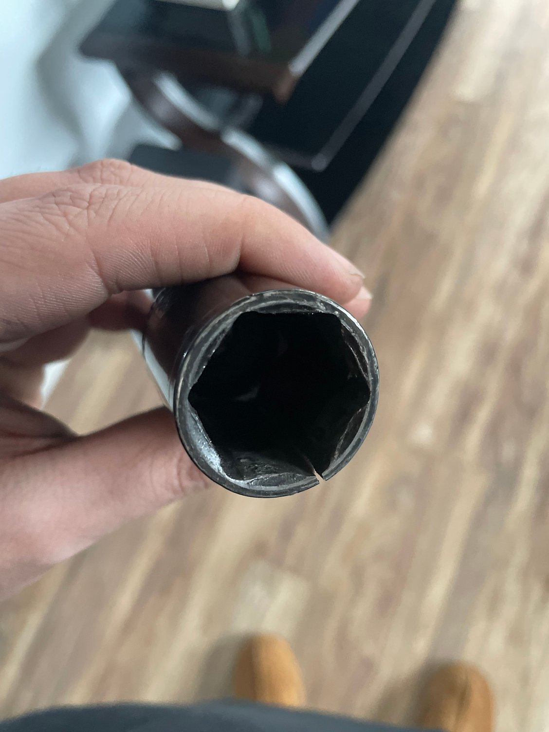

Having a hell of a hard time, it’s an M6 car and I’ve looked on the forums for answers but I can’t seem to get it, my electric impact keeps breaking 24mm sockets see pictures
and when I try and take a big breaker bar to
It, I put the car in 5th gear and it spins the rear wheels. I’m stumped

One thing you can try is to take a mapp torch and heat the bolt up, just to melt any crusted up antiseize (or possible loctite) on the threads. I have found sometimes a hot bolt will turn easier than a cold bolt, even though it expands. Another thing I have found is the best penetrating lubricant available is a 50/50 mix of ATF and Acetone. You might try mixing some up and shooting some in there, and it might soak into the boundary between the bolt, washer, and pulley, providing just enough relief to allow it to move.
You may end up needing to put it in sixth and have someone stand on the brake pedal with both feet AND the e-brake pulled up.
I will tell you one thing I did ONCE on a late 80's BMW. I put a thick steel plate on the ground and got my breaker bar braced on the ground at the 5:00 position when facing the front of the engine. THIS IS THE DRIVER'S SIDE. Then I disconnected the fuel pump fuse and bumped the starter. Engine rotates clockwise, and the breaker bar stays still, so the bolt backed out. DO NOT DO THIS. And if you decide to do it anyway DO NOT LINE UP THE BREAKER BAR AT 7:00 (passenger side) INSTEAD OF 5:00 (driver side) OR THE BAR WILL SMASH THE HELL OUT OF ANYTHING IN ITS WAY UNTIL IT HITS THE GROUND ON THE OTHER SIDE OF THE CAR. This includes any of the following items being potentially damaged: battery, radiator hoses, water pump, radiator, alternator, main fuse box, antilock brake module. You get the idea. If the bolt is REALLY-REALLY fused in place, the ear on the block the starter mounts to could crack. Bottom line, don't do this. i probably shouldn't have even posted it up....

Haha alright thanks man I’ll give the map torch a go first and see how it goes

On the M6s, I remove the oil filter and put the largest L-shaped allen I can fit in one of the free flywheel bolt holes and wedge it against the block. Then use a 1/2" drive ratchet and my low profile jack handles for leverage, making sure the socket stays square on the crank bolt.

May also need to use a higher quality socket or a 3/4 drive if you keep breaking 1/2 drive sockets.

Buy a better socket...

Gonna need much better sockets. Put it in 6th, pull the ebrake and have someone press the brake pedal. Gonna need a good, long breaker bar and cheater pipe. Spray some penetrating oil and let it sit. Use some heat. If you have access to a lift, lift it up and use the breaker bar and cheater pipe from the bottom. Good luck

Map gas did the trick

And yeah they weren’t the best quality sockets in the world but I’m just starting out so they work for now, it was a husky lmfao

Try 6th gear, with parking brake engaged. Also, what brand sockets are you breaking?? I know Craftsman has slipped a bit in quality since Sears sold them. Have you tried a Commercial grade, like Williams or Snap On? Either should do the job......
