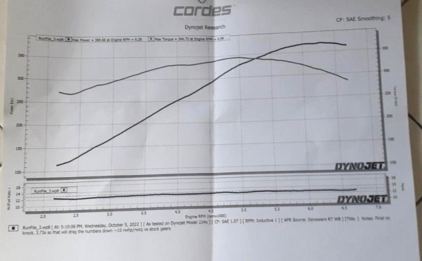

Auto car/3600 stall/ 3.73 gears/ torquer v2 only made 369rwhp 344ft lbs on a dyno jet. Something has to be off, I was expecting close to if not 400. Tuner is the go to for these cars in town and said he thinks the heads aren’t doing much. I am running stock size rods and K1810-3903 pistons. Heads are 62cc and will attach photo of specs. Using stock gm head gaskets.

To address everything the converter was locked when they did the pulll. I had to shave a little bit of the bump stop on the throttlebody to get the TPS to read 100% the tuner said everything was fine when he was tuning it. There is no baseline tune because I ran a tune from frost before I got it dyno tuned. It has 373 gears and LS6 intake stock throttlebody stock math and an SLP airbox

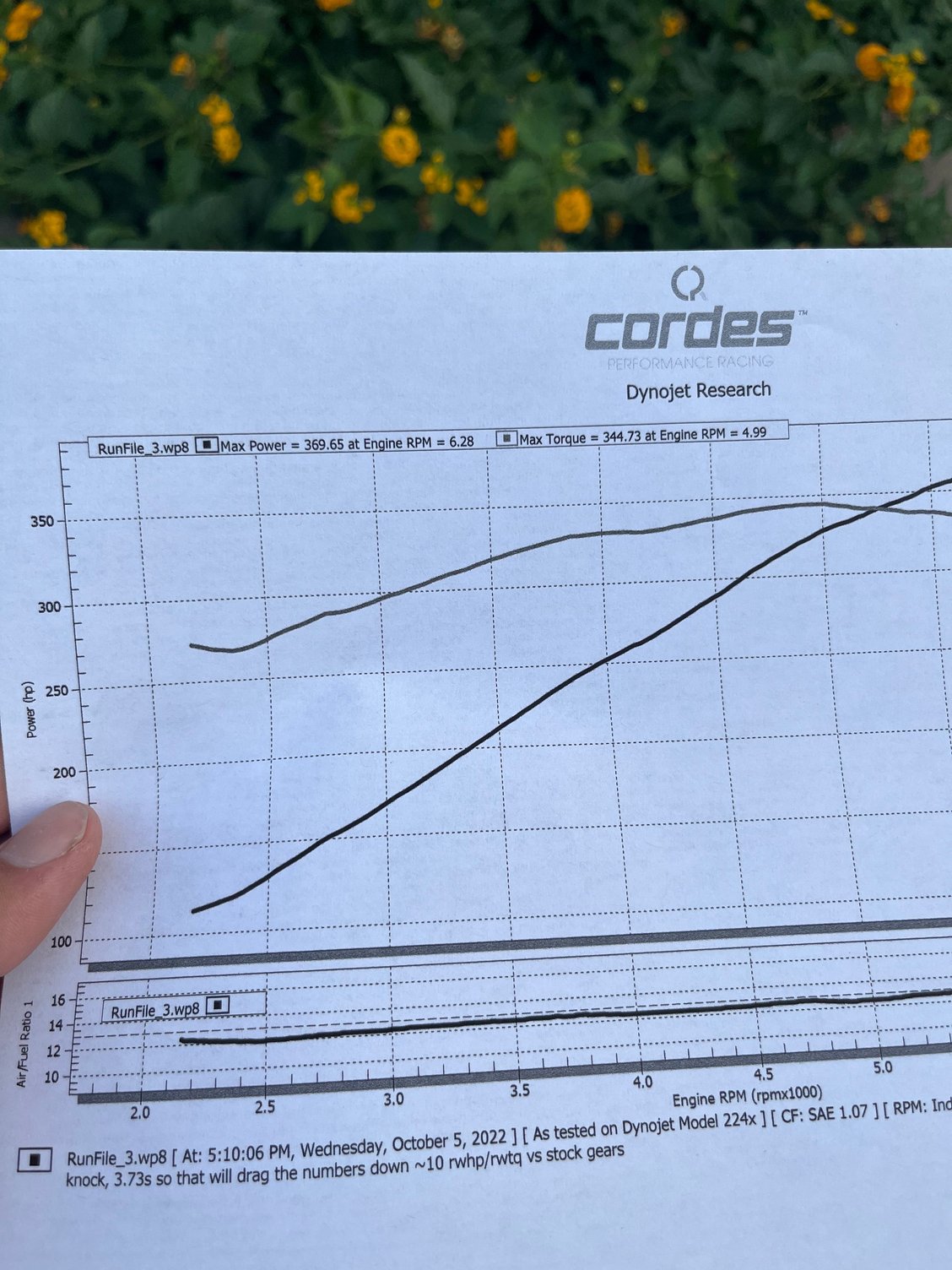

What does the rest of the graph look like? Can't tell anything by looking at the first 1/2 of it.
Old Oct 7, 2022 | 03:51 PM
Josh higbee's Avatar
Joined: Jun 2019
Posts: 58

The graph looks really good IMO.
Have you started with the basics? Compression test? Etc?
What do the plugs look like?
