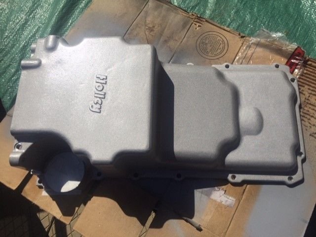

Also What king of oil pan do I need? I have one from a 2000 truck but I have heard it will not fit.

The stock oil pump and spring will be fine for your situation.
The truck pan hangs down quite a ways, likely below the crossmember, which you do NOT want to happen.
An F body pan will work for you.

fbody pan will not fit unmodified. Either pan or sub frame need modified to run a fbody pan. There are pans that fit if you search the swap forum. Last I remeber Lostar had some nice cheaper swap pans.

Sorry, I thought I read on here the Fbody pan would fit. I might have been thinking of the 302-2 ($$$$)Holley oil pan.

I used this aftermarket pan from Holley for my 1st gen with no issues.
https://www.holley.com/products/engi...ns/parts/302-2
There is one on ebay that looks similar but I can't verify fitment. It's all made in China anyway.
https://www.ebay.com/itm/264226291573#vi-desc-maincntr
There is also another pan that Holley makes for stroker LS engines- 302-3
I would just get a new oil pump, they're roughly around 100.00.

I Used the Holley 302-3 on my Chevelle, specs show it fits 1st gens too. nice pan but $$$. The -3 clears a 4" crank if you ever decide to take the LQ4 to 408cid and has turbo drains built in. I heard there is a -4 coming that slightly cheaper and doesn't have turbo drains but it the same casting as the -3

Holley pan and don’t try to cheap out on a lookalike.
I used a 302-3 fit is perfect.

I went ahead and ordered the 302-3. I dont have a turbo right now but hey you never know.
