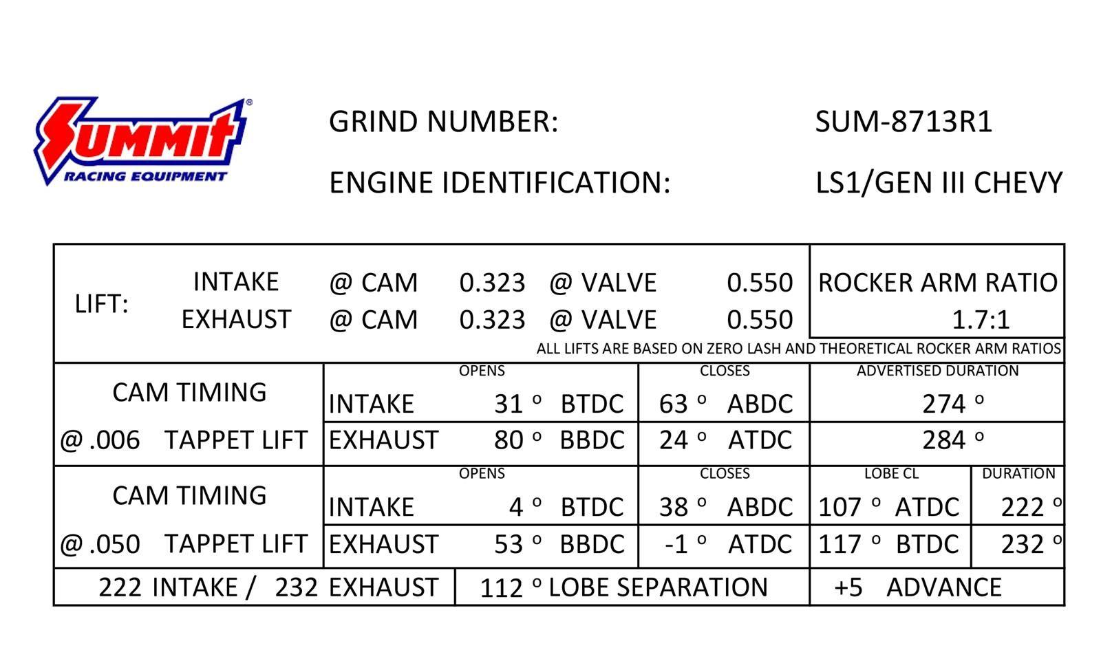

I'm looking at the Summit pro LS 8713 cam because it's what they use in their 450hp crate engine. Their crate engine is identical to what I have in my 2002 blazer.
It has a 5.3 LMG 24x 243 heads, flat top pistons, 33 lb injectors, full 2 1/2 exhaust. 4L60E with a 3000 converter, 3.42 rear and 27.5 tires.
I guess with the 8713 cam I'd have basically their crate engine. BUT I'm wondering what kind of hp it's putting out now and if it would be worth the swap. Right now it has their 8719 cam.
What do you guys think?

What do you do with the vehicle? what kinda driving?
If it were me Id make the cam change a little more worth it and go with something like the 8707 if your valve springs are good enough and since you already have a 3000 stall, but I like my stuff a little more rowdy.
Everything you gain from the 8713 over the 8719 up top would be lost down low, but your stall would push you passed most of the low rpm loss.

I wonder what I'd gain with this swap. I drive it normally but want it to be faster when I get on it.
I did have this same engine in an s10 and put a 8708 cam in it along with a tbss type intake and 92mm tb.
It tuned good and ran strong but wanted to rev to 7200+ to get peak power.
Now I have a 6.0 LFA in the s10 with the 8706 cam. It's a little milder but the power is usable.
With this blazer and the 5.3 I just want it to be faster. If it picked up more power around 3500 to 6500 it would be good. And these two cams require the same springs so I'd only have to change the cam.
I'm just curious what it might be making now power wise since they claim 450hp with the 8713.
And my tuning is perfect right now so I really don't want to retune for a new cam unless there's 50hp to gain or more. With the cam swap.
I also have another tbss intake and 92mm tb to put on it if it'll help. I know as it is now with the 8719 cam it nakes moee power with the stock intake and tb.

No way your gonna gain 50hp
maybe 25
check out Richard holdner on YouTube if you haven’t already, search for truck cam test he has done some with similar specs to what you have now and what your looking to swap to.

That answers my question. 25hp gain if I'm lucky. Not worth it.
I'm looking to get away from the 5.3 anyway.
Thanks for the help.

The 5.3 is a good engine, imho. But with only the same lift as the OEM LS6 cam, a bit more duration, and a tighter LSA, you can't expect big gains. With those duration figures, all you need is a bit more lift. If it was me, and again, mho, I'd go with .570"-.580" lift, maybe 224°/228° duration on a 113°-114° LSA. You have the 3,000 stall converter. Maybe I'm a bit more aggressive than some, as the other guy posted he was rowdy!!

I'd guesstimate your current set up is ~420 flywheel hp vs Summit crate being ~450 flywheel hp.
I agree with the others definitely not going to gain 50 hp with that cam swap. Maybe ~25 to 30 fly wheel max.

The way they "cheat" cam power numbers is you test the stock engine, then install the headers with the stock cam and gain a few HP, then replace the cam and it looks like that new cam is the greatest thing ever but it wouldn't have had half the gain without the headers.
