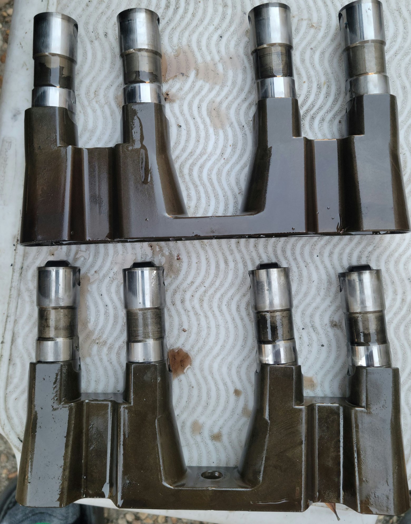

I dont see any noticeable damage anywhere, only thing i do notice is that the lifters are very loose in the trays. They fall right out of the trays

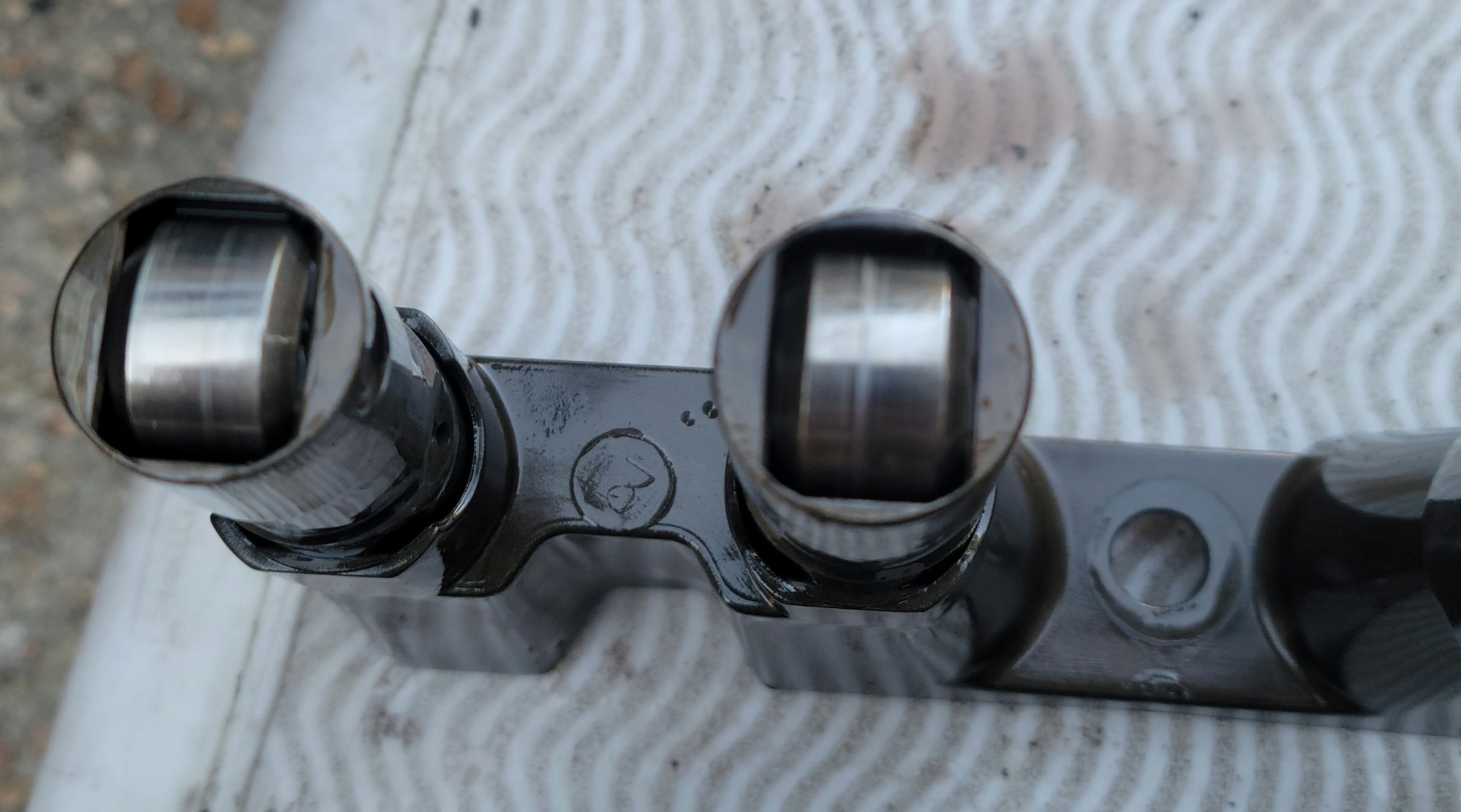

Slightly scratched, nothing drastic

Old Mar 5, 2023 | 08:23 PM
  #39
Posts: 7,828
Likes: 5,176
The trays should hold the lifters so snugly, that the lifters won’t fall out of them when removed, even in a 150k mile engine. You should try and find a new set of GM lifter trays. Don’t settle for aftermarket trays, as they aren’t made from the same product, and will wear quickly. The loose trays will allow the lifters to turn (instead of running exactly square) a tad on the cam lobe. This will cause lobe and wheel scarring at a minimum from the heat that is produced, from not staying square on the lobe. Looks to me from your pics, that this is your exact issue.
hopefully so, I ordered the trays and lifters from summit. I figured they would sell me quality parts.
when I picked up the trays none of the lifters came out. I had to use a magnet to remove them from the block.
