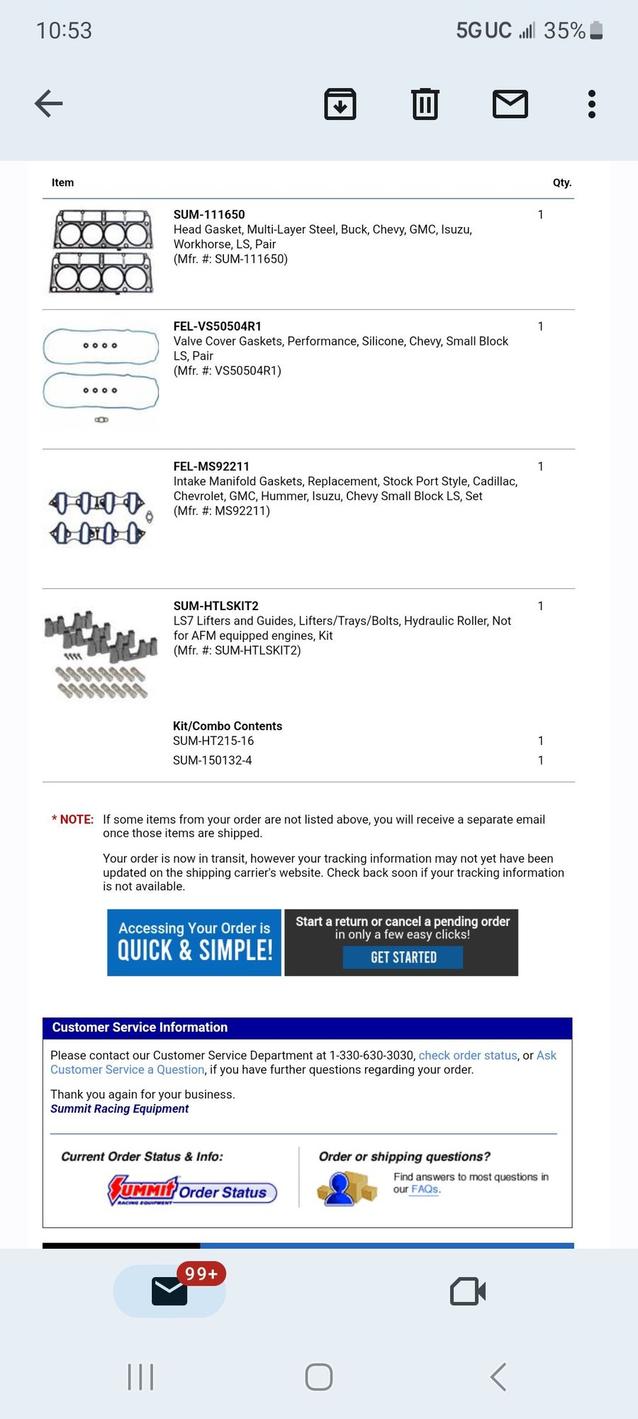

Originally Posted by Tommy42088
Those aren't GM lifter trays. I bought those and I got some generic crap.
These are GM lifter trays
https://www.summitracing.com/parts/n...5365?rrec=true

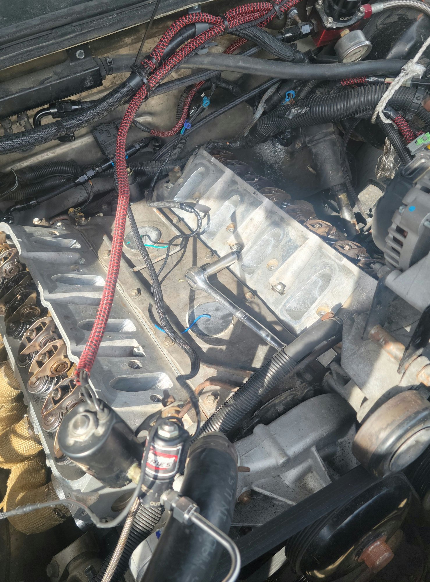

Update, definitely was the springs. Truck has dual springs and the inner springs were broken because apparently the stock retainers were used and it caused the inner springs to break. I dropped the heads off at a machine shop and they called me this morning and told me this.

I was a little suspicious that it was coming from there because that's where the sound was coming from with the borescope and the machine shop confirmed it once they pulled it apart. Hopefully once I put everything together it's all good. I found a few loose bolts and also a few broken exhaust bolts too so I'll fix all that while I'm at
