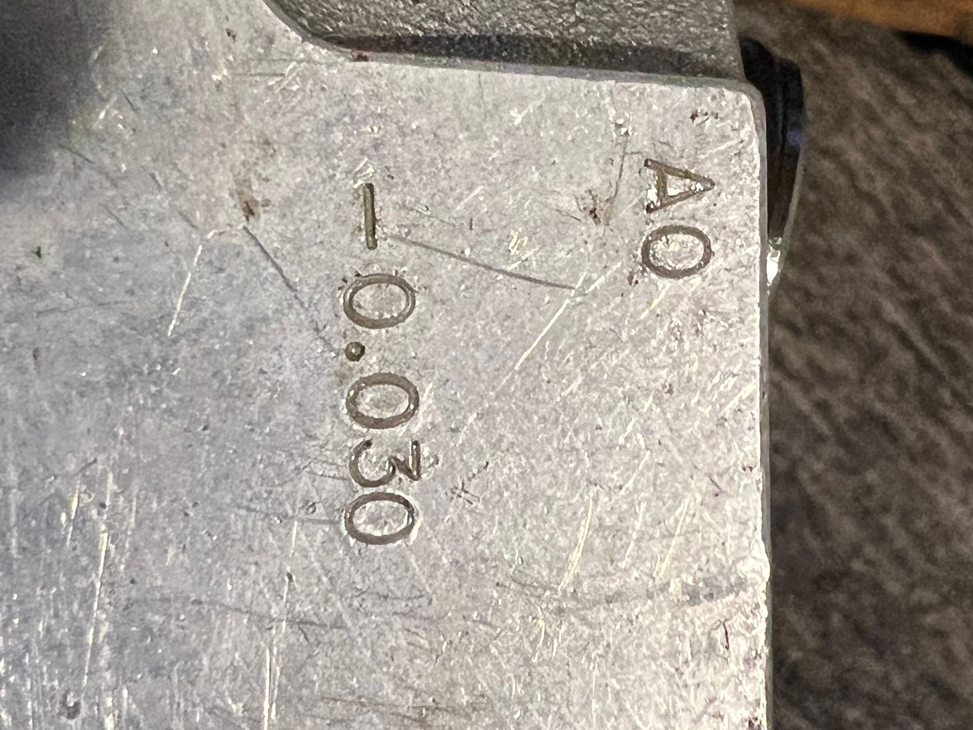

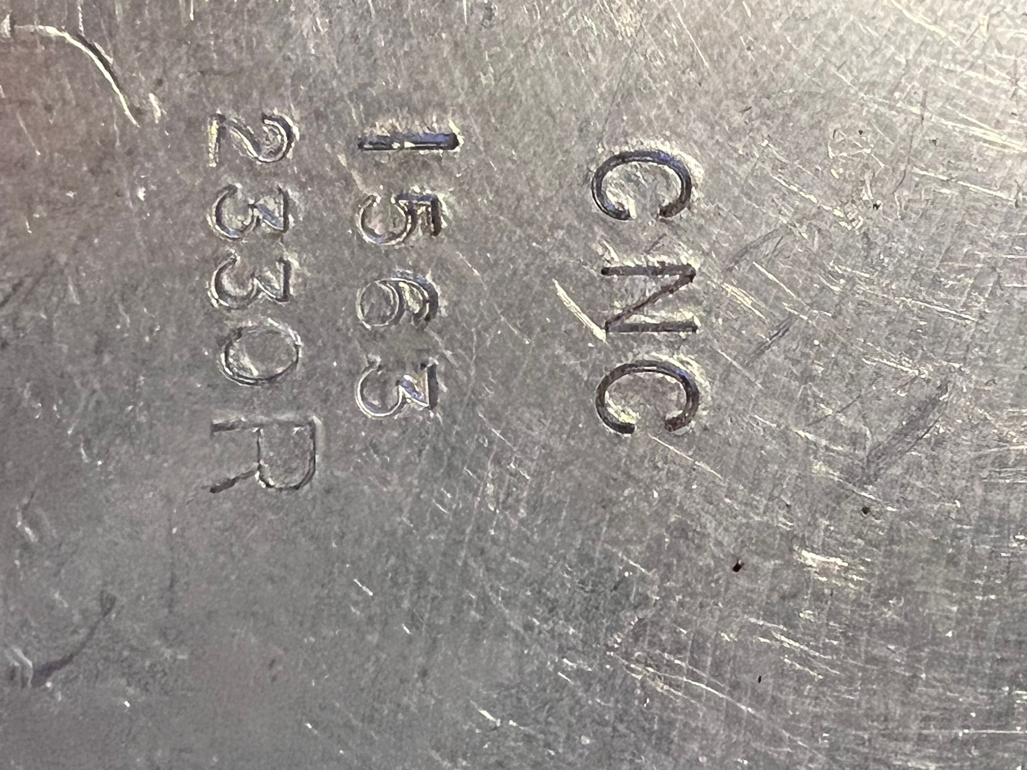

Ls1, obviously you or someone before you had them milled, port n polished and the shop who did it stamped the heads

Agree some one re-stamped.

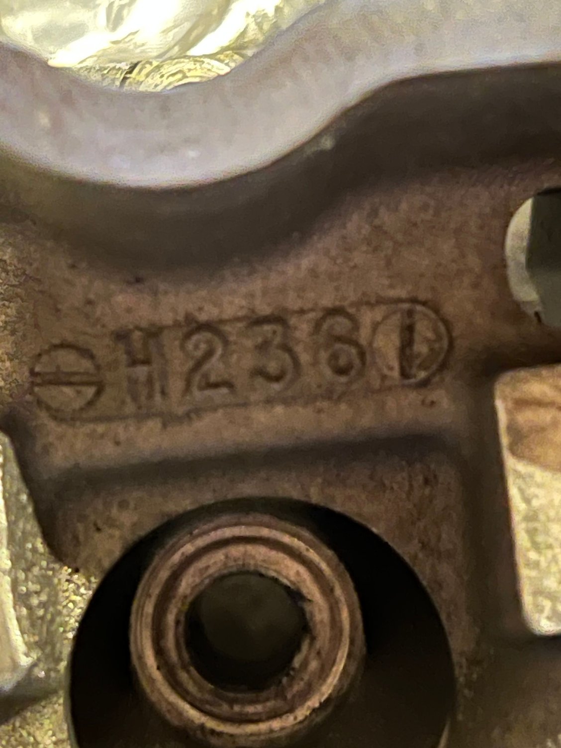

You showed us 2 casting date codes and one stamping from a machine shop.
Can't tell for sure if they're both aluminum or what.
What are the casting numbers? That's the most important thing.
The date codes though, since the 2nd one is from a year ending in 6 month H (the 8th, Aug), is almost certainly an early LS1 head, as in, off a 97 Vette. The 1st, cast in month K (the 11th, Nov) of a year ending in 3, is probably a later model LS1 casting; although, it could be a 4.8/5.3, LQ4, LQ9, etc.

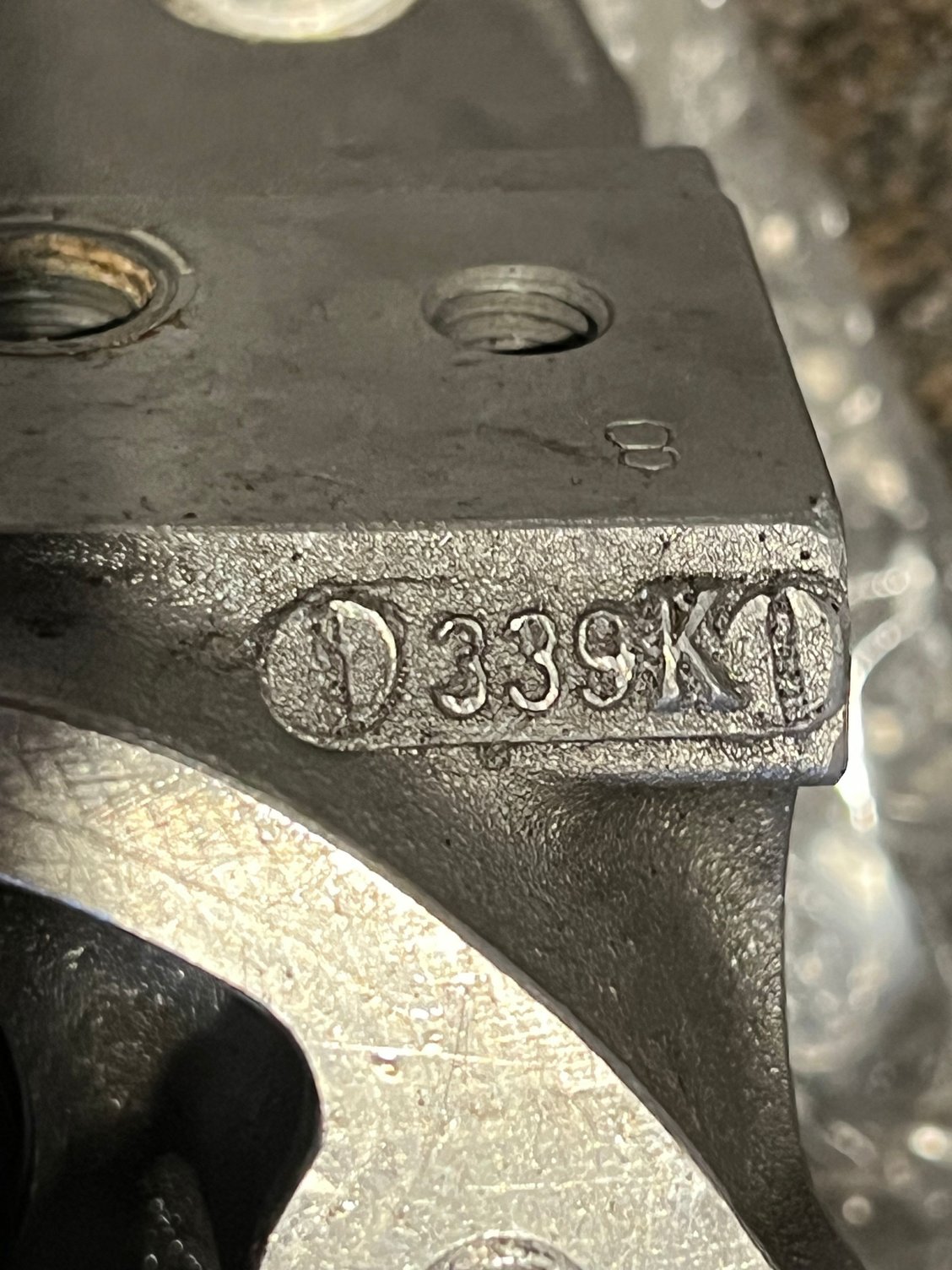

What are the CASTING NUMBERS? We can't tell you DIDDLY without that.

There just early LS1 heads like an 806 Likely from a 97 corvette based on the date code. Looks like they may have been milled .030 based on the stamps. The other numbers are likely a Job number from what ever shop as well as maybe a Part number for the porting package.
The GM number should be 10215339 according to the Ebay Ad

New one here for me personally. I’ve never seen a 339 casting head. I’d wager that the general didn’t make a zillion of these.

Looks like they are specific to the first 2 years of production. Most people don't keep that stuff when upgrading. Maybe some of the purest corvette guys keep it....

Me too, not that I have nearly the cred most guys here have. It's rare enough that I could not find it in the Summit LS database.
What are the specs on it? Chamber volume, valve diameters, port volumes, valve pocket size...... all the nittygritty.

very early heads from when gm was changing a lot of things on the ls1. should be same as 806 head, just different foundry. lists as a 1997 only casting
10215339 – LS Small Block V8 1997 346, LS1, aluminum, 68cc chambers
