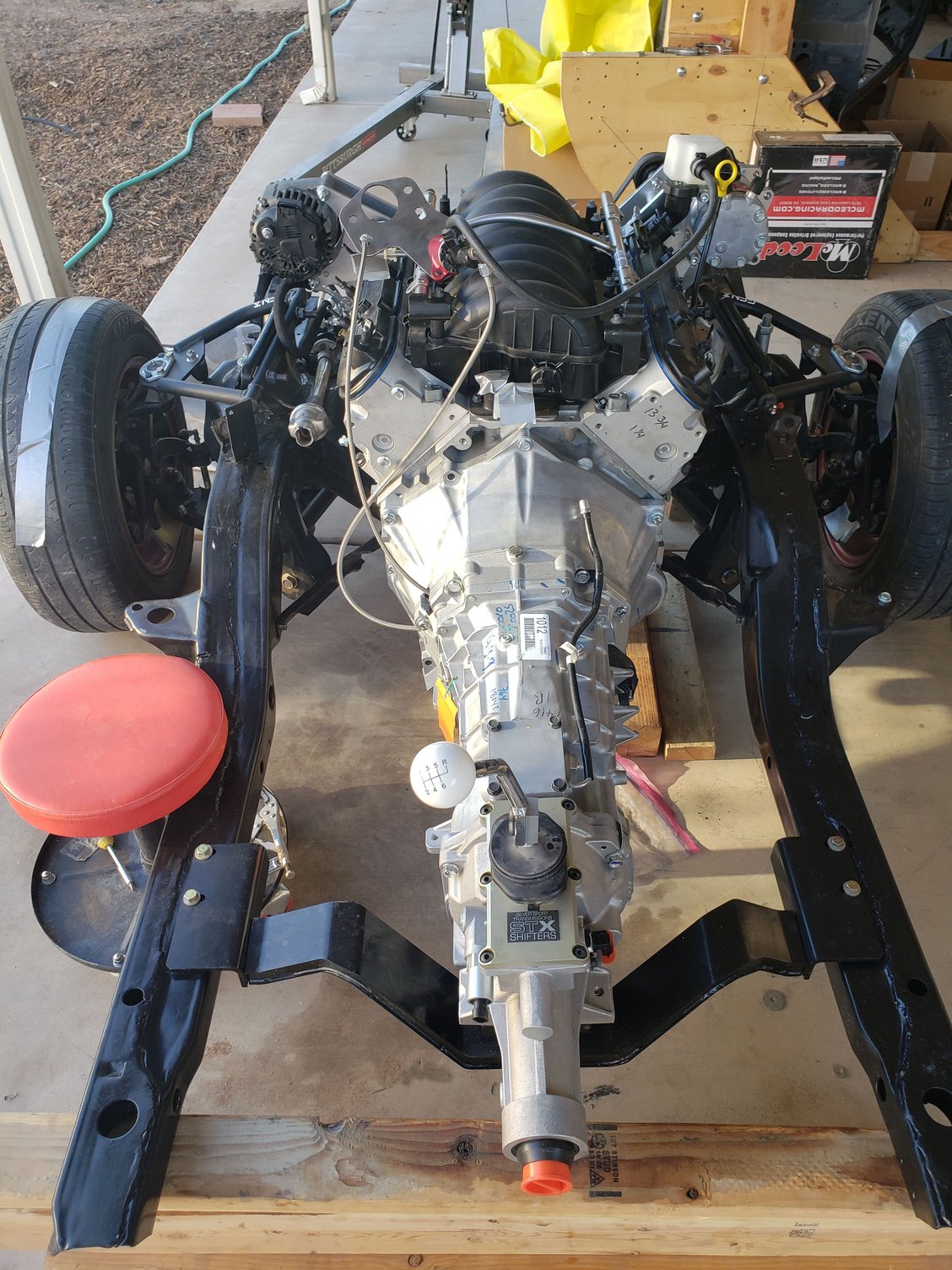

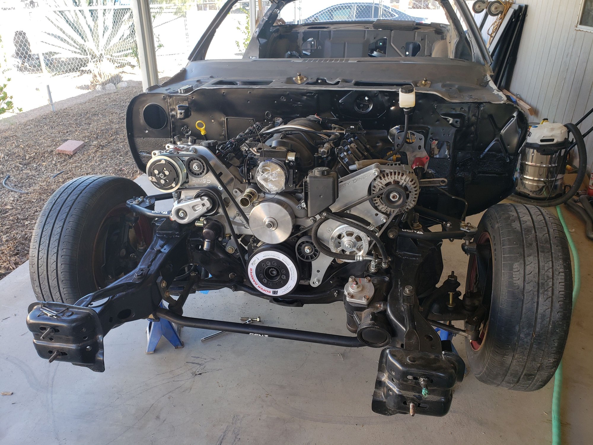

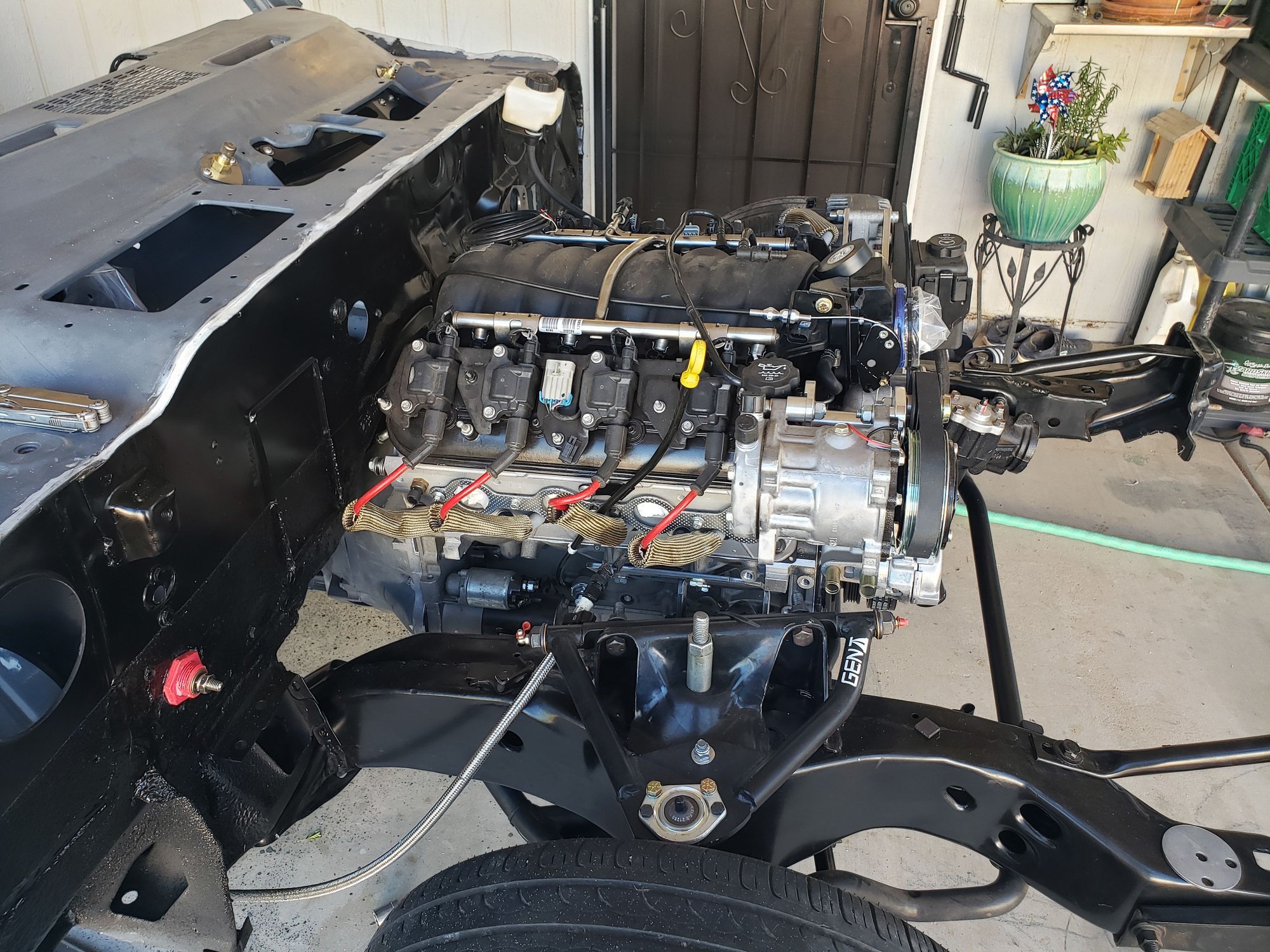

I'm a little farther along than this right now but these are the most recent. Upgrades include: Tremec T-56 with 2.97 1st gear and .5:1 6th, Eaton Detroit TruTrac w/Richmond 3:42 gears, 180 Lb leaf springs, Eibach shocks all 4 corners, Added rear sway bar rear, huge one up front, Poly body bushings, 4 wheel 12" disks brakes w/Wilwood calipers, 9""dual diaphram, new tubular upper and lower control arms to achieve 5 plus degrees caster. Car will also get cruise control, Raingear wiper upgrade, Dakota Digital gage set and a decent sound system. More pics to come!
