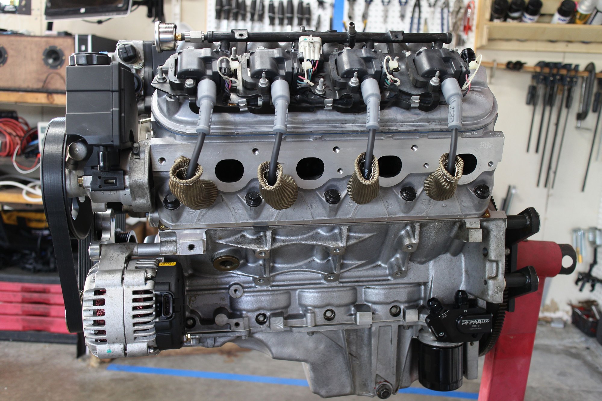

Is my LS1 a dead end power wise?It has a mild cam, exhaust and a tune. Makes 381rwhp.
I want to get my track car up to 450rwhp because my car is too slow on corner exits and on the straights.
But I can't put together a parts list that make any sense price wise.Dyno Tune:$800CNC 243 heads:$1,300 (or similar heads)Head gaskets:$100Camshaft:$400Fuel rails:$200injectors:$400So around $3,300
I've gotten a few $4,500 offers for my LS1.Would it make sense to sell the LS1 and start with something else?$7,800 seems like L92/L94 money to me.A 24x/1x swap and I could use a gen4 LS.

That also included the standalone harness, the ECU, and the tune inside.
So that's about $1,500 for those 3 alone
So $3,000 for a running LS1 that makes ok ish power is a pretty good deal.
Junkyard LS1 takeouts up here are $2750+ unfortunately.
