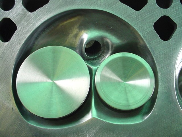

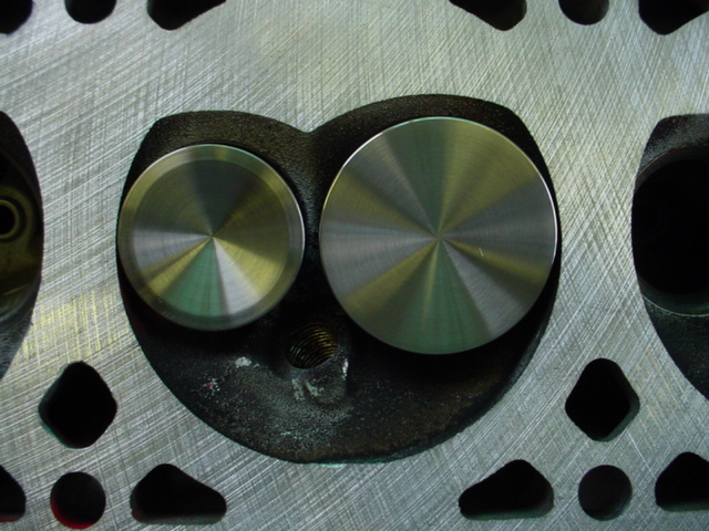

Just for chits and giggles, here's pictures of a stock 5.3 chamber w/2.02 1.57 valves and my ported/polished chamber. This give you an idea of how much work is involved.....and how many cc can be added to the chambers.
Stock 5.3 Chamber
Ported/Polished 5.3
The valves are open around .300-.400 where they tend to be shrouded. If the links don't work, copy and paste into window.
