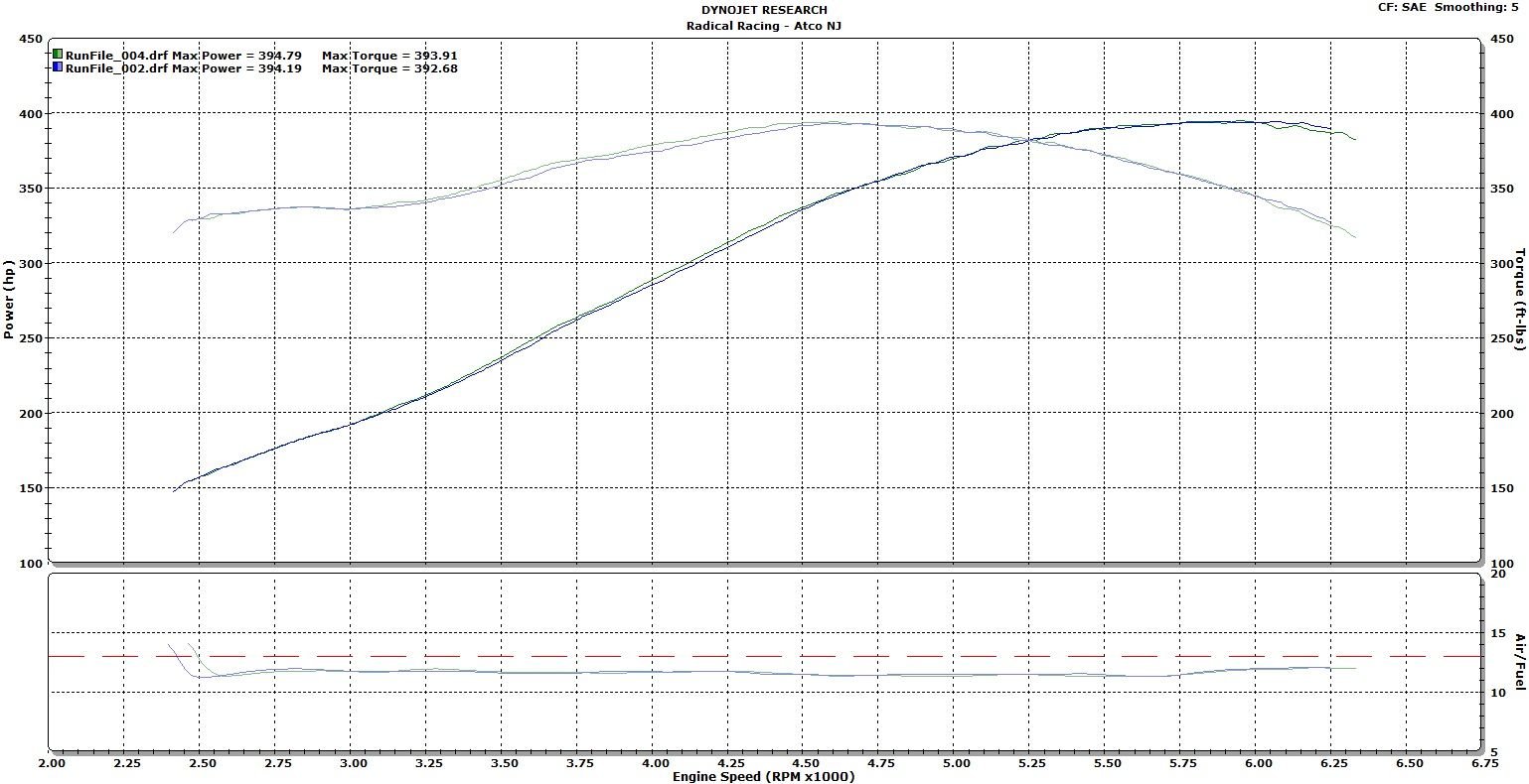

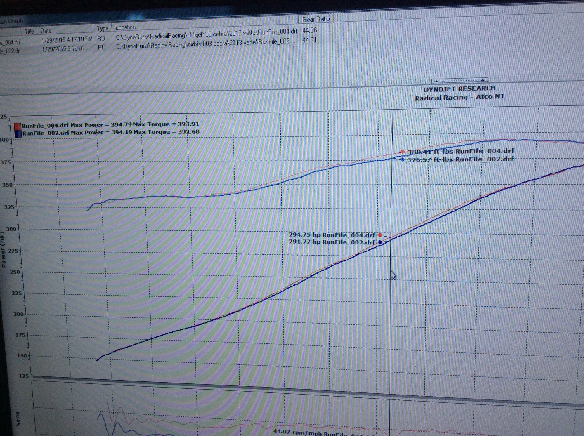

Ok.. My vette was reading a little high I believe as the car made 394rwhp corrected bone stock. It's the same dyno I have been using on all my past cars and my t/a made 448 on this dyno and trapped 120mph, and my c5 made 330rwhp and trapped 110 in the 1/4. So the first 2 passes were 393hp/393, and 394/393.. Wife the new wires, and the car warmed up the next 2 passes were 394/393, and 394/394 tq.. So pretty much 0 peak gain. Where I did gain was in the more important mid range. From 3000-4500RPMS I saw anywhere from a 1-5hp gain, and the same with the tq. The lines were also smoother and the car idles much better as well. I didn't get a 10rwhp gain as advertised, but compared to stock wires I got a smoother running car, and picked up in the mid range power. A 5 rwhp gain throughout the mid range for 130.00, isn't to shabby.
I will say that the wires were a pita to install as on a couple coil packs pushed the metal inside the wire up into the insulation. We had to push the wire back out enough so it would snap onto the coil pack. Very annoying and took more time to swap because of this.
Overall I am happy with the wires, and may purchase 2 more sets for my other LS cars.
Blue line is the stock wires, red is the new wires.

Blue is stock, green is the Granatelli.
