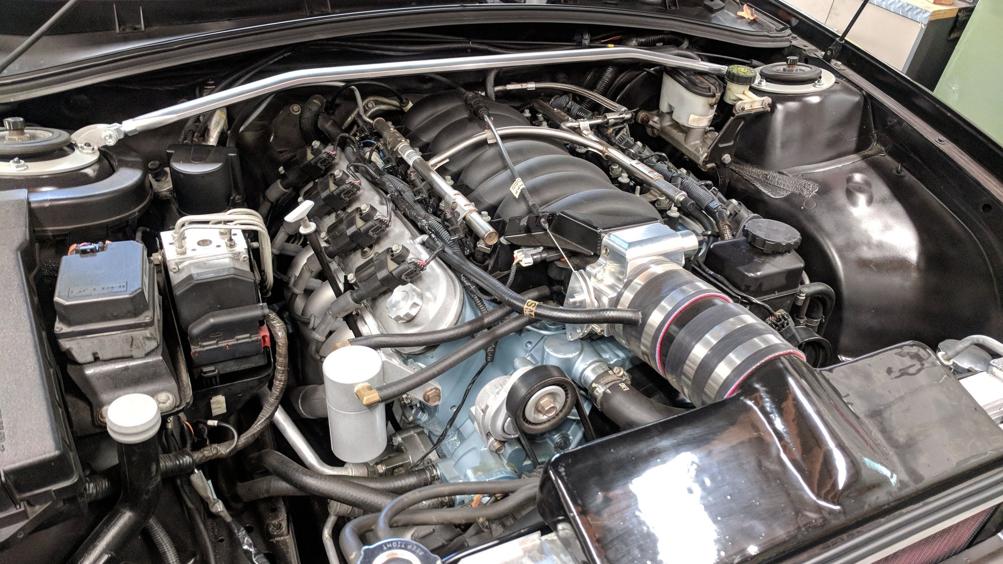

Duplicolor self-etching primer and their engine enamel. My aluminum block has been painted since 2012 and still looks great.

engine does look great. How many miles did you put on it though?
I have about 10-15k on the motor.
