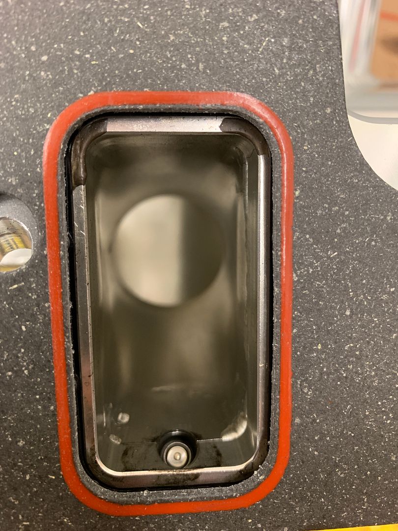

So i am waiting on a couple parts to finish engine assembly and i was thinking about port matching the heads and intake manifold.
What are your thoughts? I know every little bit helps but not sure if time would be better spent else where.
heads are tfs 255s and the intake is a sheet metal 104mm

Does that gasket exactly match the port in the intake manifold?
When all is said and done, the manifold should match the head.
Manifold a smidge smaller is fine. Manifold bigger, match the intake port in the head to the manifold.
