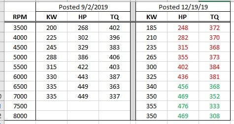

Originally Posted by bortous
Torque is also way up compared to before.
This is getting cringeworthy. I took the liberty of making a table to compare the results of the dyno graphs you posted so far. Below 6000rpm, you lost torque and horsepower.
If I were you, I would cut my losses and put all the old **** back on and load the old tune from back in August when you were making 505whp and didn't have oil pressure problems. Leave it alone until you find a "tuner" that can deliver the results you ask for. You've no doubt paid a lot of money just to lose 30whp.
This setup will pull hard with a 5500rpm (minimum) stall converter.
Bort, time for a single turbo kit. Go back to your hydraulic lifters. Too easy with a VT-VZ commodore, there's kits off the shelf and I even see on gumtree some customs kits come along in Melbourne quite often.
Personally I feel dumb for ever bothering gathering a bunch of expensive parts for a N/A setup because of our current aussie prices. There are single S480 turbo aluminum ls2's making 800+fwhp and don't break. Simple setups. Heads/cam/hydraulic. No need to change the block for that level. Several have even gone 8's in the 1/4 in light cars.
You will spend 20k here minimum on a new ls7 build and it will struggle to be 750fwhp. Single turbo what you already have (go back to the hydraulic lifters) and it will have more power/torque than you will want in a street car.
