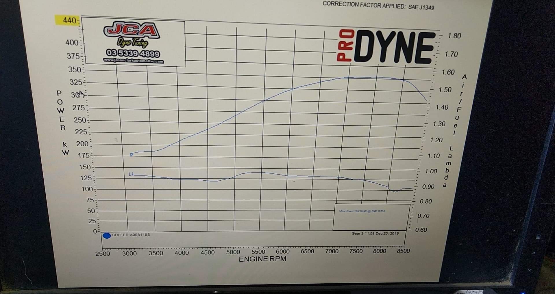

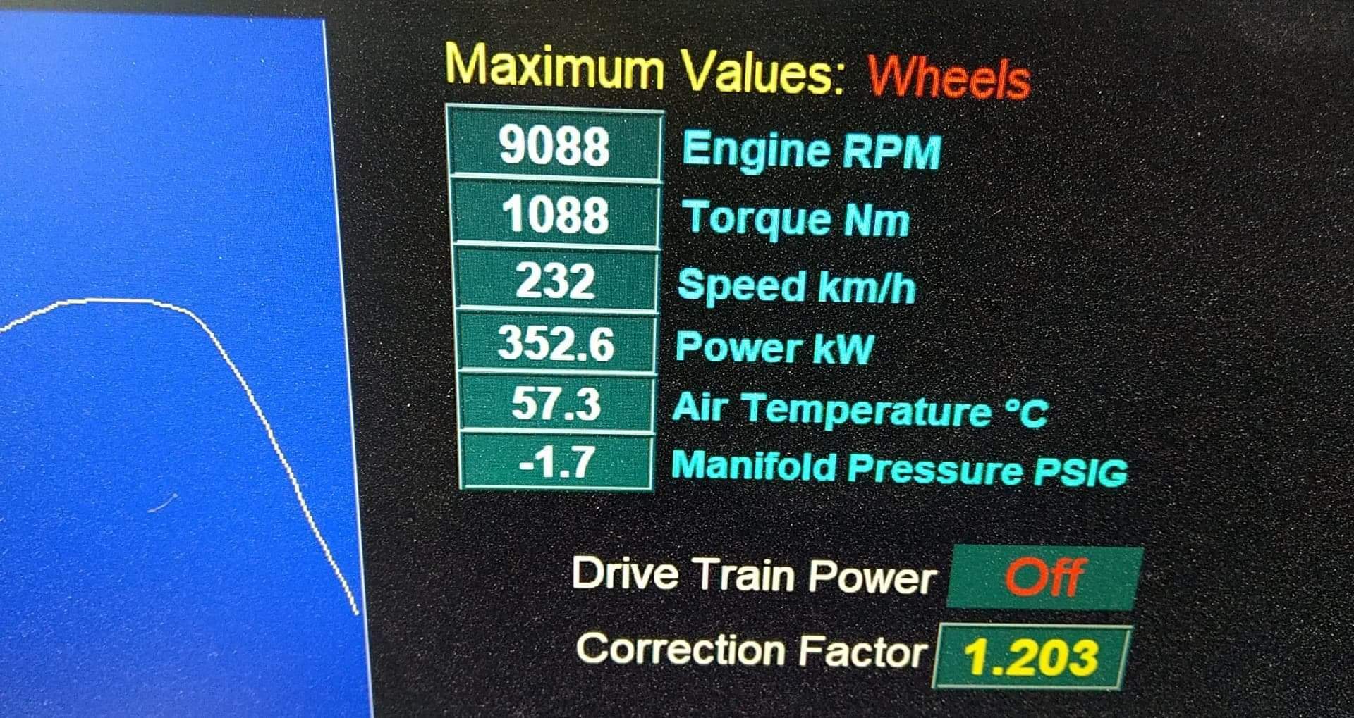

Guys, I finally have an update.
A more serious one.
Before I get started let me say I am somewhat happy with the results so far but pissed off at the same time.
Engine is working as it should except oil pressure is still lower than what it should be.
It's reading way too low.
I have a video and dyno sheets to post.
Firstly the good points:
The engine sounds unreal. Way more alive to any hydraulic setup I have ever had.
Valvetrain is very stable. Hp Peaks at about 7000rpm and holds that power all the way to 8200rpm before falling off which is insane.
Rpm limit is set at 7600rpm.
Torque is also way up compared to before.
Engine is making as much torque as it was before with the long runners which is great now that I have a shorter runners.
The bad:
Peak power is still only at 352rwkw same as before.
And the oil pressure switch was changed and the reading is still the same.
Pressure is only going to 30psi at max rpm so something is definitely wrong.
Because of new converter modifications and that fact that it's looser setup it's eating up more hp than before.
And also, this was tuned in extreme heat also.
It is 55 degrees C in the dyno room which equates to 130 degrees fahrenheit which certainly doesn't help things.
It is a scorcher out there today.
Please note, one of the dyno sheets is out by about 1000rpm and the torque figure is wrong.
Tuner is certain these lifters are the issue. He reckons because it's such a short lifter it's dropping past lifter oil feed holes.
Engine is going to have be pulled apart yet again to check.
If these are the issue I'm going to get my money back on them.
Does anyone know of an axle oiled solid lifter that is OE spec in it's dimensions?

Is that lambda correct?? He’s running it soooo lean!
Man really sorry for you. I hope you get this resolved quickly. I can’t imagine going through this honestly.
I got no idea if that is correct or not.
I know dyno is out somewhat but don't know if that will also affect Lambda reading.
He is going away for a few weeks over the christmas period so no updates till towards the end of next month.
This is the first time ever I have had an issue like this. Ever.
Over 10 years everything was so smooth sailing.
And now from no issues to this is something I wasn't expecting.

You need to get some money back on those lifters if you still can. Or remove the block and bronze bush the lifter bores and restrict the lifter galley holes, then you can run ANY solid lifter and your oil pressure will be back up.
It wouldn't surprise me if the outside diameter of the lifters is slightly smaller than OEM also.. making your oil pressure even worse. (aside from the other design flaw of them)
Guys you can't blame his tuner. Seems to me like he is doing the best he can. The lifters are junk. This should go over on YB forum where I was told I'm wrong (and that so was LG motorsports) countless times about the designs of some of these LS solid lifters being no good. If it's not the lifters all else it could be from a simple cam swap was your mechanic screwed up the cam thrust plate somehow and it's leaking oil. Which is highly unlikely. It would need to be put on backwards (which it can't if gen4 style as counter sunk bolts) or he forgot to tighten it. Again, highly unlikely.
As for the dyno figure, Melbourne today was 44 degrees celcius (111F for the 'mericans). On a cold day you will no doubt be up. And not to forget the new converter lost some. So given those facts I think the power is there..... but you need to sort out the lifters and have proper oil pressure again or your rod bearings will not last.
