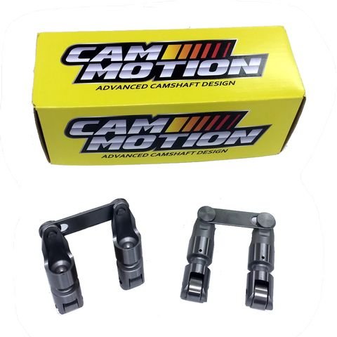

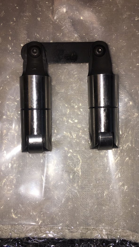

Not so sure it's the center portion of the lifters being narrowed. The stock lifters are narrowed. Unless you mean the part of the lifter body that is not narrowed is too narrow.... Here is a shot of the lifters I just pulled from my engine that ran with 50+ psi warm idle:
They do not have the axle oiling feature, but they never let me down. I replaced them with these since I was going to crazy uber lift cam specs:
Was not sure which post to bump for the reply, but as promised - oil pressure on the new lifters. Axle oiled, tall body, cam motion premium lifters, 70 psi cold start. Did not let it run very long, but guarantee it will be over 45 warm idle.
So you are saying that those premium racing lifters from cam motion you have are working as they should with the right pressure.
Lifter bores are stock too correct?
Correct and correct.

Can you post a side-by-side photo of the old problematic lifters with your new lifters for comparison?
Old Jan 17, 2020 | 07:37 AM
  #859
Darth_V8r's Avatar
Moderator
Joined: Jul 2014
Posts: 10,451
Likes: 1,873
I think his suspect lifters are still in the engine
Old Jan 17, 2020 | 07:57 AM
  #860
bortous's Avatar
Joined: Sep 2010
Posts: 2,898
Likes: 467
Will do that once they are out of the engine.
