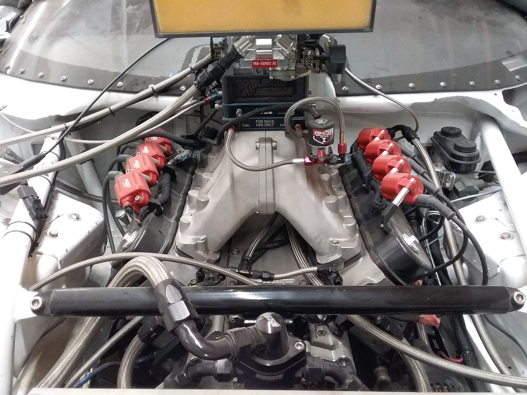

Just a little intake **** to look at, to get you motivated. Lol

That looks sick Mr T.

Thank You. Runs pretty good too.
