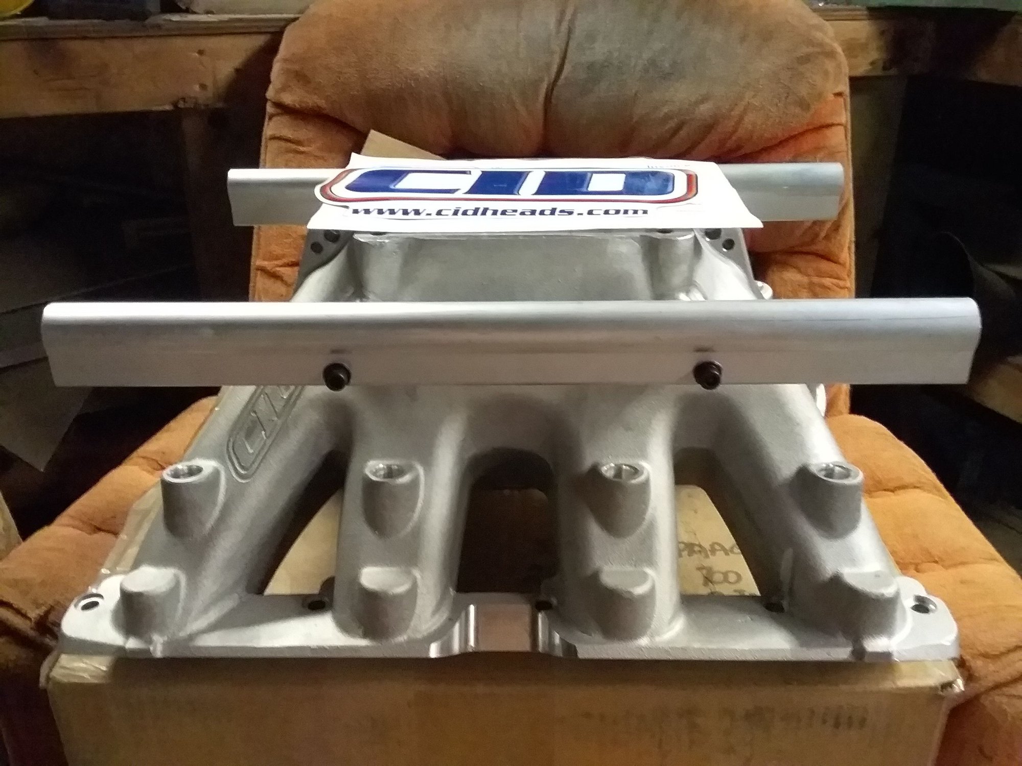

It will be sitting here waiting for you. Tease, Tease. Thought I had a picture of it. Dam it. Lol
Picture coming soon!!!
