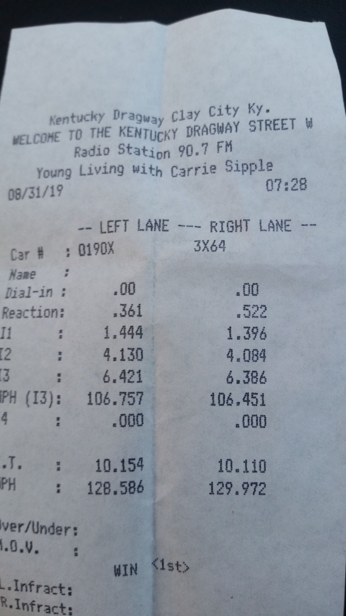

That's me in the right lane. Yes i know the reaction time sucked. They were using a pro tree last night and I've never been on one before.

Depending...some may see a great mph but lack luster....et. What does this Say?
Simple if thought over. 5 sec 1/8 with a 376ls3 and a ....i'd say 2890 stang hyd roller....nothing Special...Great 60 time = race is or et was attained.
The 60ft and 1/8 ...this is when Matching parts Comes into play for a ET ....
Kilers lay withing the 60ft vs a similar build na, fi .....if i'm out you gone if similar in build nature Na vs Na with a lesser build. Camaro with a 416 or 408tfs heads goes 9's how? Ask Tuskey 4 sizes...
60 ft! Around the same weight if not more. Matched Combination?

It will get faster. 1) Line lock isn't working so i'm not getting enough heat in the tires which hurts my 60'. 2) It's a new set up and I'm basically starting all over with my suspension dial in. 3) Humidity was in the high 90's.One thing for sure is that I will keep chipping away at it.
