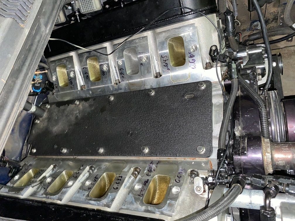

Well, I'm finally past all the life event stuff and got to pull the intake off. Short summary of life activities -- another daughter married off, helped one that was already married move accross country, find a house, and they are about a week away from having our second grandchild. yeah I'm old, my company decided to build a new factory which I'm part of the design and commissioning team. All of that is honestly just excuses though. It was kind of a punch int he dick to have to tear the heads off, and I just didn't feel like it for a while, so I went through a bit of a funk. Out of it now. So, the intake came off, and...
One of these things doesn't look like the other ones....

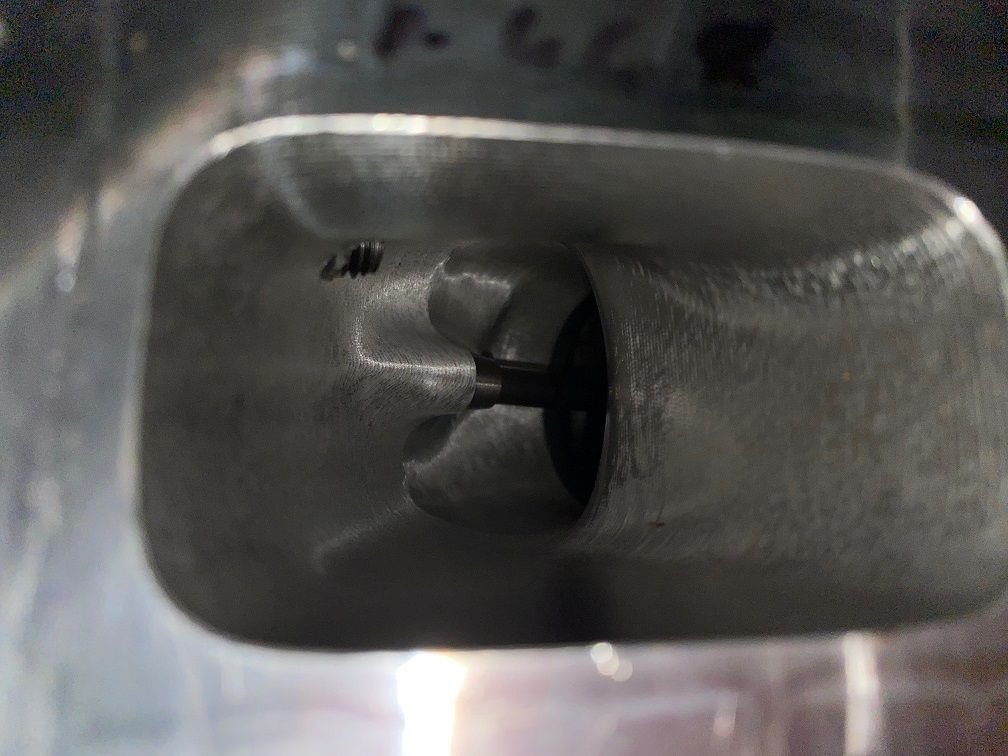

I was completely unexpected, but the #3 plug that was fouling has a perfectly clean port while the others looked varnished. I puzzled over this until I felt around inside the port, and it was completely oil soaked. Basically, the oil is so new that it is transparent. but the coating is heavy enough that it prevented varnish from sticking. But the other ports varnished up and felt bone dry. There was no oil inside the intake manifold.
Here you can clearly see the hole in the runner. The discoloration surrounding it I think is the epoxy patch I did, and it didn't hold. Another thing I notices is that oil drip kind of hanging onto the bottom of the rocker boss. So I do need to go back and do a better job sealing the rocker bolts.
