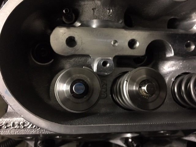

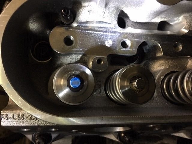

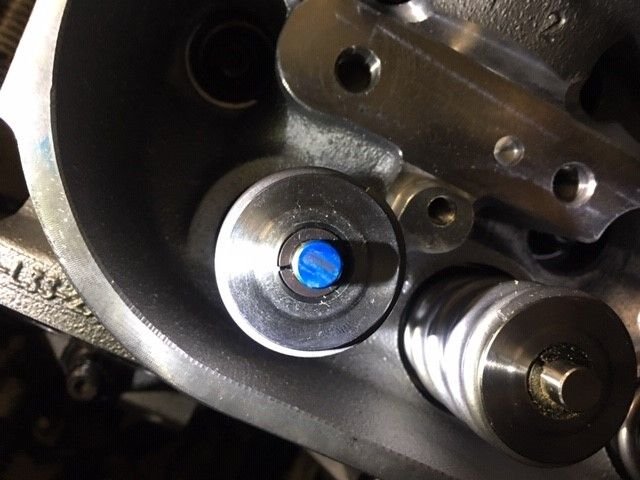

On to rocker geometry. The YT kit I got is very well thought out and very complete. For reference, on the 346 build I ran the YT 1.7's, and they were non-adjustable. The kit came with 0.0625 shims, but 0.125" shim gave the best wipe pattern, so I had to go to Lowes with a set of calipers and sift through their washer drawers to find 16 washers at 0.125", etc, etc. If anyone reading this thread read the other thread, maybe this will spark a memory.
By way of comparison, this kit is adjustable, has thicker pedestal bases, and comes with 0.040 shims. On the wipe, the narrowest and best centered was with the pedestals shimmed 0.040. It was nearly perfect. Very very happy with how this came out. Also, the 10mm bolt upgrade is so very worth it. Especially if you plan to run lift like I am. The rockers feel very rigid in place. much more so than the stock rocker system I pulled off the old heads. They are a bit heavier over the nose so you need to spring to compensate. I'm looking forward to seeing how well these Manley Nextek's do in the running engine.
No shim, the pattern is very wide and biased to the intake side.
With the 040 shim, the wipe is centered and narrower than the other two. It is still wider than my 346 set up was, but I'm running 0.100 more lift! That will automatically make for a wider wipe.
080 shim. Wipe pattern is to the exhaust side and very wide. VERY wide.
Having set the wipe, I went ahead and measured for pushrods. Now, I don't have the HG yet, so I used the ARP washers as 0.1225" shims (not a typo, they measured 0.1225") under the head. Since my HG is 0.042", I simply subtracted 0.080 from my measured pushrod to get the final length. I was hoping to be able to use the old ones, but they are too long by 0.300". I measured 8.160" on the intake side and 8.120" on the exhaust side. Now, since these are adjustable, I didn't bother measuring all of them. There's 0.100" travel in the adjusters either direction. Since I am unlikely to use up even 0.030 of that, it should be a quick setup. I plan to set up with 0.002" lash to really take advantage of ramp rates and slightly improve intake manifold vacuum.
There's that update. Over the weekend, i'll start reassembly as much as possible.

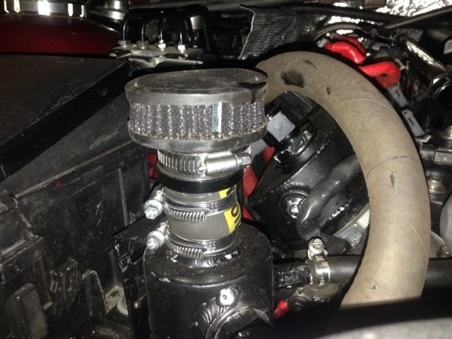

Will you be running a vacuum pump or catch can?
I bought a one way check valve breather from UPR, a pcv valve , cheap catch can. Stuffed the can with stainless steel wire, Put one way breather on top, ,Threaded pcv valve into can and ran a dash 10 pipe from pcv valve to intake manifold, dash 18 pipe from oil fill on valve cover to can , dirty side and a dash 10 from cold air intake to valve cover ,clean side. Works great, under normal driving the cans under slight vacuum , and when i get into it the breather opens to atmosphere.. I checked can once and it had collected maybe a 1/4 inch water, no oil.

Vacuum pump. That's what's weird. I ran a vacuum pump on this motor before teardown, and I know I'm getting good vacuum. At first I didn't have it connected, and maybe that's where all the oil came from. Not much could have come from the chambers, the ports are far too clean for that. I have no hoses going from valve cover to intake manifold, though...
Old Dec 12, 2019 | 09:13 AM
  #335
Mickyinks's Avatar
Joined: Sep 2019
Posts: 818
Likes: 261
From: Melbourne, Australia
I thought about getting a vacuum pump, had heard there not ideal for street usage. I do 20min runs on road courses also and was unsure if the pumps like that.
Think thats old hat know with the newer designed pumps.
I took the intake off last week to put heat shielding under it . Checked the inside and it didnt have any oil film at all so the cans doing its job.
