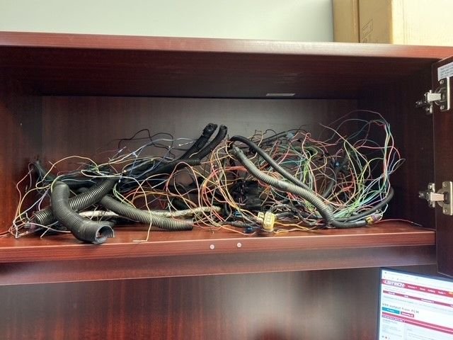

Got the stock harness 90% done for the holley conversion. If this works, I'll be using the stock ECU to run the fuel pump, starter, fans, all gauges, reverse lock out solenoid, reverse lights, Evap purge, and interface with the other factory systems. I gave myself a few extra pink pigtails in case I need to grab an additional ignition feed for anything. I still need to loom it, but I'm pretty happy with the product so far:
Here is all the engine control garbage I took out of the harness. It's a pain due to everything being so tightly braided together, but once you get past that and start working it, it isn't so bad. Just gotta take your time.
