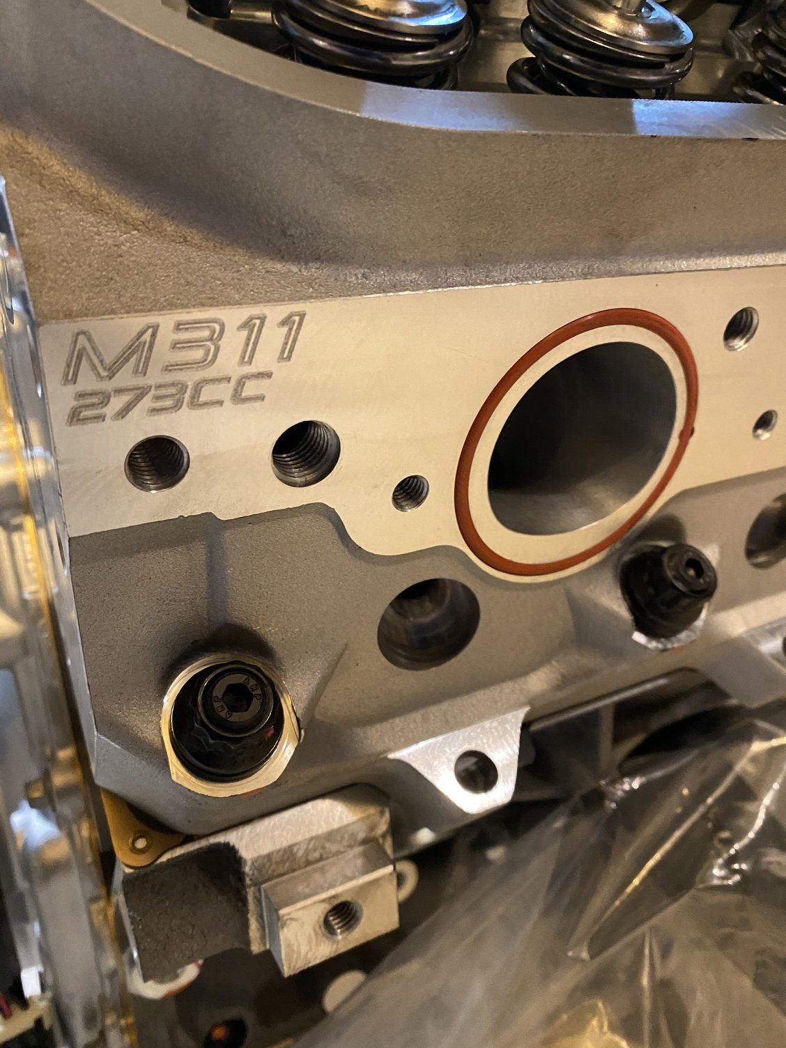

Starting a new build on my vette. I cut my oil filter open and it was full of pretty shiny things. The poor girl died from lifter failure. I ordered a new forged short block from Thompson Motorsports yesterday and will order the long block completion parts from them in the next couple days after I figure out the cam specs.
Blue printed New LS3 aluminum block
ACL coated racing bearings
K1 forged crankshaft
4.000" Manley H-Heavy 4340 forged connecting rods with ARP 2000 rod bolts
Diamond or Wiseco pistons with GFX file fit rings
ARP Main Studs
Frankenstein Thompson Edition M311 11* CNC 6 bolt heads
Extreme duty stainless intake and extreme duty solid exhaust valves
Billet Rocker Rails
.660 springs
3/8 pushrods
ARP Head Studs
Melling Select High pressure oil pump
Billet adjustable timing set
Johnson 2116LSR Lifters
Trunion Upgraded Rockers
GM MLS head gaskets
GM MLS head gaskets
Cam is still TBD

See they got the 11 degree heads out .....was told about them a few months ago as a cheaper version of the F series heads. Looks and sounds like Liberty castings. Best wishes..

Yes they brought back the MAST Black Label clone castings made overseas for a budget friendly builder, no where near what an F Series can produce but have a few customers making some great numbers for a $2400 set of heads

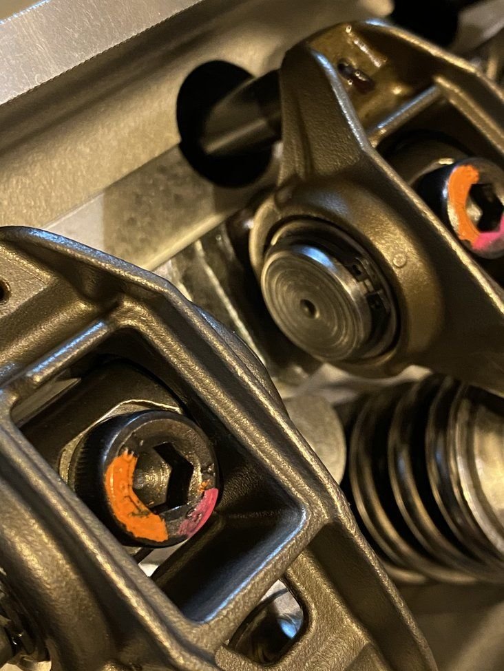

I picked it up a few weeks ago! just haven't had time to do the install.

I also added an Improved Racing Crank Scraper and windage tray. Those are some real nice pieces of CNC jewelry that I hope I will never get to see again.
