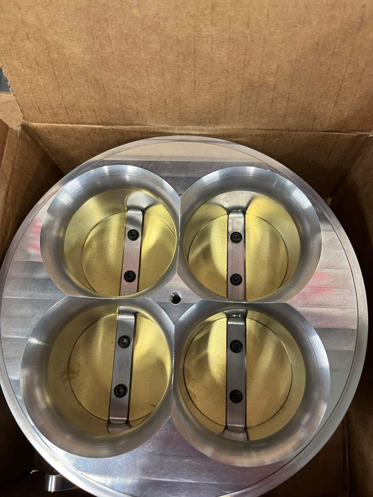

Accufab 6500 TB is in, will match the shiny CID intake

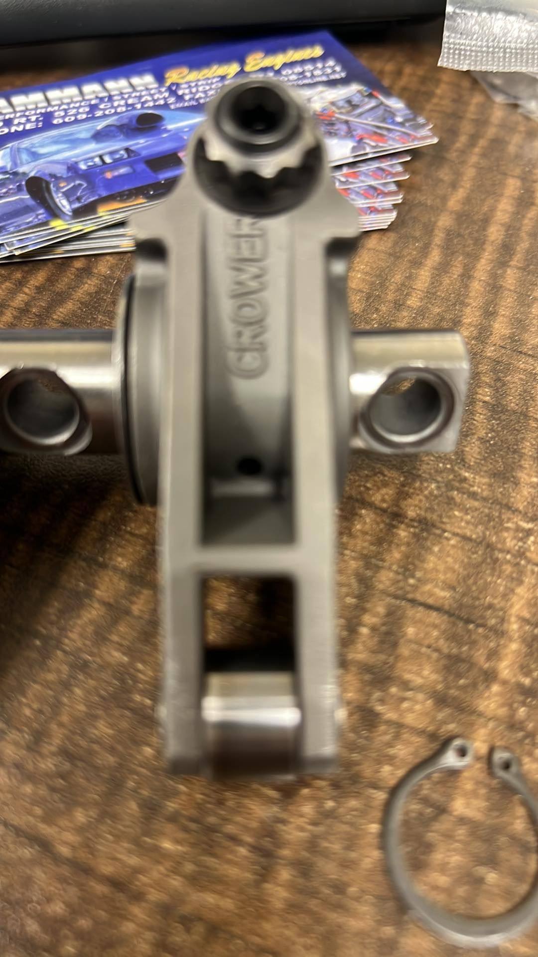

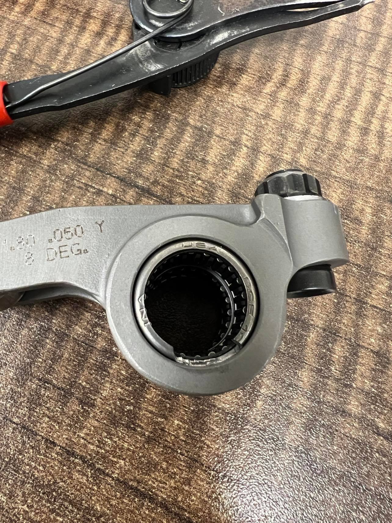

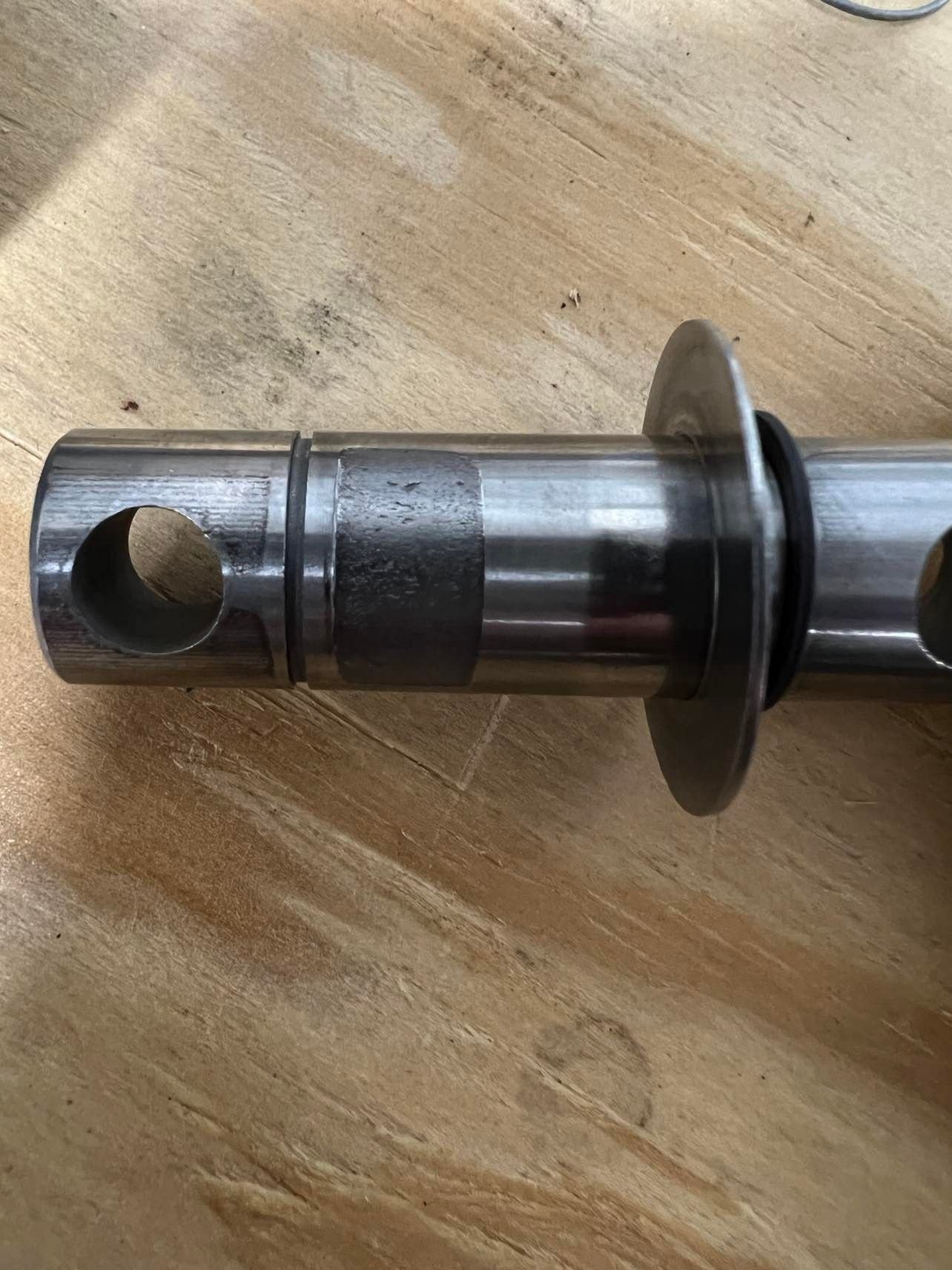

Just because your car seems to be running fine doesn't mean all is ok. While waiting on the heads and intake from FED, my engine builder is inspecting everything and found some issues in the rockers. Not sure if it could have been prevented with more frequent oil changes or this is what happens with 5k+ miles on a solid roller. At least she'll be all fixed up! Will need 3 shafts and 6 bearings.

Looks like you found the weak link there.
What oil were you running, and what drain interval ?
Are you going to replace with bronze bushings, or take your chances with more ROLLERS ?

From the pics, it looks like the shaft surface hardening failed, as the needle bearings are still in place. I’d consult Crower and find out if excessive spring pressure contributed to this, or was it just a random failure. 5k street miles with a solid roller is nothing these days. Thanks for posting.
Agreed. 5k miles in my day was nothing, either: back the springs off on Sunday, adjust valves before going back out on Friday. Replace the springs every 2500 miles or so, depending on street driving. The cam grinds and spring tech is waaaay better than 15-20 years ago.
I'd let Crower take care of that issue.

Holy ****! Have never seen that on a Crower set-up. Bamman is a 5 builder, I would have him at least take a glance at the rocker alignment on the head. That's some crazy wear, solid roller or not. Oil didn't cause that, it's geometry or specific failure like what Chev70elle is saying.
